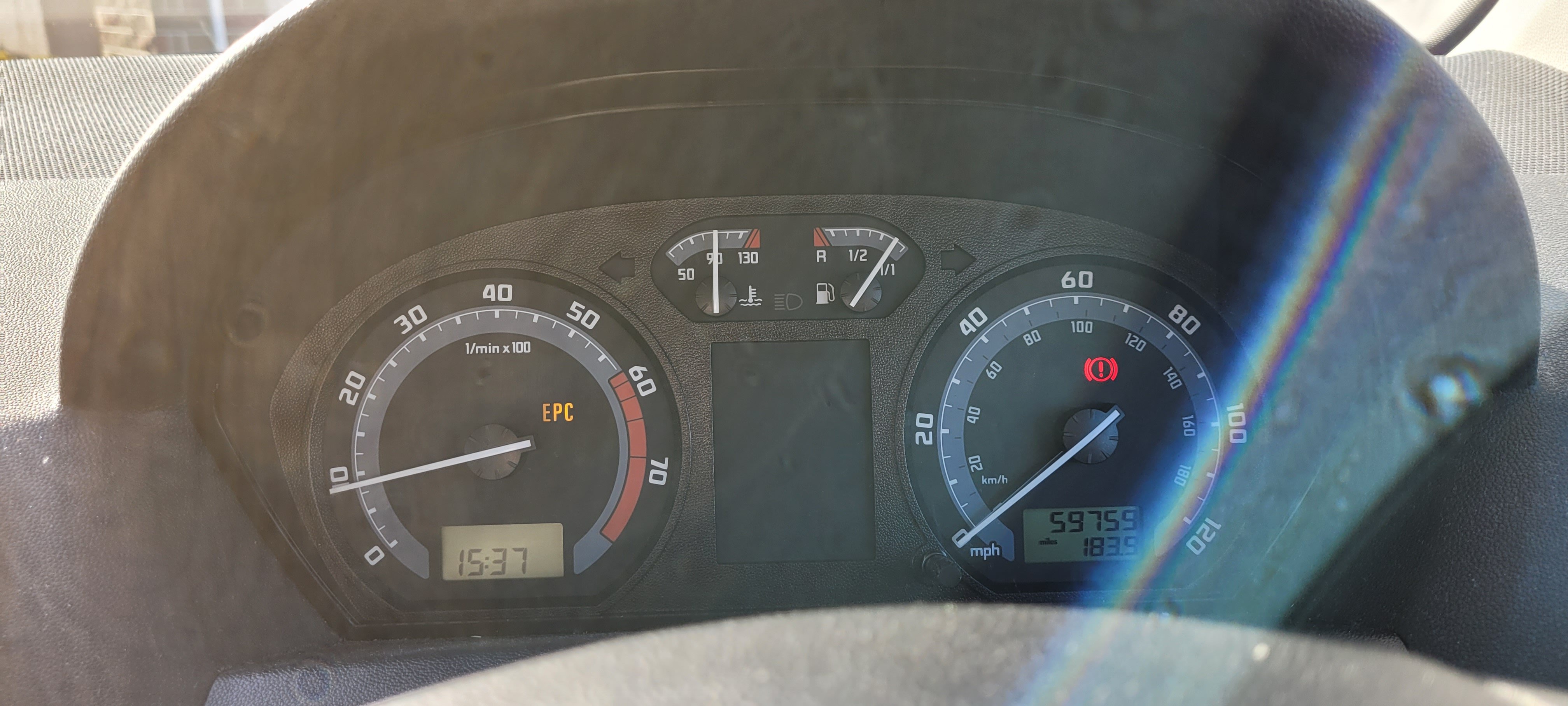

The EPC light is on permanently. When driving about it just goes to switch itself off and doesn't allow for acceleration etc. Two code readers were tried (one worked earlier but found no codes before the light came on) but now both say the same "LINK ERROR!" message all the time, not allowing me to connect to the car.
Any help is appreciated.
Edited by AnnoyingPentium
Tried the pair of code readers on my Grampa's Insignia and they both work fine. Just not with the Fabia.
