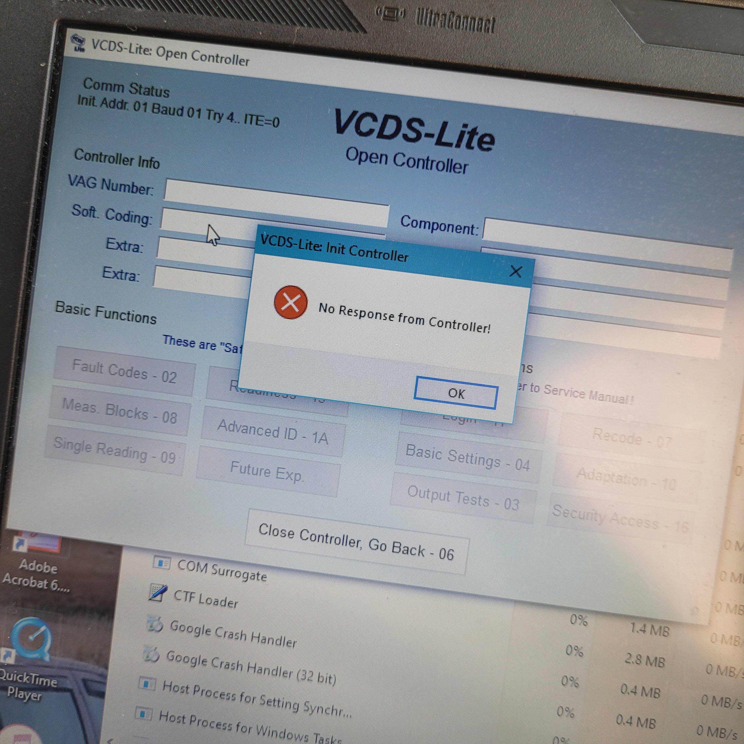

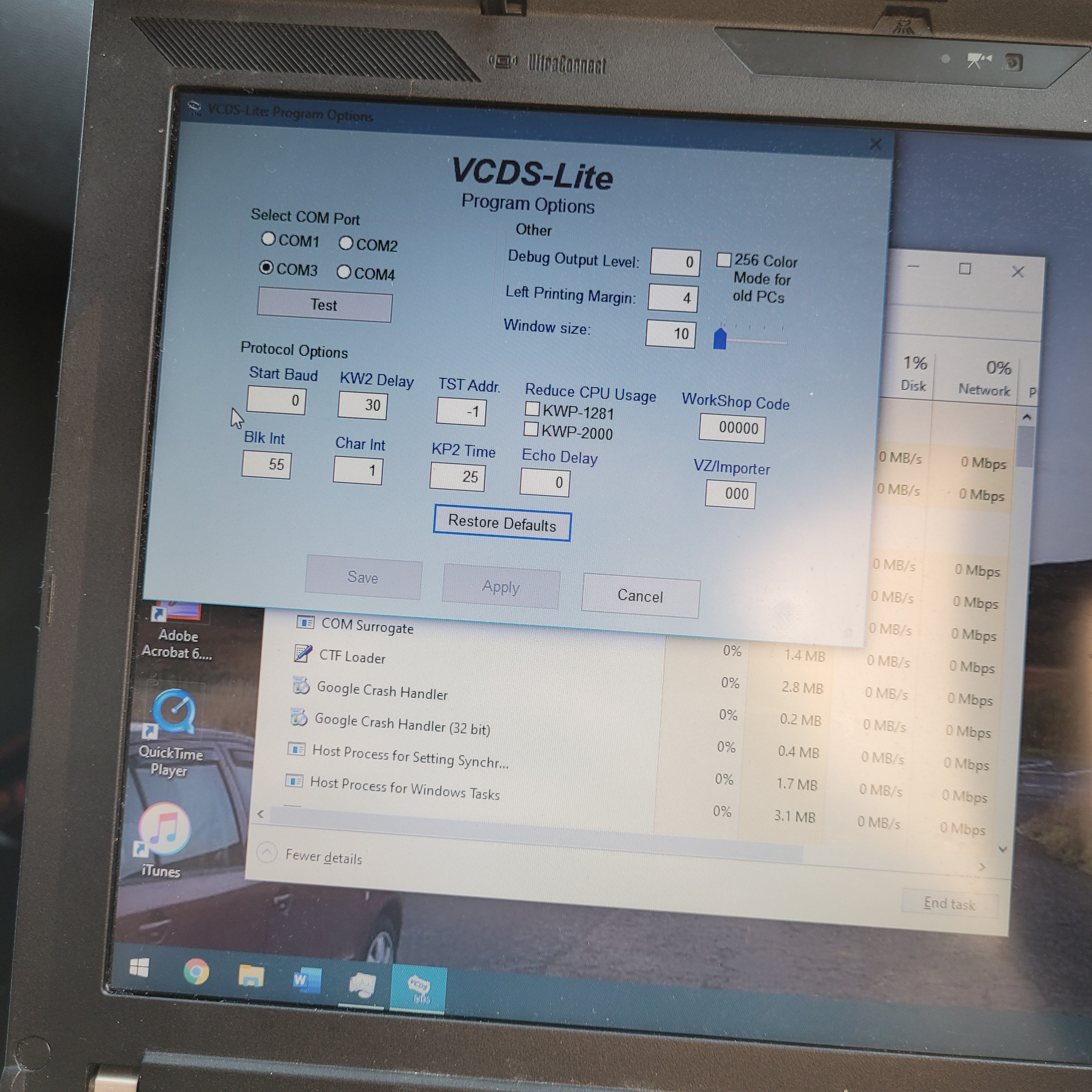

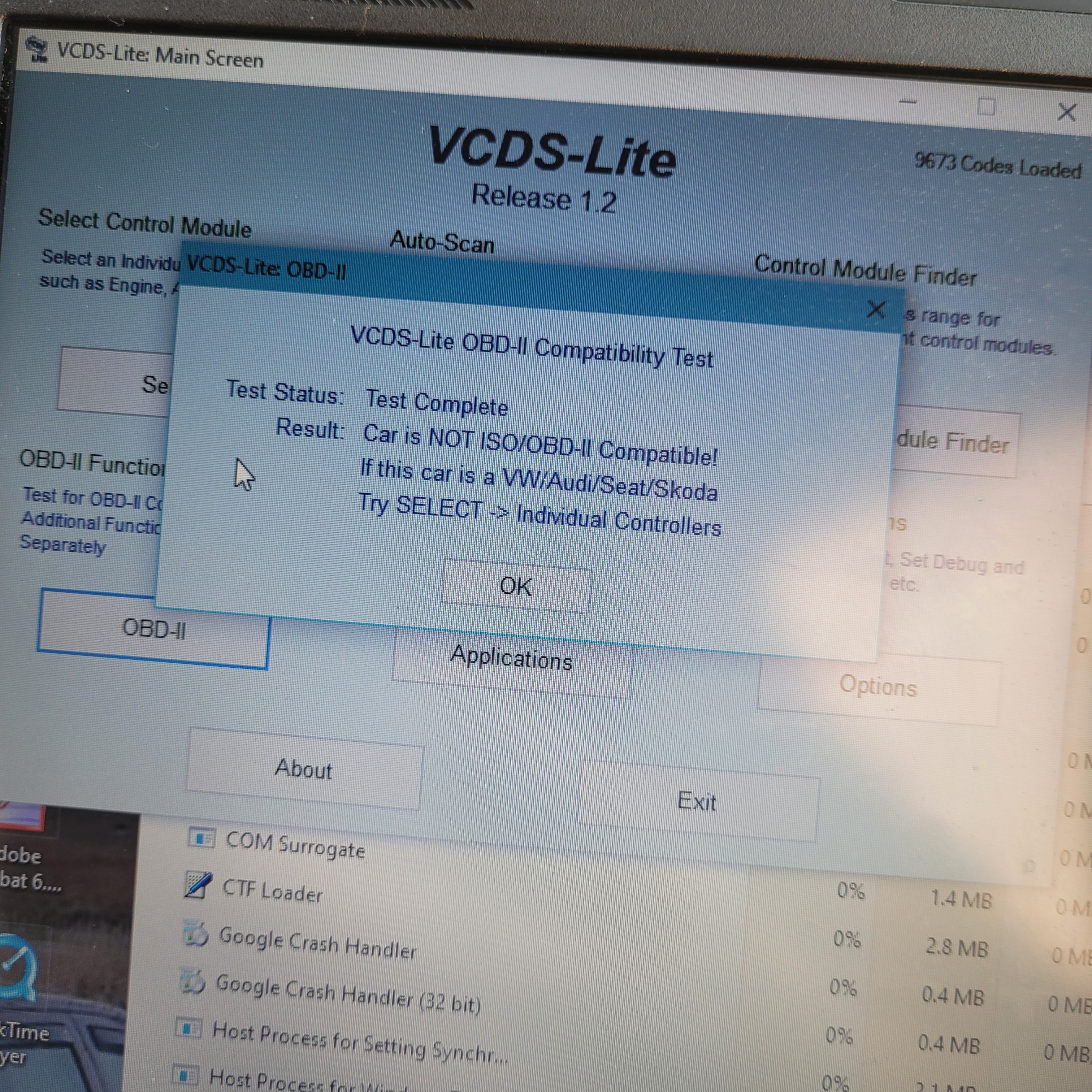

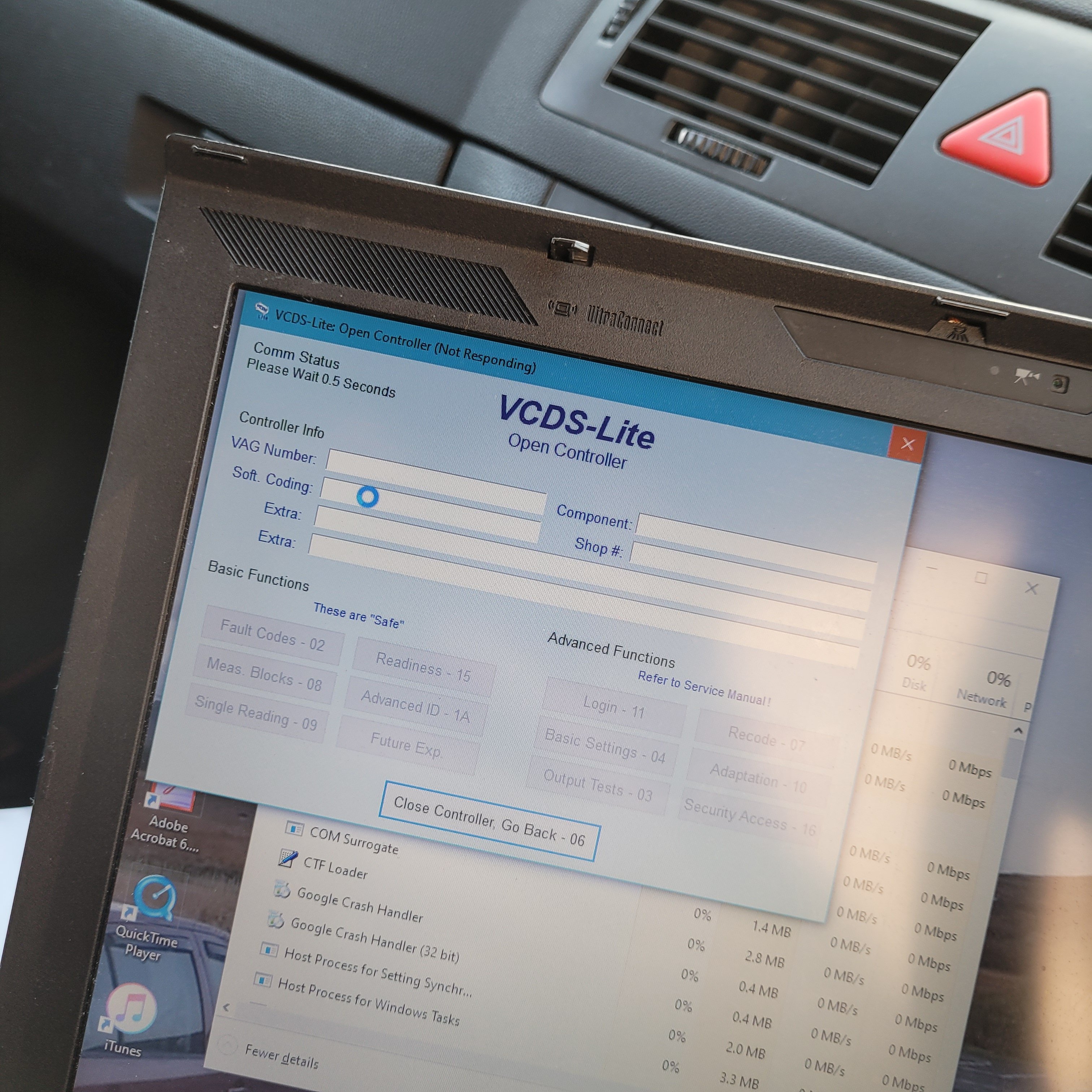

My VAG-COM interface cable has arrived from Gendan and is recognised by VCDS-Lite but keeps either locking up the software or doesn't see the car.
Was trying to run a scan on the engine control module here:
I also need to know which settings I need? Interface was enabled on COM port 3 but I don't know if baud etc. is correct.

Once you have selected the correct Com port, click the "Test" it should then come back with the details of the interface lead, then click the "Apply" & "Save" buttons and it should then connect to the individual modules as required
Thanks, thought I had tried that, but will try again tomorrow when I have more time. :)

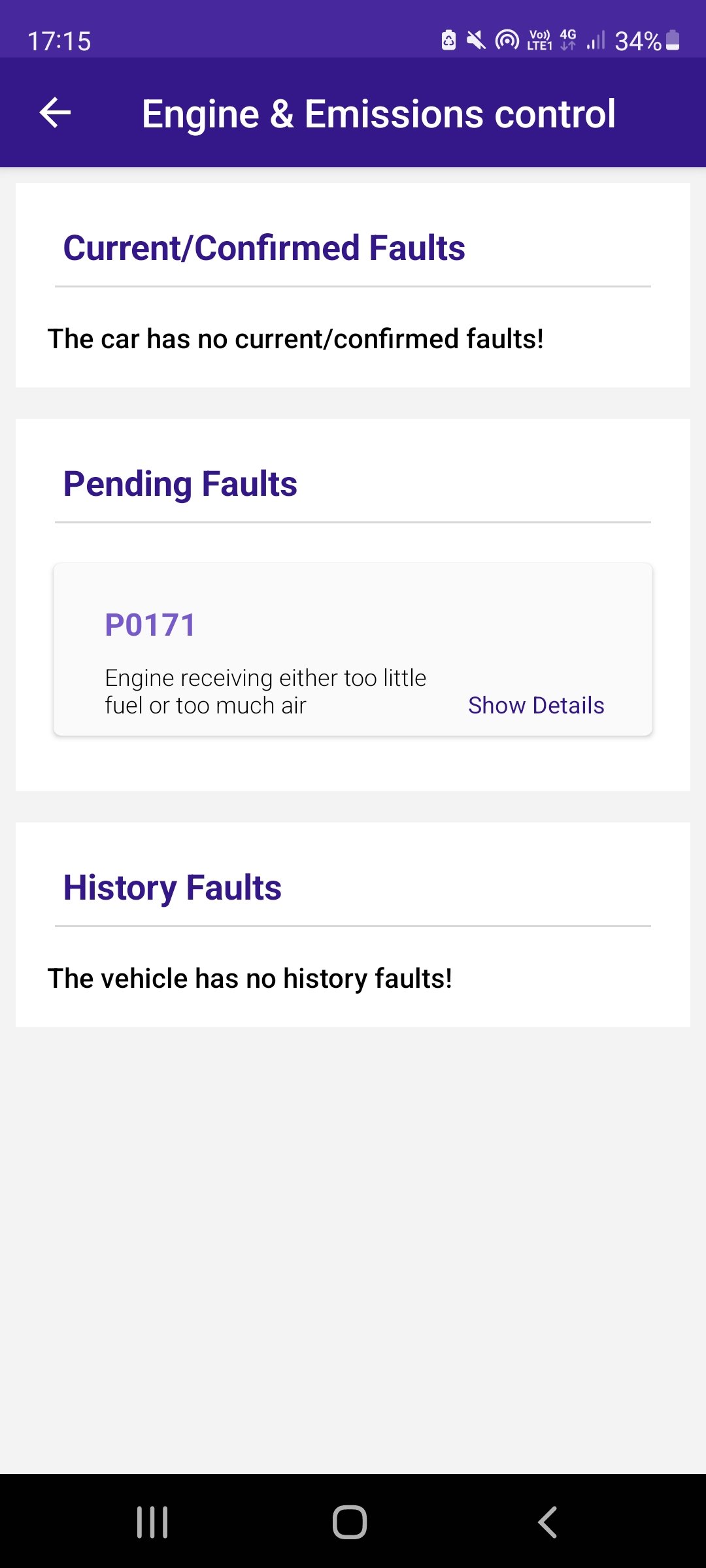

3 hours ago, AnnoyingPentium said:
Also had a Bluetooth OBD thing arrive. Gave it a shot and...
717251329_Screenshot_20220323-171521_GaragePro.thumb.jpg.3daf25c95d4001c8fb555884c0305c0d.jpg
  Persevere with the VCDS which is basically dealer level - abate in a Lite version that you are using. Nige is correct with his method, but I have never been required to chose the COM port so assume VCDS allocates this. What is the software you are using with the OBD2, and is the adaptor bluetooth as I would still push Torque, only based on personal experience, which can also report error codes, but is not based on VAG architecture being generic like many. I have never seen a "Pending Faults" message, being basically VCDS and Torque reliant. What does "Show Details" reveal?

Using an app called 'Garage Pro' that I found on Google Play. The adaptor is indeed bluetooth, it was the cheapest ****e I could get off eBay and it seems to work. The "Pending Faults" bit just provides details of potential causes of the fault/error thingy. I don't know if it came to the conclusion of a P0171 as a result of something not being quite to spec to the reader or something.

Pending means it's seen something (intermittent) but not enough yet to say it's a fault rather than just a mishap.
I have the full Hex-V2 and that just gives "USB" but it's the computer/laptop device manager that allocates the Com port # not VCDS

I spoke too soon, started being a stroppy wee sod on Saturday when we went out to Auchinleck. It never moved yesterday, and when started this morning took a wee bit of encouragement as it tried to conk out again and required some effort to keep turning over. Also threatened to cut the power with the revs dipping at idle when I drove round to my Granny's (about a mile) to take her bins out. I'll go back out with the code reader(s) tomorrow and pull some 'live' information hopefully. Might tinker about with the VCDS-Lite on the spare craptop computer as well, see where I get with that.

Also had no luck with getting VCDS-Lite to work. Tempted to consult the owners map and get a hold of someone local to do some checking/diagnostics. That Garage Pro app I was using has brought back the "pending" P0171 code as well but I've had no EML/EPC light... besides in a dream last night. :D

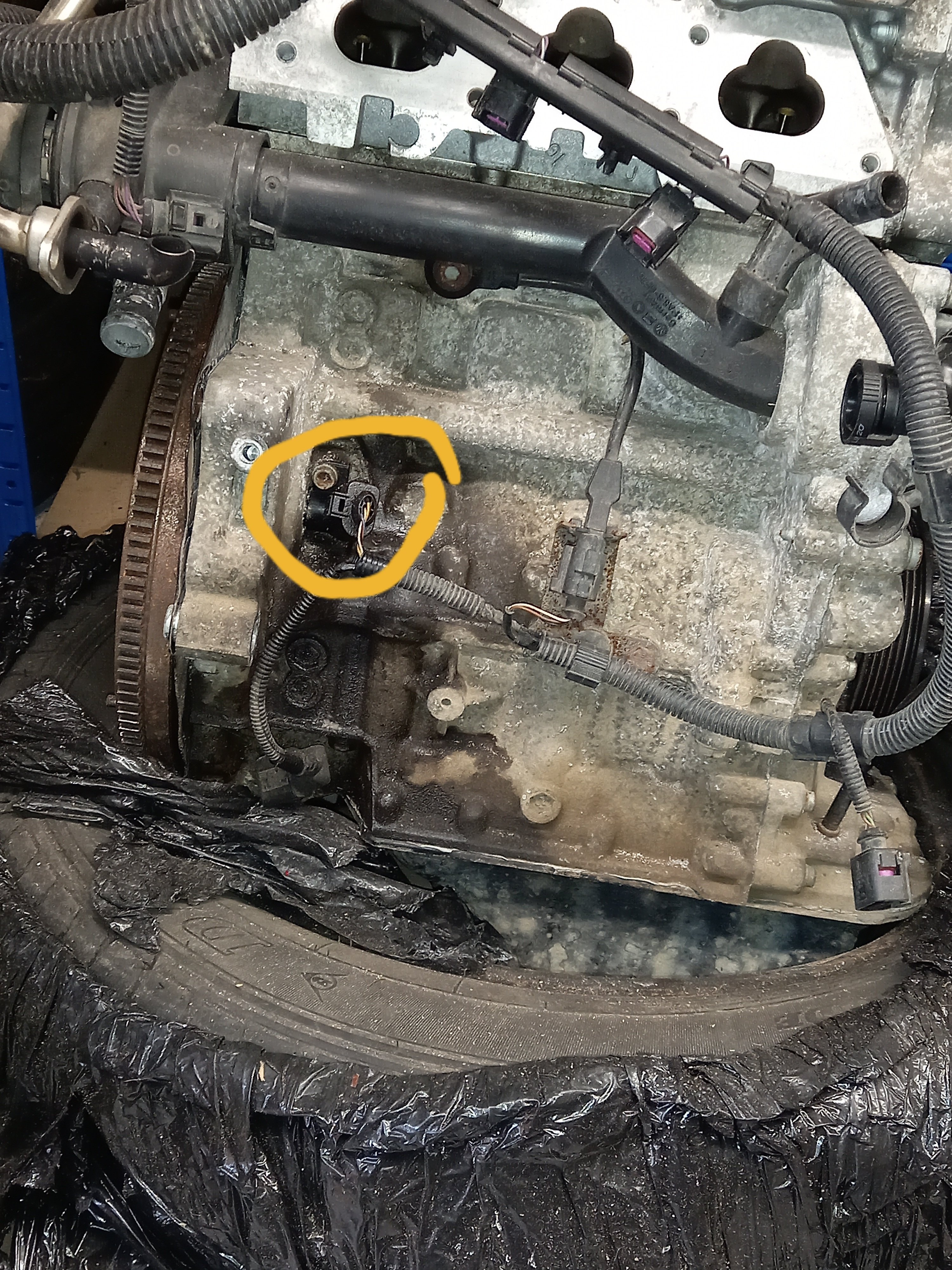

I could send you a crank sensor to try, but you'll probably need help swapping it in, access is grim.
I'd appreciate that. Thanks, Pete. Where abouts is the crank sensor located anyway, I can give my local independent a ring and see if he'll fit it if it's a pig of a job. :)
  • Sponsor
Back of the block, pointing at the inside face of the flywheel. It's only a guess that it might be iffy though.

Not really visible from anywhere but below when the engine is in the bay.  You can probably touch it though, blind.
