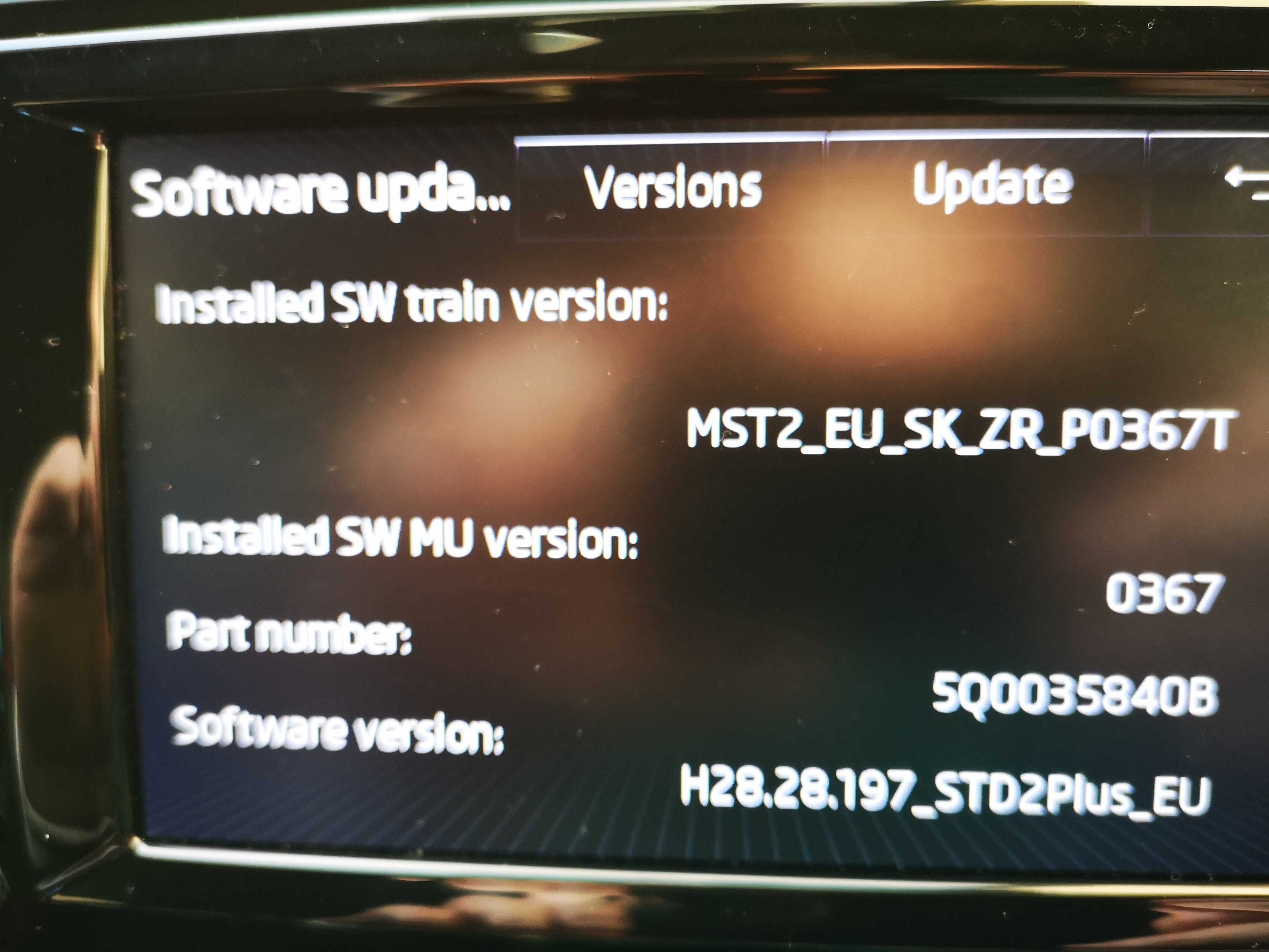

While I seem to have Smart link on my infotainment, I cannot seem to get it connected to my Huawei P20 smart device. See update details attached. When I plug in the USB cable the phone activates charging but the Apple Car Play and AA are all greyed out. I am very confused as to why it is not connecting and I would like to note that I have actually searched these forums and google in general and can rule out many issues such as debugging etc. I can see online that my system is the MIB2 Bolero.
Any idea why the functions are greyed out? I don't have NAV on mine so I wanted to use my Android phone with Smart Link 😕

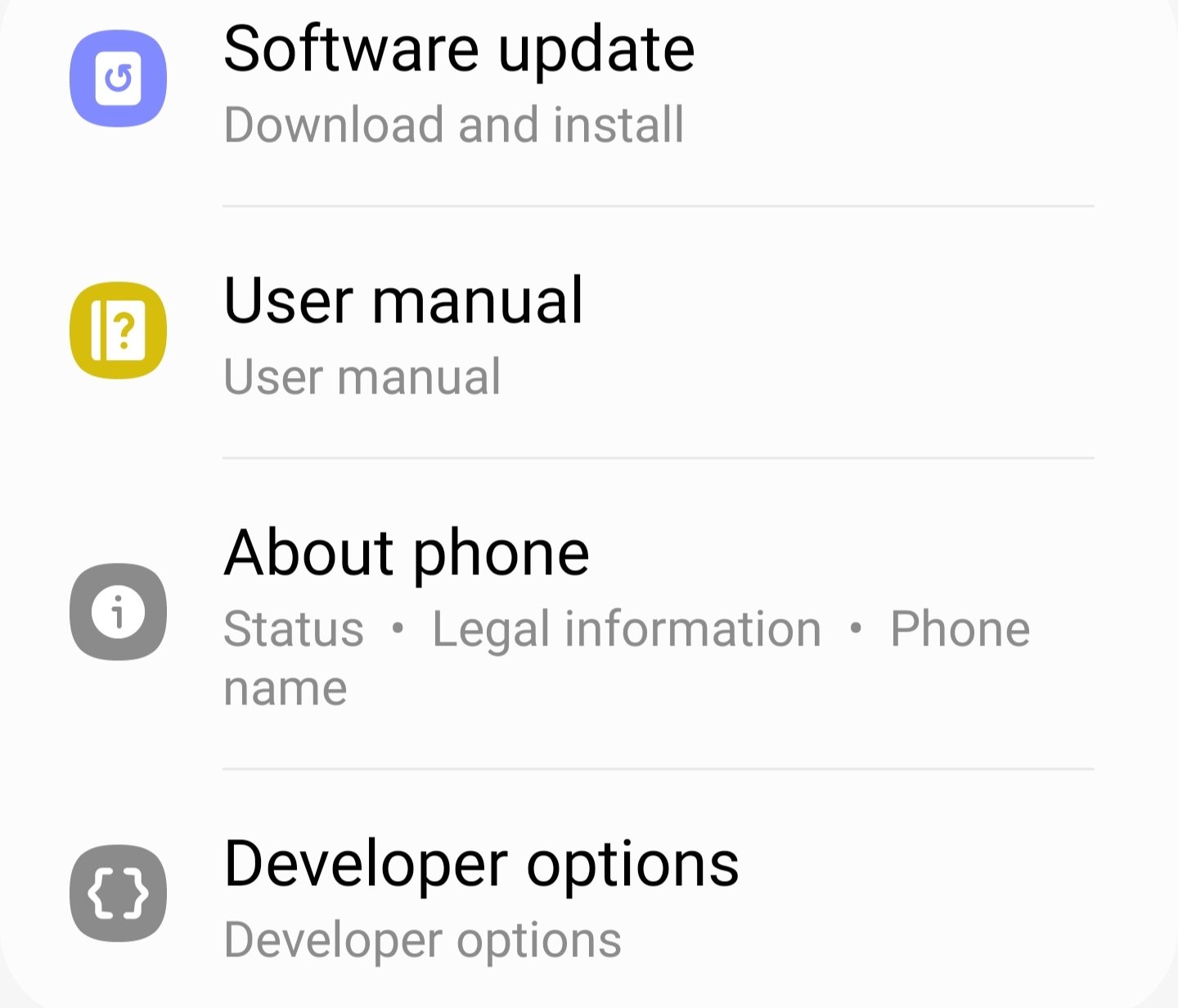

As it's an Android device, have a look in tethering settings, another way to access USB settings is to activate developer mode in settings.
To activate it.
Settings ➡️ About phone ➡️ Software Information ➡️ Build Number.
Tap Build Number between 5-7 times, if you have done it correctly the phone will show a small dialogue box, saying Developer Mode is active.
So now when you go into the settings menu right down at the bottom you'll find Developer options. Screenshot_20220319-211939_Settings.thumb.jpg.931fb706c0d4714ed28de43b3db004e6.jpg
In there, there are a couple of USB options, only tinker with settings in here if you know what you're doing. 😉
Wanderer, I think you might have sorted me mate! I activated and went into Developer mode and there is an option to select USB configuration and in that it was set to CHARGE ONLY.
There is media transfer protocol there so I'll try that tomorow. Hopefully that does the trick.
