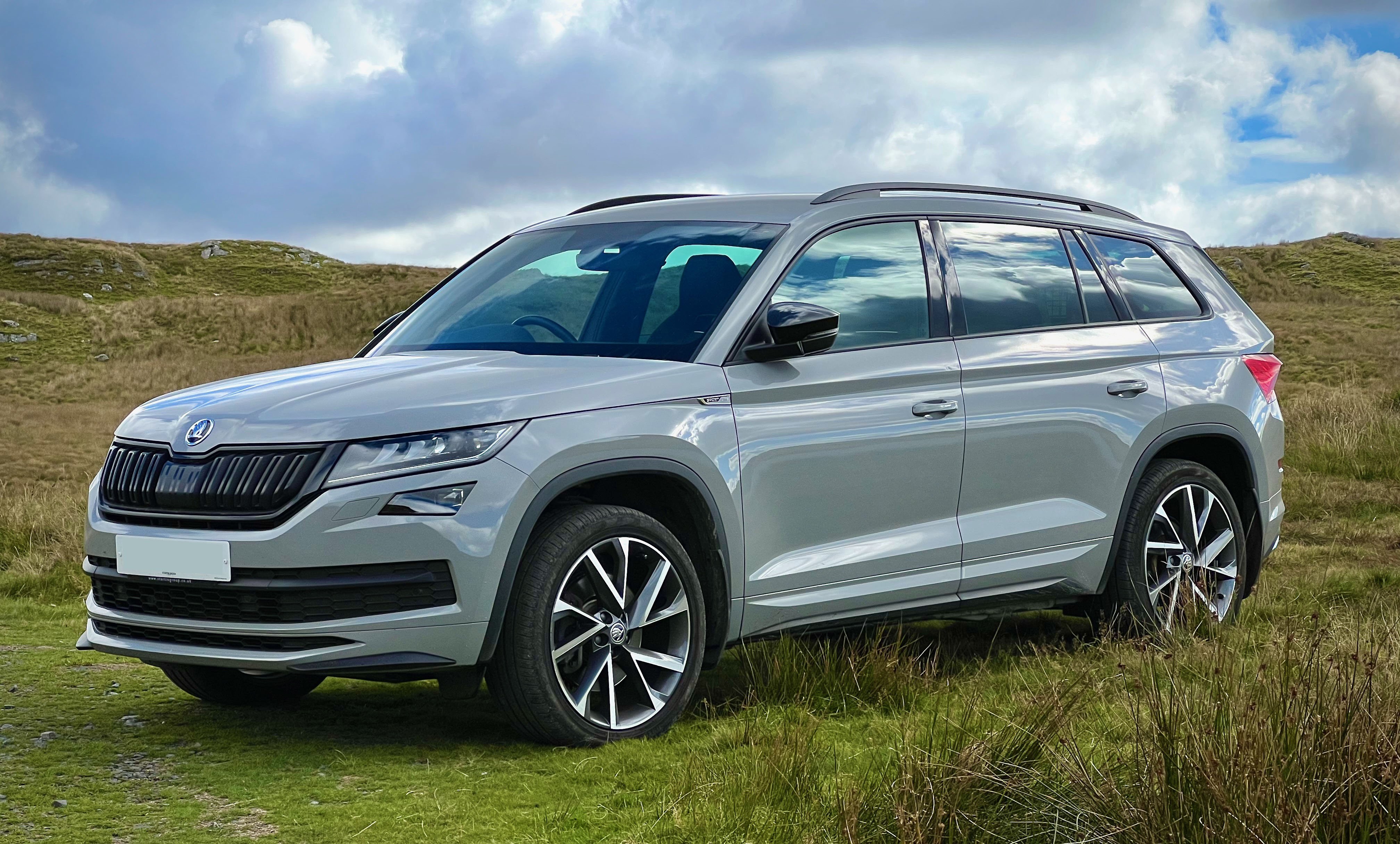

So, we just spent a week in the hills and mountains of mid Wales.  Beautiful area and well worth a visit - but not in a 2L diesel Kodiaq with DSG. The car was always hunting for the right gear, or refused to change down on up hill sections most times (just struggled in whatever gear it decided to be in unless I mashed the peddle to force a kick down) and then many times refused to change down to give some engine braking on the way down. Does it even know the attitude the car is in to inform it to drop a gear where starting up hill or going down hill? Even at junctions where speed was of the essence due to visibility it struggled to accelerate off the line making us feel very vulnerable. Overall a totally irritating and uncomfortable experience - even my daughter sat in the rear started asking if the car would ever change up or down a gear as it was so noticeable!
Not convinced this is a DSG or Kodiaq trait so will be asking my dealer to reset the gearbox using their kit and check it over. Needless to say they I am sure will say they can't find a fault... if they say 'they are all like this / its a trip of the car' I'll get grumpy with them! Maybe I will also take a similar aged and engined car out for a long test to see if it's the same?
Love the car, it ticks all the right boxes for us for practicality, size, looks and usability on A roads and motorways - hate the damn DSG gearbox on twisty/hilly B roads and single track mountain roads. Other auto's I've had rarely if ever irritated so much!
*rant mode off and relax*
Anyway... it looks pretty on the hill side at least
