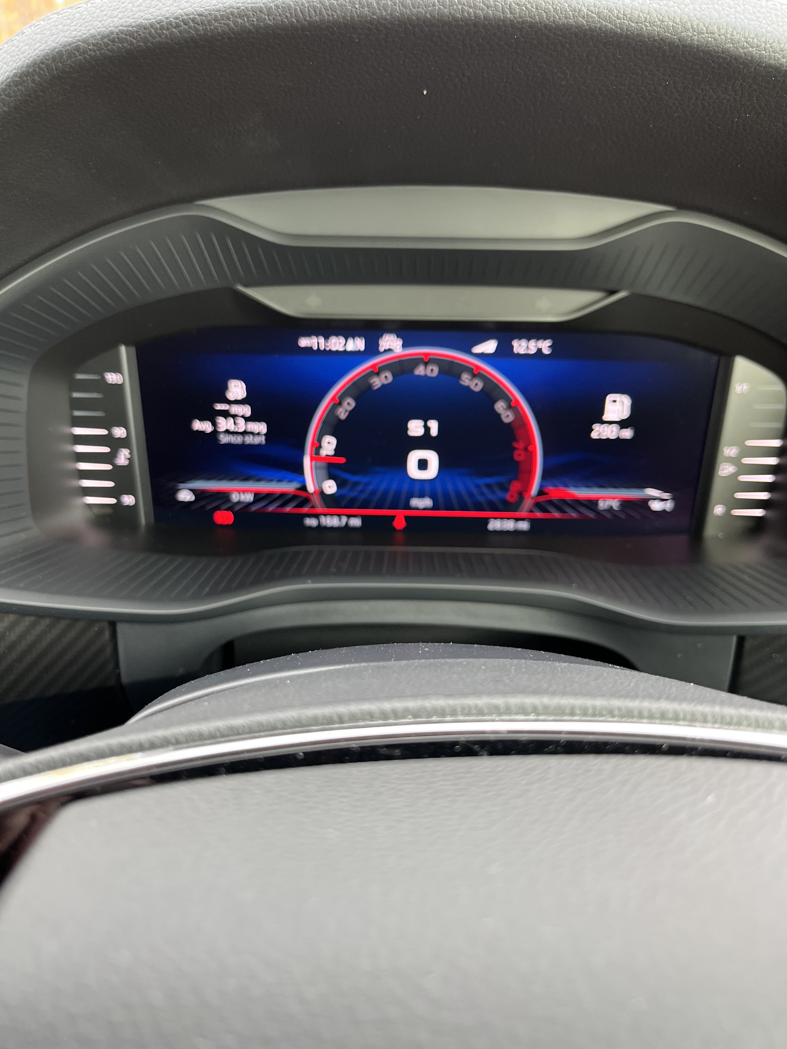

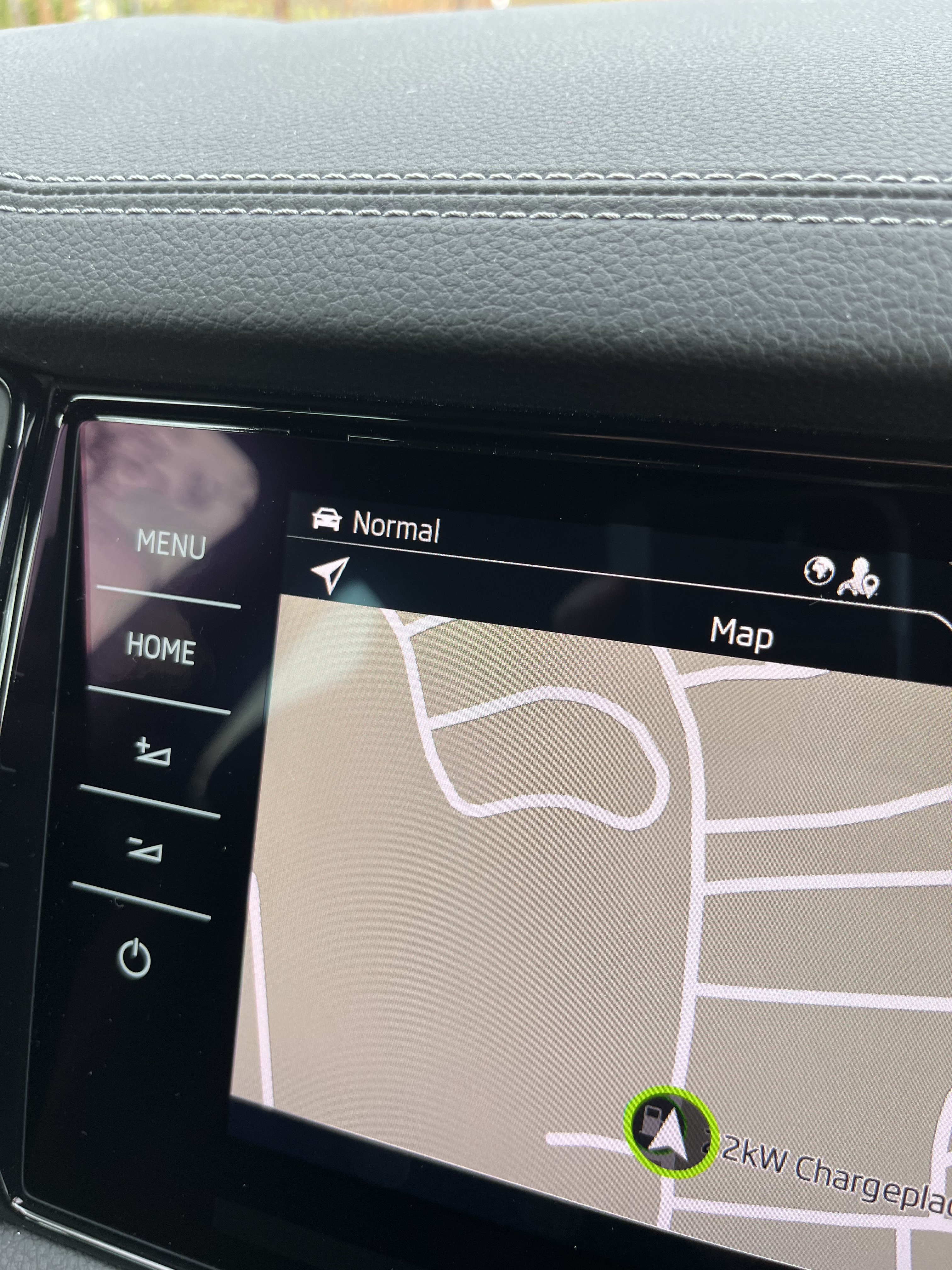

On my current and previous Kodiaqs pulling back on gear selector only puts gearbox in sports, drive mode remains on normal.
Yes, as you haven't changed the Drive Mode using the Mode button or menu item, so it will still show as being in Normal, the the car will effectively be in Sport Mode though by using the gear lever and change the gearbox, steering and adaptive suspension settings (if you have that fitted).
