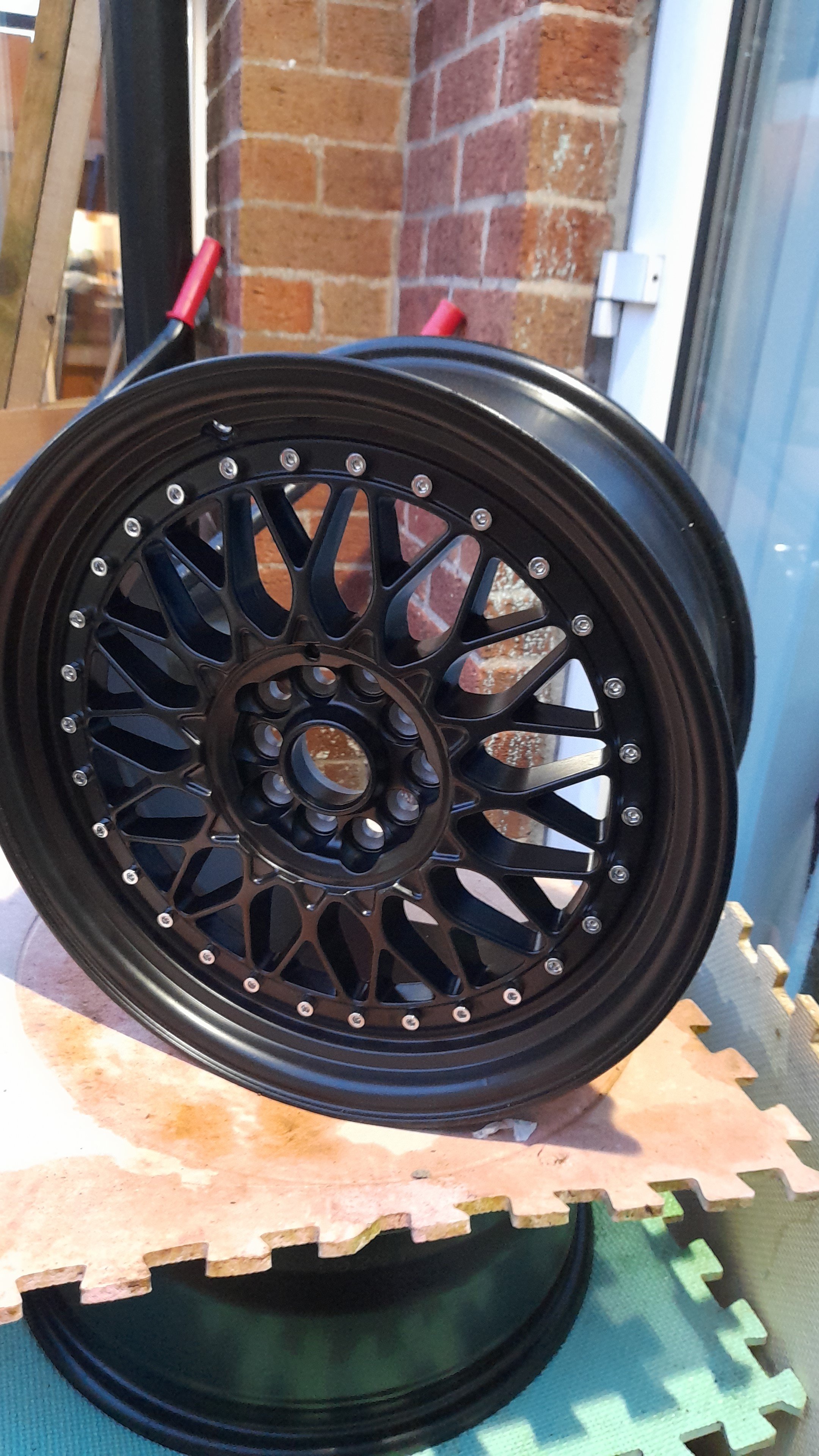

Right guys this topic I'm sure has more than likely been covered before but I end up getting confused with it but I am currently refurbing a set of BBS RS (well more like dare alloys) copies. They seem to be 5x100 and 5x112 fitment with an et35 7.5j and 8.5j. So first of all what tyres would be recommended to fit ? I'm thinking (and know factory size is) 225 45 17 , but will they fir the 8.5j rear wheels? Also I've been told either they won't fit or will be tight to fit the rears?? I don't have any suspension modifications done to the cat but I'm planning on fitting a set of sport springs  all round. So is there any bright minded people in the skoda community here  that I'm sure can rhyme this stuff of in there sleep or have encountered this problem before.?

There a multifit wheel (the 2 stud patterns on  the wheel) but I know the octavia is 5x112

Don't know the manufacture we did think they where dare wheels but they seem to be Chinese copies. The fronts are 7.5j et35 17" and the rears 8.5j et35 17". I'm assuming the factory 225 45 17 will fit the fronts buy what about the rears.

That's what I have done but I'm hoping they fit but was looking to see if anyone had any experience going down this route? The guy I got them off had them on an astra (wobble bolts) with 215 40 17 with a good stretch on the tyres. But they where on a mk5 golf who he got then off but unsure about tyres. I was planning on fitting the 225s on the 8.5 rim but was advised they would be too narrow
