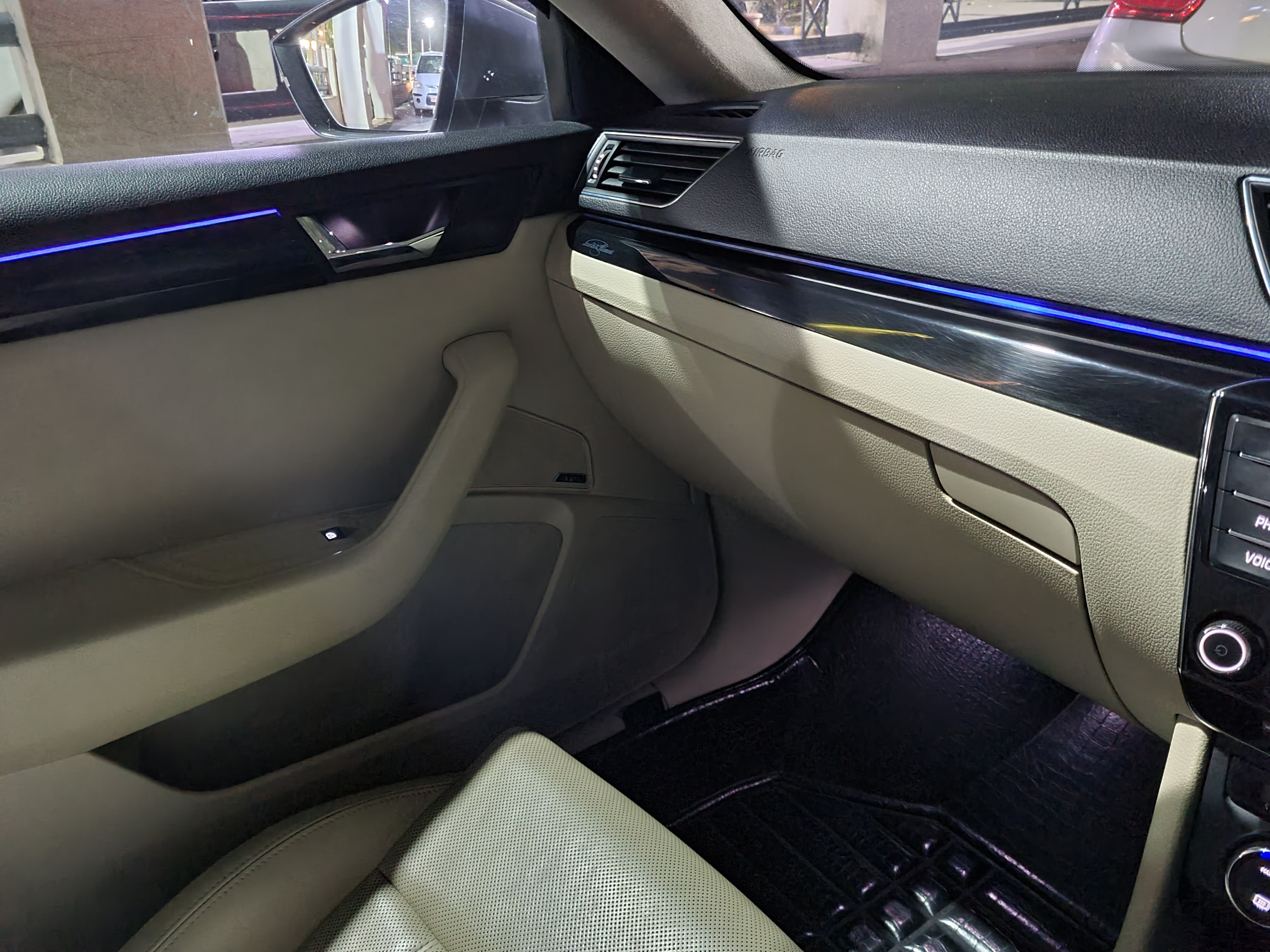

I own a used Superb Mk III 2016, which comes with ambient lighting package, but one issue I have always had is that the ambient lighting doesn't light up on the passenger side.
Now, I went to the stealership and they quoted me around $700 for a replacement (for a whole set of 5), which I think is a bit too much for this since other lights are working fine.
Is there any workaround? Has anyone gone though something similar?
Is it a whole section that doesn’t light up at all (as if the wire to it has broken), or a section is only lighting up in some colours, or for part of it.
Or is it not working at all
First one obviously needs checking for loose or broken wiring
Second one would need lighting strip replaced
Third one would be the controller unit

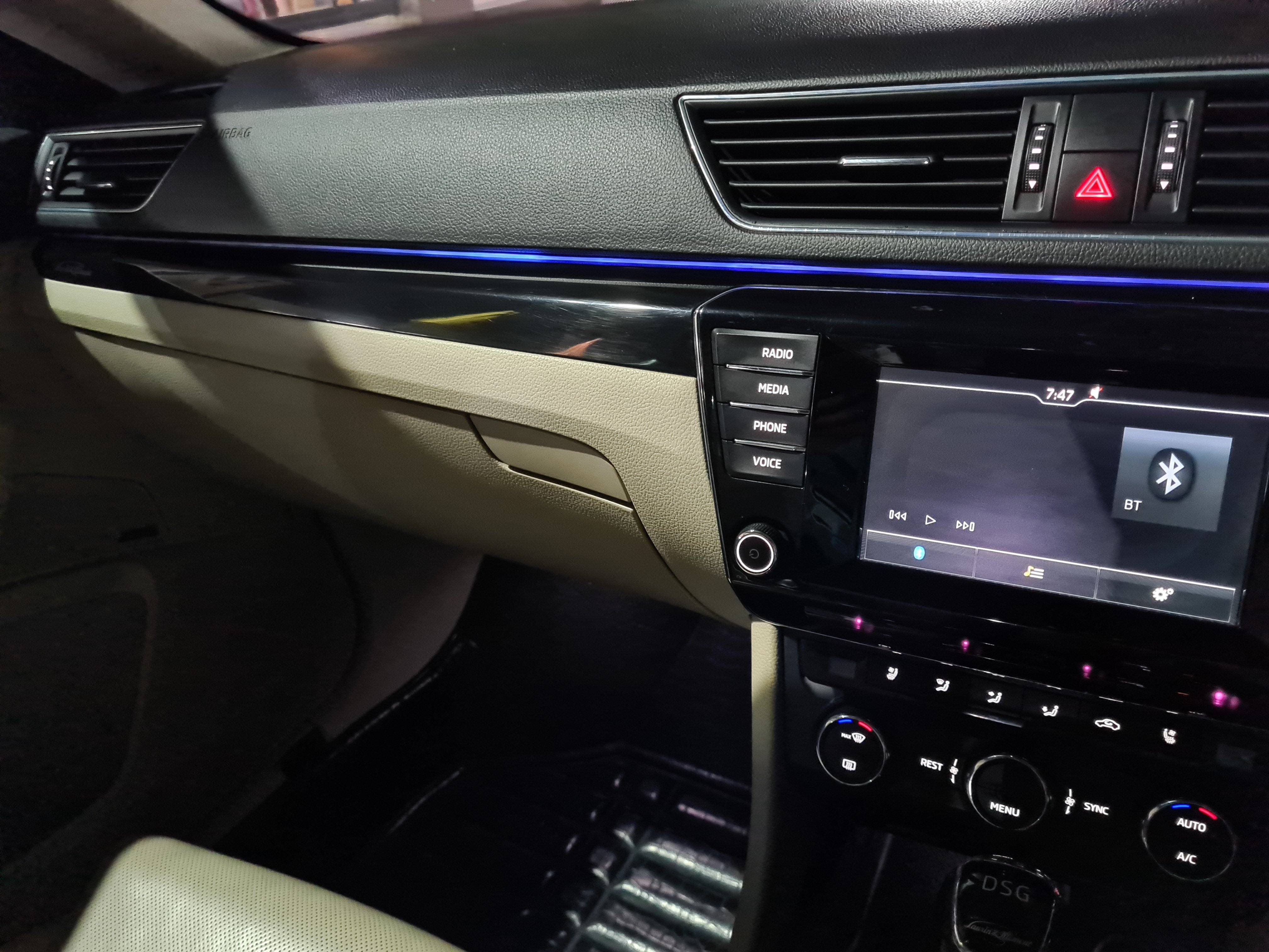

Around 15cm of the lighting strip, from the passenger side, won't light up in any color.
It is kinda unlikely for a wire to be broken there since that trim panel has never been opened.

So I was able to take the whole trim apart from the dash board and I found that there are only 2 leds lighting the whole panel with the help of 2 clear acrylic rod of 3mm thickness. The rod on the left side of the dash has developed minor cracks in it which is why the light doesn't travel till the end of the trim.
I will try to look for some replacements rods.
