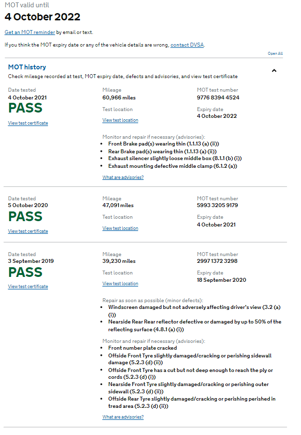

I was looking into a 2016 Skoda SE L Executive 2.0 Tsi 220ps with full Skoda service history, 62k mileage for £125000.
When it comes to car my knowledge is limited. Is this MOT history concerning?  From the first MOT does it looks like it was involved in a front collision?

I’d be more concerned that the car is slightly overpriced! 😉
The tyre condition at ~40k miles may  just be because the owner was still on the original tyres. Is there any info in the service history of new tyres being fitted then?
Cracked number plate is likely due to some front impact but it can be hardly anything to cause that, e.g. low speed contact in a car park, someone else’s bad manoeuvre. If the damage was  more major, I’d have thought the number plate would also have been replaced when other work was done. But ask the seller if it has had any insurance work?
If DSG auto, does Service History show it had gearbox oil change at or just prior to 40k miles?

What the car is like now 3 years on is what matters.  So what it's condition is now as the keeper last year maybe gave it care and arrention.
Is there a new windscreen in now.
What condition are all 4 tyres and is there a spare.
Since last year have the brake pads been replaced maybe even the discs replaced.
The MOT they are going to do now before you buy the car is important.  Do not take it with the MOT expiring in October.
If the place selling it is a MOT Station or a mate does it then that is not always the best thing.
But if they pass what should not pass or there is stuff that should be at advisories there is some comeback when you get the DVSA in if necessary.
If there is a Full Skoda Main Dealer History what is the History?
Has it been 3 Variable Oil & Filter Services only.
Was the brake fluid changed @ 2019 or since, the pollen filter changed a couple of times, maybe the air filter.
Have the spark plugs been replaced.
If it has a DSG was that serviced?
Full Skoda Service Histories should leave you in no doubt what service and maintenance or warranty work was done and put on the system.
Paper invoices and receipts help.
Serviced to recommendations or OIl & Inspection Services and Extended Scope means nothing.

The MOT history looks like someone owned it who isn't a car person and does the bare minimum. If the dsg was not done at 40k it's a sign that it's not been looked after IMO.

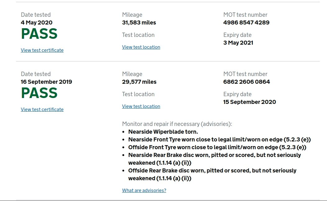

You can MOT a car anytime you want in the UK.     Many are MOT'd pre sale to come with a new MOT.
You can test one today and it can fail on a Major item and need to be taken off the road.
Your 4th September date is to keep the MOT at the present & might matter to some who want to keep MOT's being yearly.
Many are not as they are SORNED, off road being repaired, not MOT'd until 6 months late because of Covid rules that allowed that.
I MOT a car before selling one, or when buying one if i want to know what to do to it.

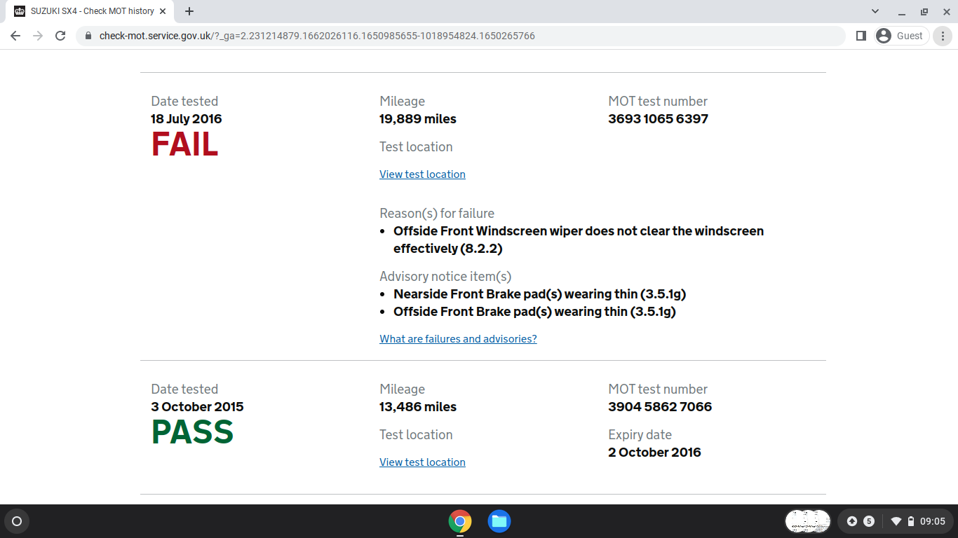

@Phutters  You should know your cars condition as you look after it or not.
If you bought a car last night online when celebrating your winnings you might want to know what it needs doing to be safe on the road, or as safe as a MOT test might indicate it is.
I bought this one.  I knew the condition, & It went straight for a MOT.

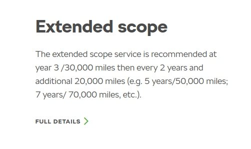

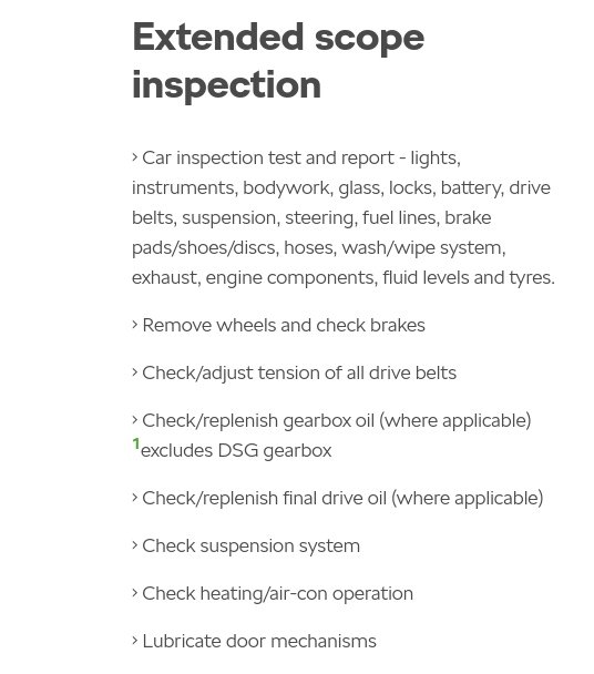

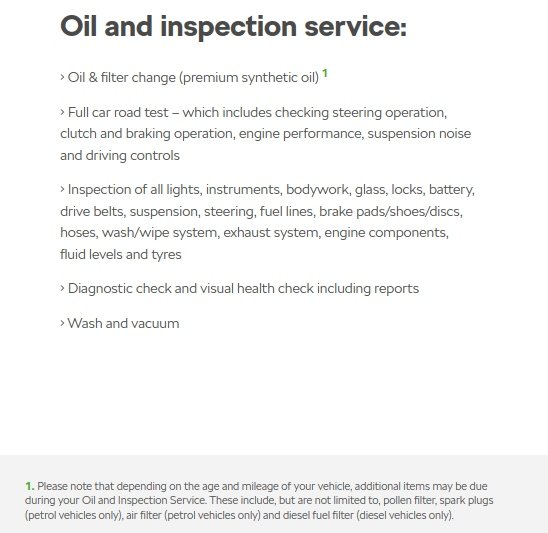

Check what was done at the Major Services because a Skoda Main Dealer Major Service might just mean a Pollen Filter changed over and above what is done at a Minor / Interim or any other name used for a service between Majors if there are any between a Major.
Is there anything not done that might invalidate the Warranty?
There should not be if Serviced to the Manufacturers Recommendations.
The bottom blue chart just gives an idea of what Skoda have as recommendations / guidelines as not often is the word schedule used but it is on a recent Skoda UK website.
