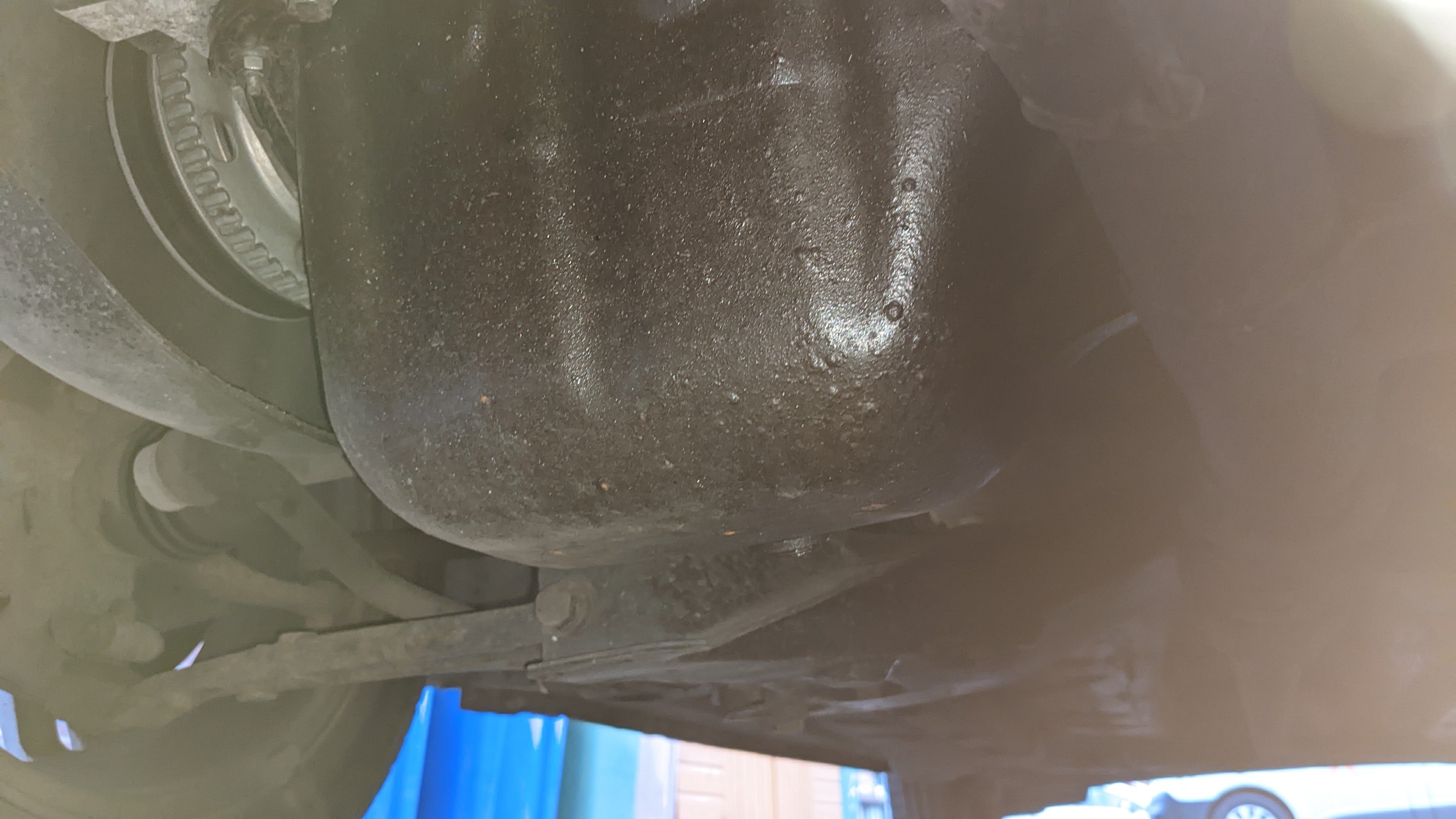

  1. I painted Owatrol on Mrs BJ's 2006 Panda sump that was steel and starting to badly rust about 5 years ago - It's held it ever since.  PXL_20220503_183106620.thumb.jpg.5d2133b222019370f33bc6371b3430b3.jpgok.

I used Owatrol on the sump from the 0.5l cans brushed on after being poured into a jam jar. I've since used the spray cans on suspension parts and hard to get to places. Try a can of each to start with.
