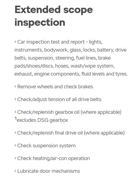

Bottom in green, pre 2020 Servicing,
how it used to be. Minor & Major Servicing or even Major & Major.
827614452_SkodaFixedPriceServicing.JPG.3dbea7606c029076ed94e2f0216199b6.jpeg.689c25a185d90e4e44889f342770023b.jpeg
