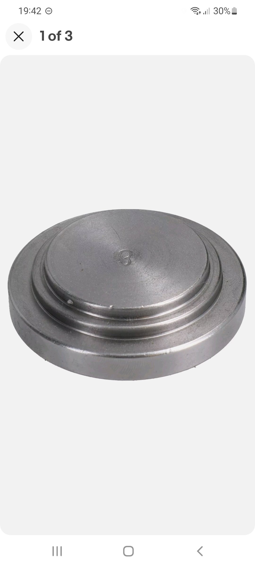

Q. I have a caliper tool but it's too small for the piston, can someone advise what one I need and I will pop out to Halforda or Europart.
Also , does the piston need to turn as it goes back? I may as well change the pads I guess even if there appears to be half the material left on them.🤔

Front calipers don't need their pistons turning to retract. Big G-clamp or one of those trigger action woodwork clamps should do it rather than a dedicated tool? Even strong hands should do it on such a young car.

Thanks I think I need this , I've bought one cheaply on eBay so it doesn't matter if it won't fit.
