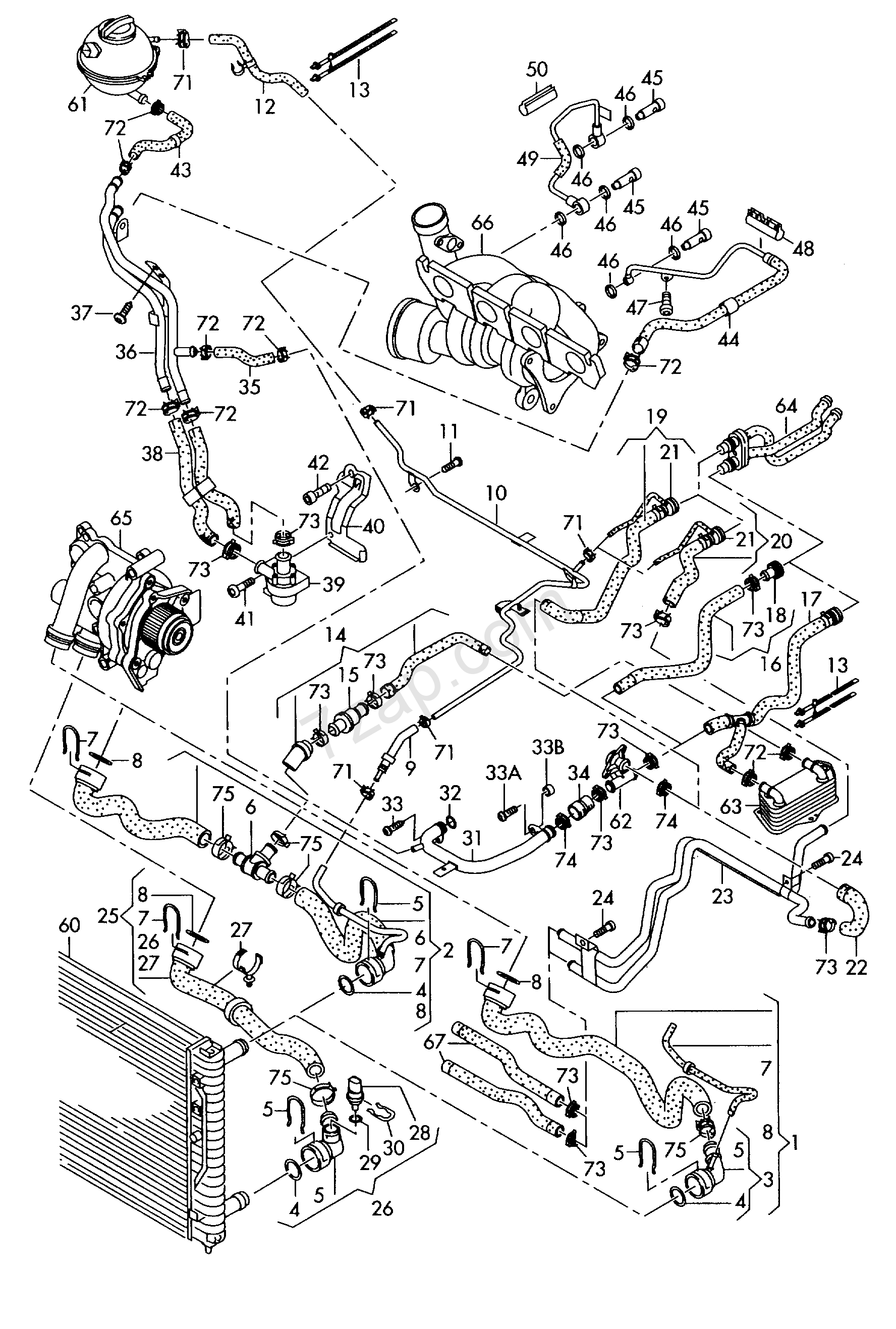

Looks like two connections @KenONeill
Definitely 2 hose connections to the coolant reservoir sphere, 1 supply, 1 return.
Coolant being pumped around a cold engine is impeded by the thermostat to enable a fast warm-up and you should see a stream of bypass coolant flowing to the reservoir, as the engine heats up the thermostat opens allowing coolant to flow through the radiator and lessening the bypass flow.
Any excess pressure in the system is vented via the reservoir sphere cap valve.
As previously mentioned, check the coolant level prongs in the reservoir sphere for contamination, an old toothbrush is good for giving them a scrub, also check the wiring connector and any relevant fuses.
