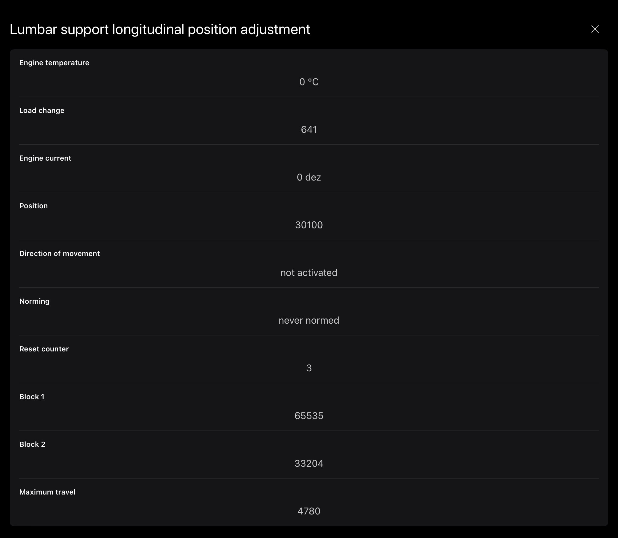

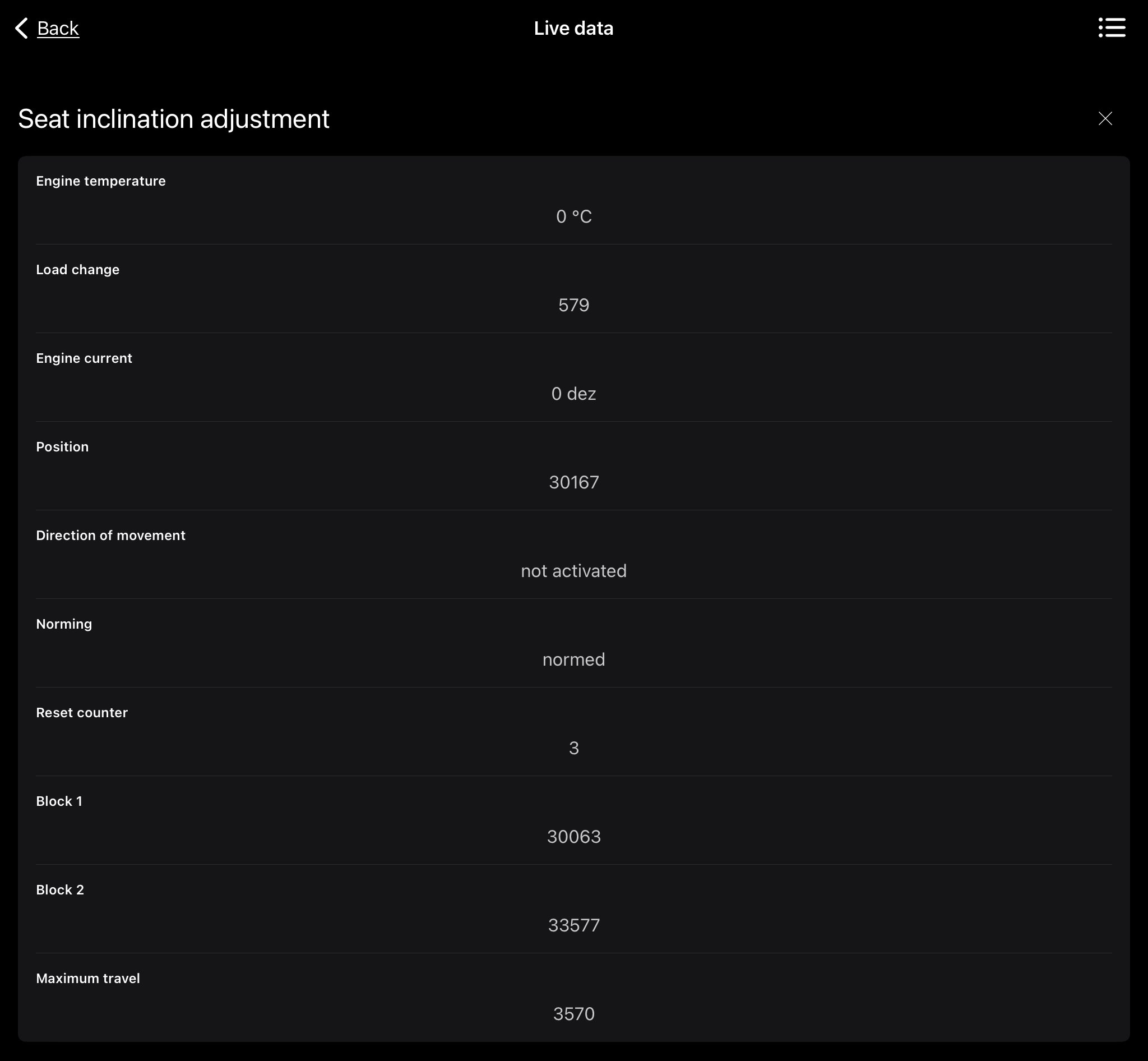

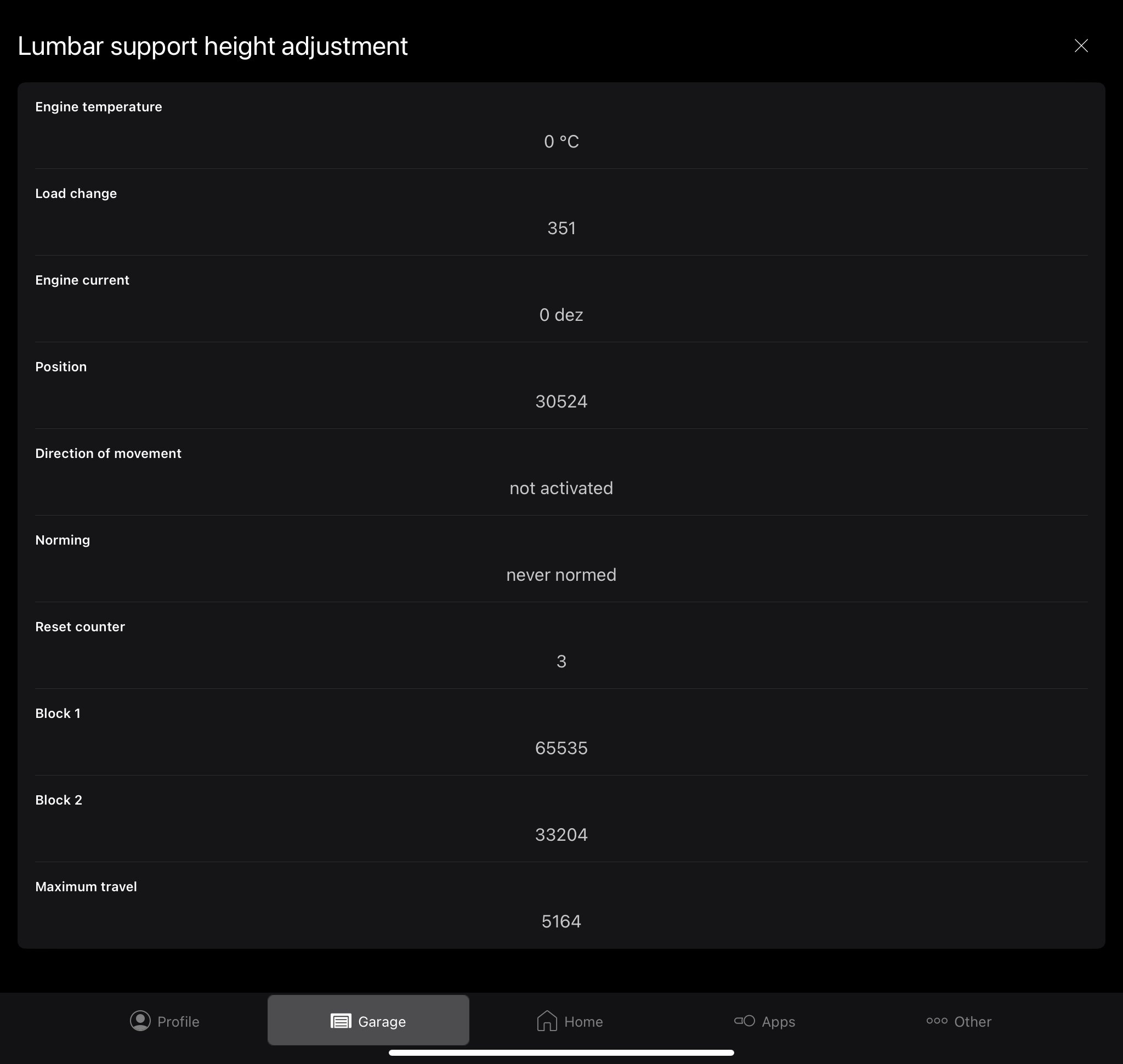

In live data the lumbar support height adjustment and the longitudinal position adjustment show the contents in the photos attached
The lumbar support shows not never normed?
Can anyone check if this is normal? I have cleared the fault code numerous times and run normalisation and it just won't fix even though the lumbar support adjusts as part of the process.

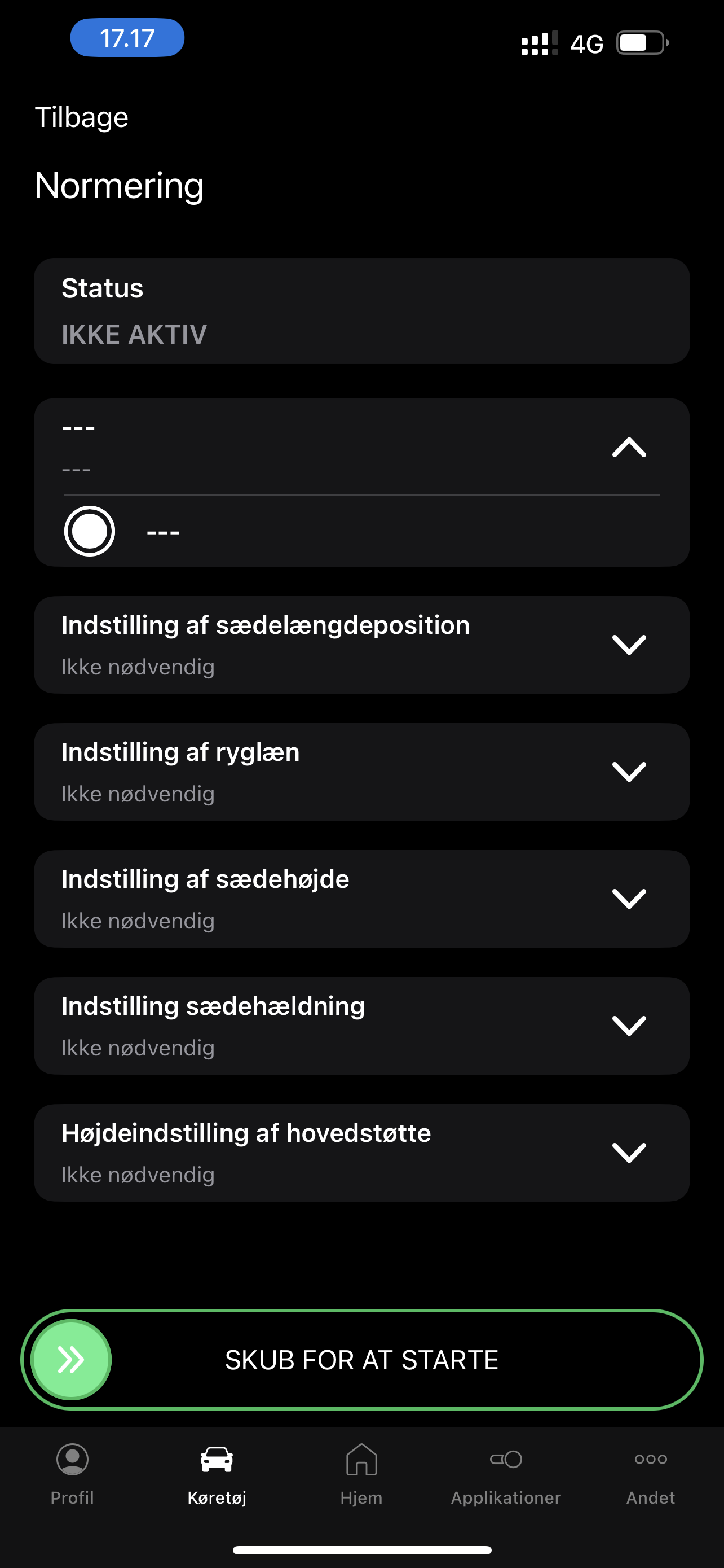

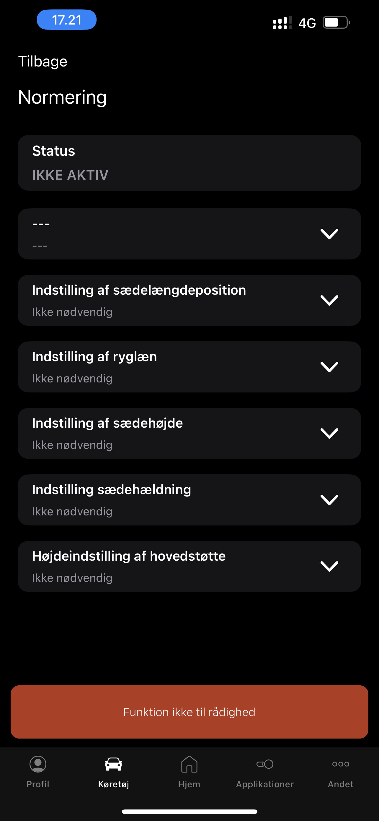

I don't seem to have that option 1 "All axles"?
What options do you have? Its best to do all axis individually, if you do them all together the seat can collide with the headliner.
Well this is in danish. Hope you understand
When i try to slide to write it says it’s not possible

People that keep suggesting moving the seat as the be all end all, it isnt sadly.
There are 6 axis positions to the memory seat - lumbar up/down, lumbar forward/back, backrest tilt, height, rake and leg adjustments.
All 6 of these need to meet a set specification for the memory to work.
The specification is for each of the above as follows: Normed, Standardized, Block1, Block2, Max travel.
The seat must first be standardized with a diagnostic tool - this will clear Block1 and Block2 and max travel and also reset the status and error counter. The diagnostic tool will then move the seat to its extremes on the axis and use this to create a Block1 input then using the data that is stored it will preempt the max travel position. The module will now show as 'never normed'.
At this point the user moves the seat to its extremes of the travel on all axis, this will confirm the Block1 to be as before, then when moved to Block2 it will confirm it is what was expected for max travel and as long as it is within the spec that was expected it will change the status to 'normed'. Now do the same for all the axis and you will hear a bong song.
The issue you are probably facing is either the Block1 and Block2 have lost a value or, if the motor has managed to skip a times (almost like slipping its timing) then when it gets to an extreme of its travel it will realize a Block1 or Block2 is beyond the stored values and loose its standardization.
The only axis that behaves any different and it depends on module coding is seat backrest tilt which is set to stop at its Block2 limit as expected, but on some, you can press the tilt back button again and it will continue past its 'safe stop' to allow user controlled full reclining without protections to the point you can crush the rear seats if you felt so inclined. And this will not throw any errors or loose the adaptations.
