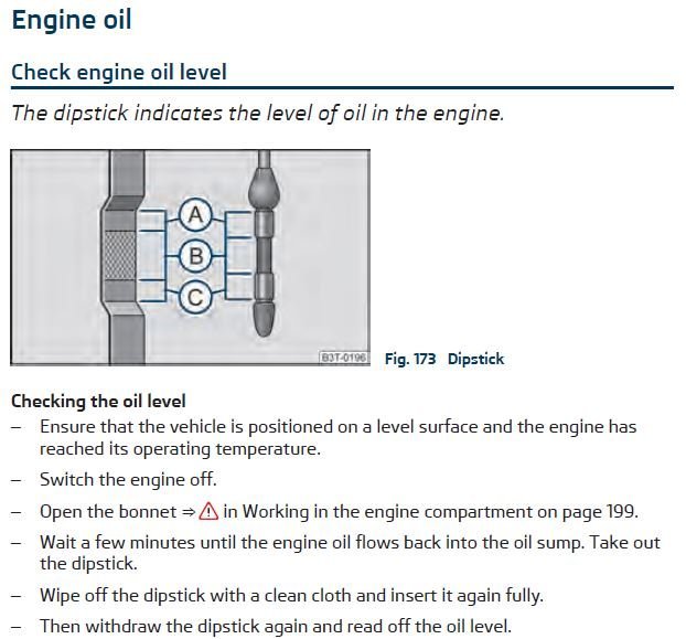

Skoda/VW say you should check it warm, so I wouldn't worry about it.
Thanks Pete,
I’ll have to change the habit of a lifetime!
Not really any need to change your habit.
 Just check once Cold then check and a At Operating Temp check..
So as you are now you know the level is correct for the oil on the dipstick.
Still check cold before starting an engine so that the oil is all in the sump, as much as goes to the sump.
But still check at Operating Temperature / Normal Operating temperature as VW, AUDI & SEAT says.
Then you know the difference.
Before a trip you know you have enough oil in a car instead of setting off not knowing or needing to fill up.
It is Skoda that says 'warm'.
 Some manuals from VV Group say 'Hot' or Operating Temperature for the same engines as in a Skoda.
Czech is a different language from German, English, US English, Chinese etc.  Lots gets lost in translation.

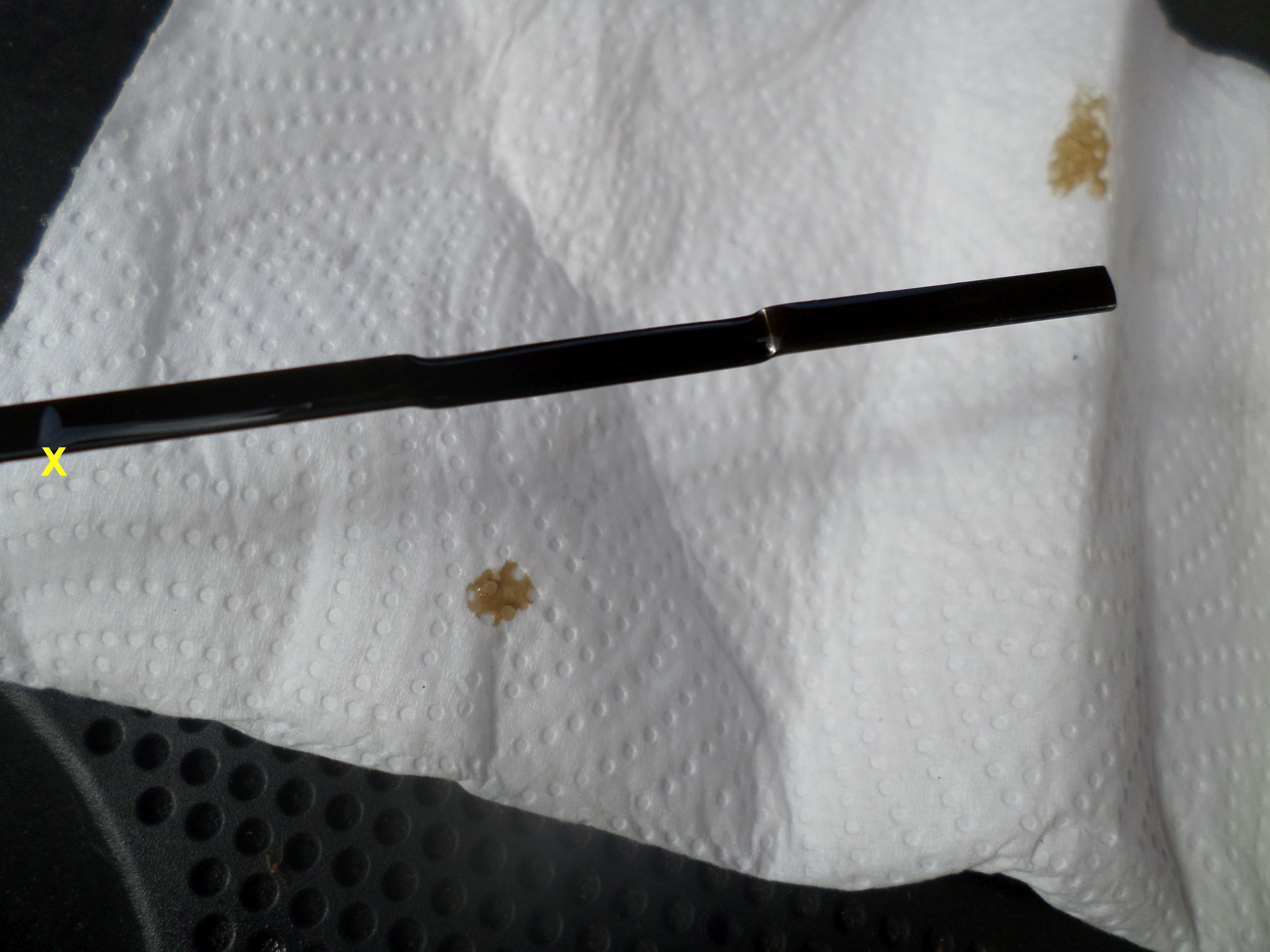

I've just checked my oil, pic of dipstick as first pulled out. X marks the level of oil cover.
The actual level was on the lower limit mark.
It gives such an obvious false reading after standing a while that you wipe the stick and dip it again. It doesn't show the level, it is picking up the oil from somewhere

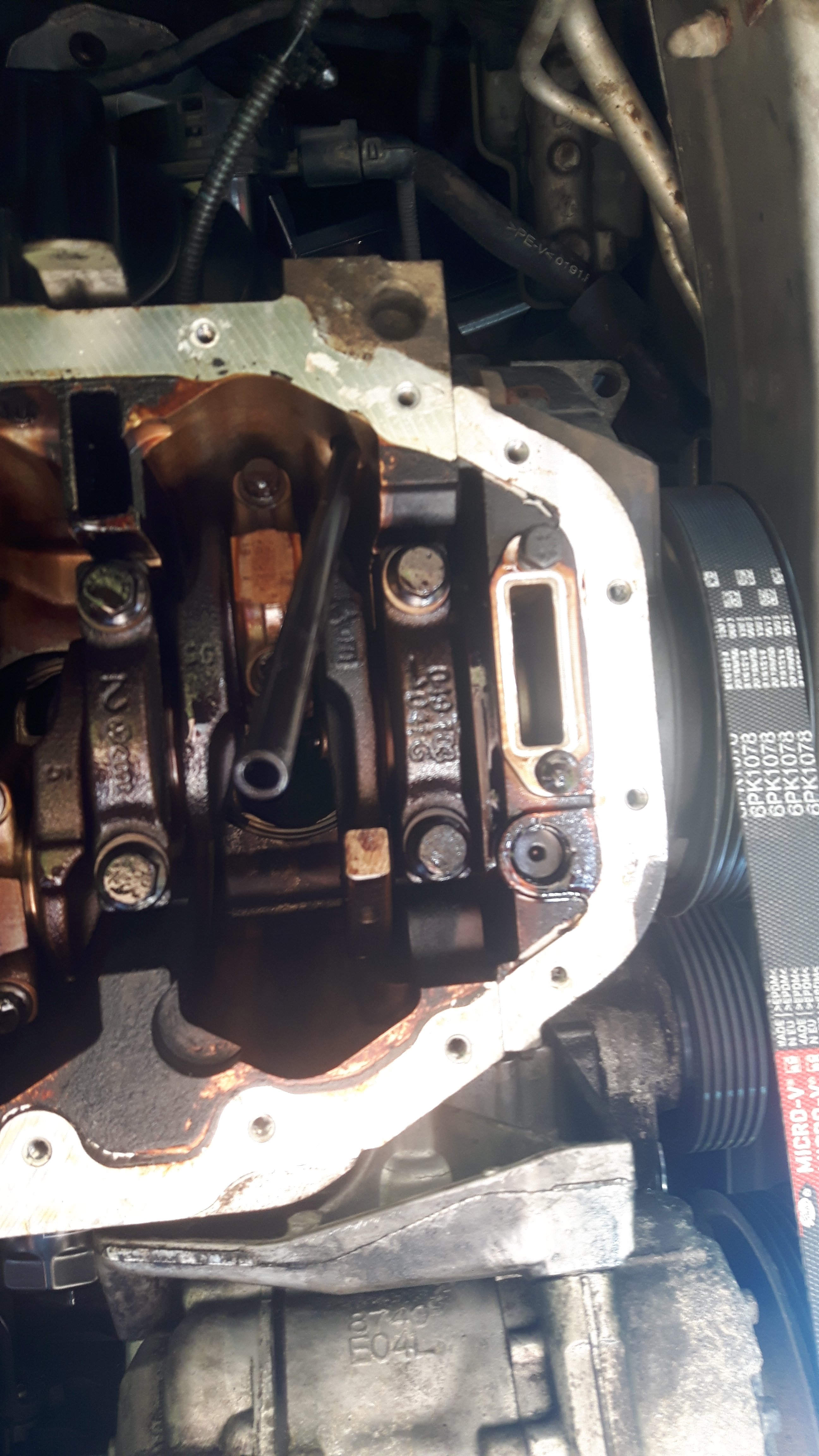

Dipstick tubes generally stop at the block and do not protrude into the crankcase at all.
Well I distinctly recall headbutting the end of the one in my BKY engine while under the car with sump off, and thinking, "better not stick that in an eye..."
Just found a pic:
Edited by Pete_Ex-Wino
Wow, it's like a big black drinking straw, I've never seen that on any other engine.
