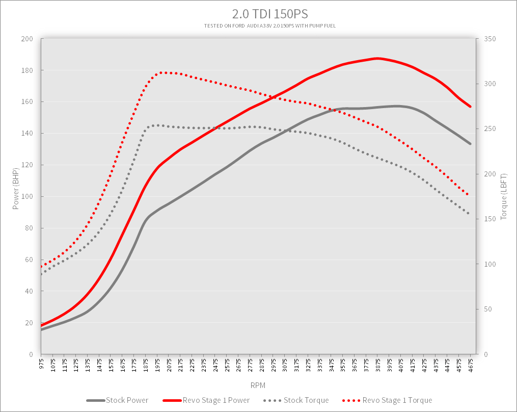

Attaching the dyno charts as well.
DATA VALUES The Bosch EDC17
Boost In standard form the boost will peak at 1.4bar tailing off to 1.0bar at 4500rpm. In Revo form boost will peak at 1.5bar and tail off to 1.0bar at 4500rpm
Fuel Mass In standard form expect to peak at 60mg/stroke around 1500-3000rpm, seeing 43mg/stroke at 4500rpm In Revo form expect to peak at 68mg/stroke 1800-3000rpm, seeing 49mg/stroke at 4500rpm
EGT In standard form expect to peak around 780ºc In Revo form expect to peak around 940ºc
Very stressing is the diff in EGT temperatures for me.
