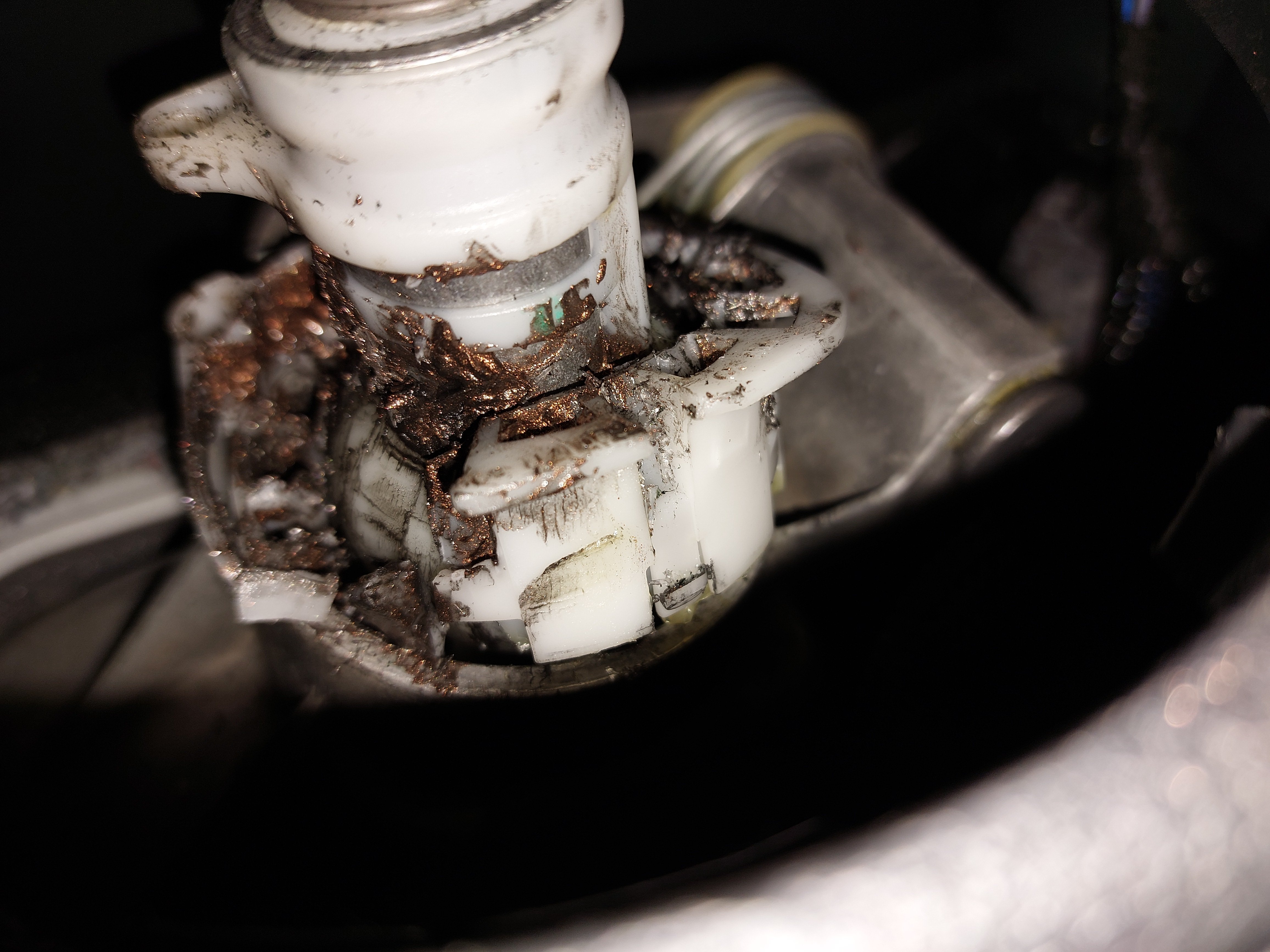

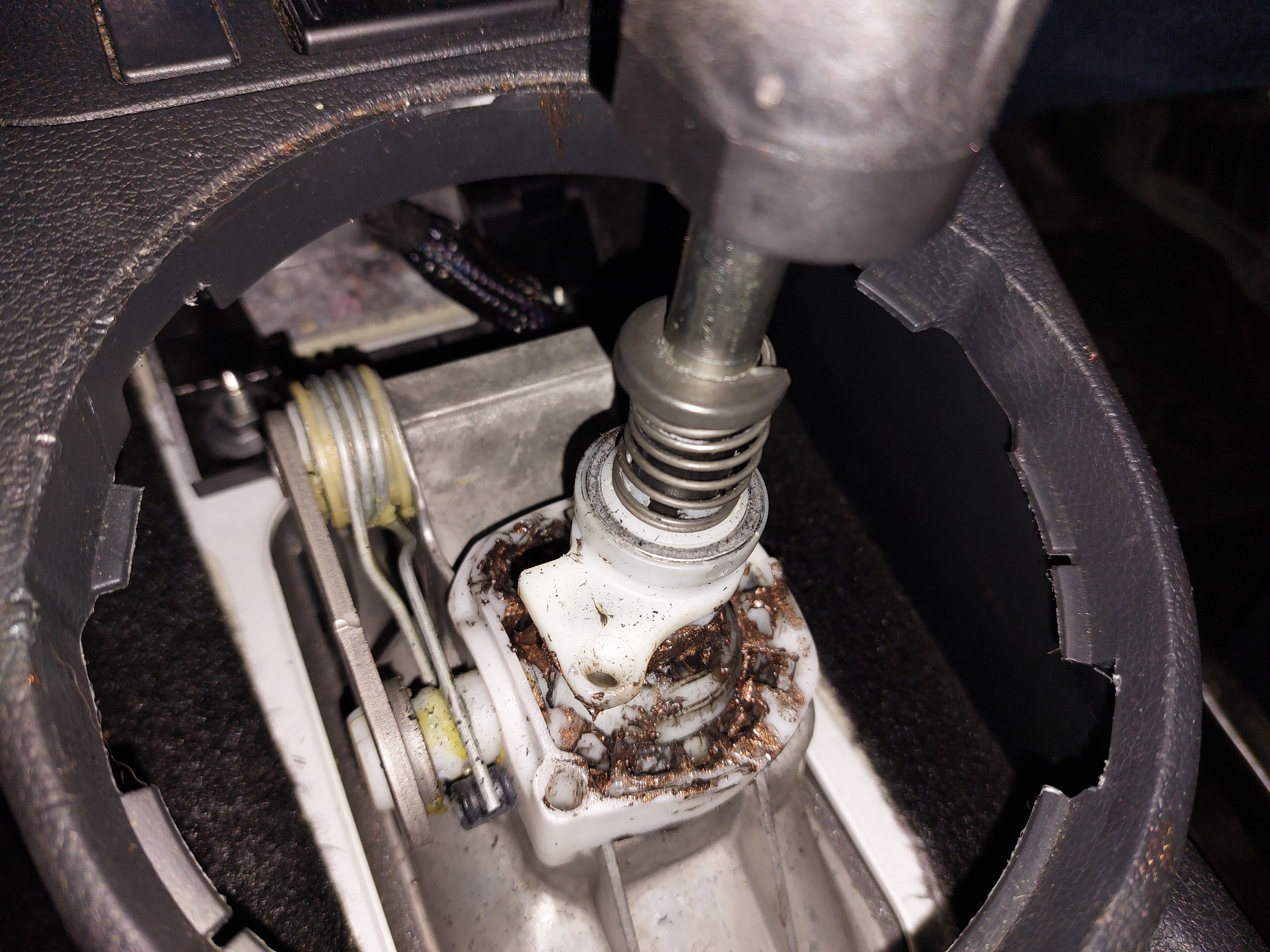

Good afternoon all, I've noticed on my car that changing gears is fairly sloppy and not as nice as I'd want it to be.
I've found most of the slop to be coming from the shifter.
Video related:

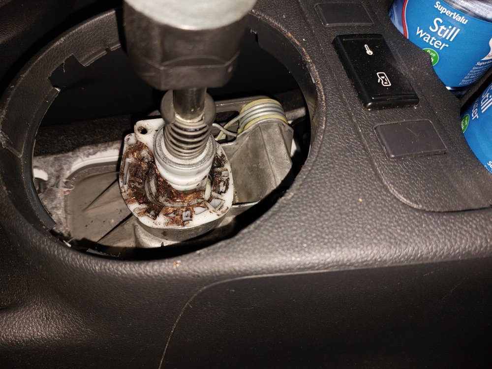

Ignore the grease, that was my doing a while ago.
Does anyone have any good guides on how to strip this down and rebuild it? If so, where can I get replacement parts for it?

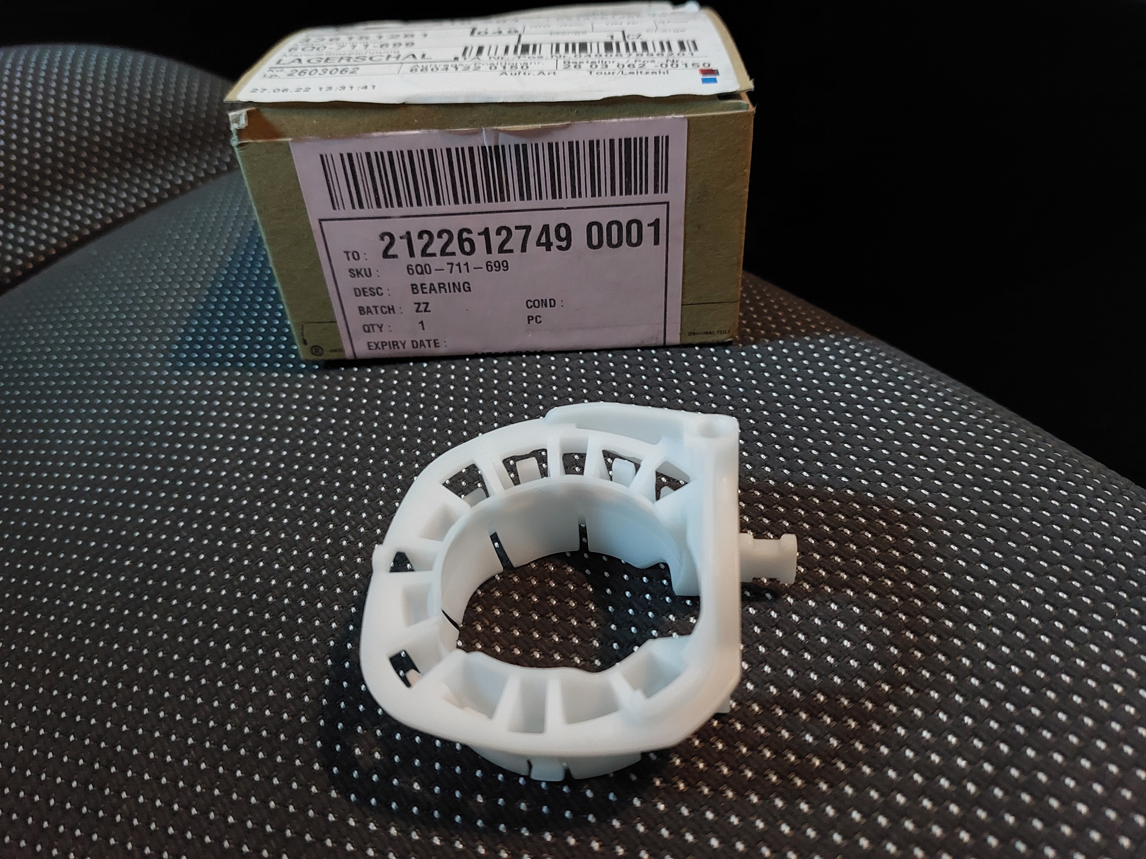

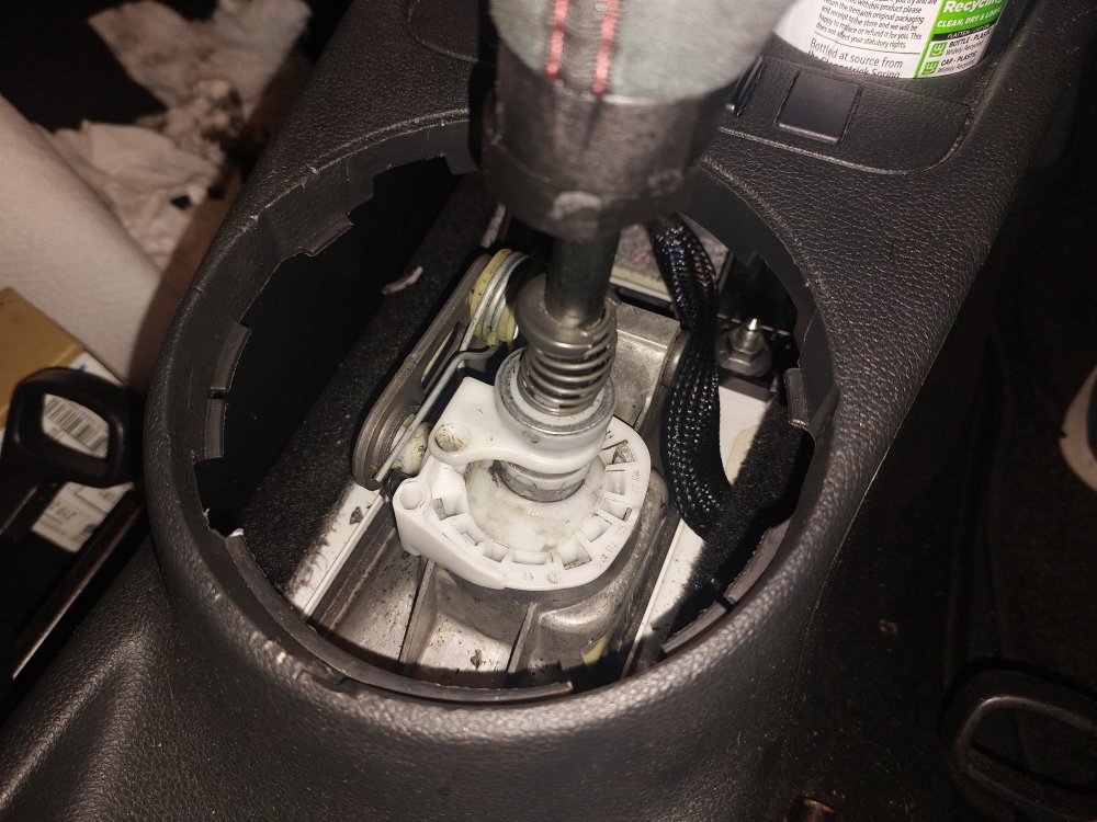

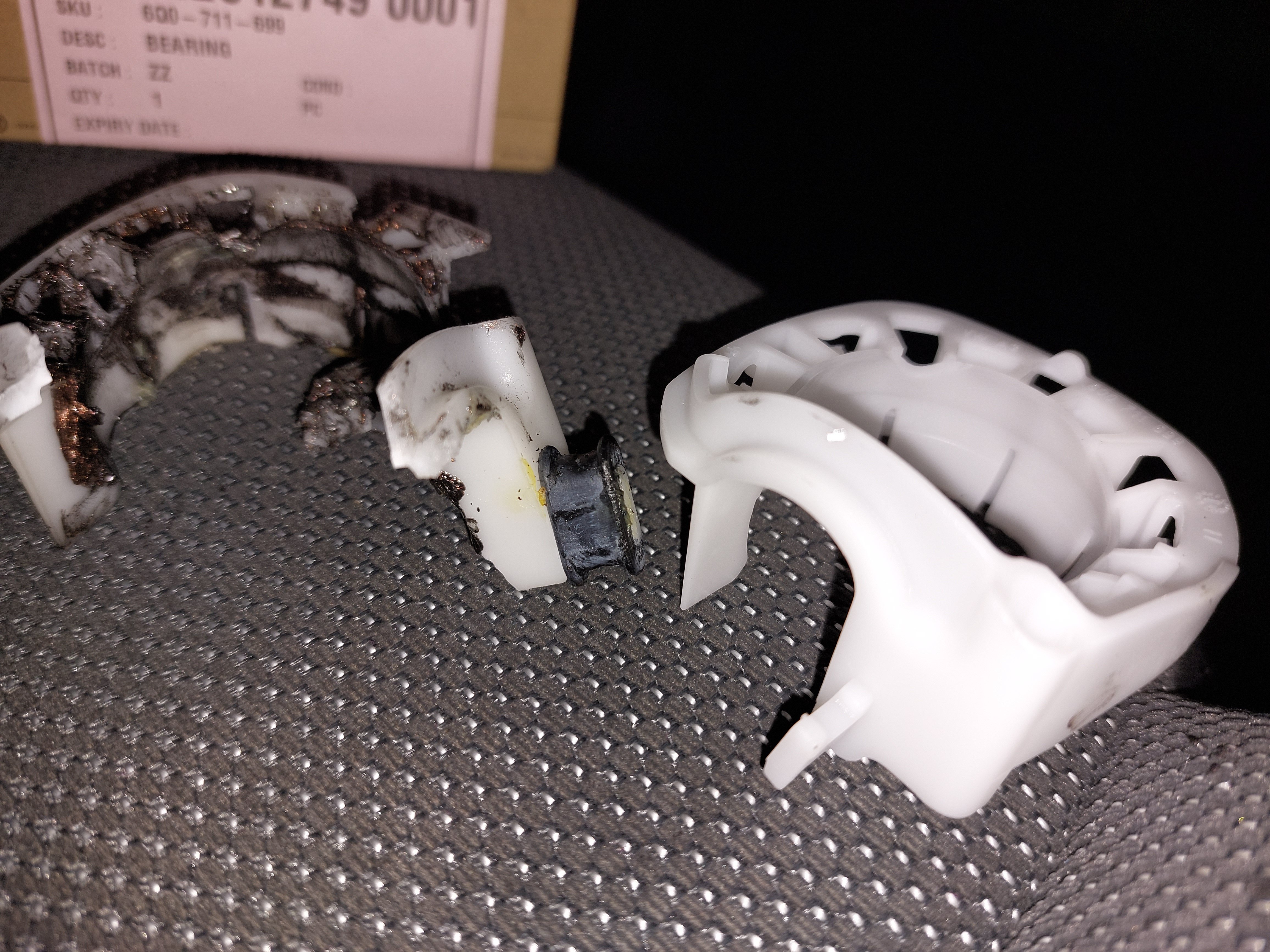

Thank you, I think I could get away with replacing just the shell. From what I can feel that is where most of the play is coming from. I'd rather rebuild the one in the car since swapping it out looks like a lot more work.
I'll go into the dealers tomorrow and order that part, thank you.

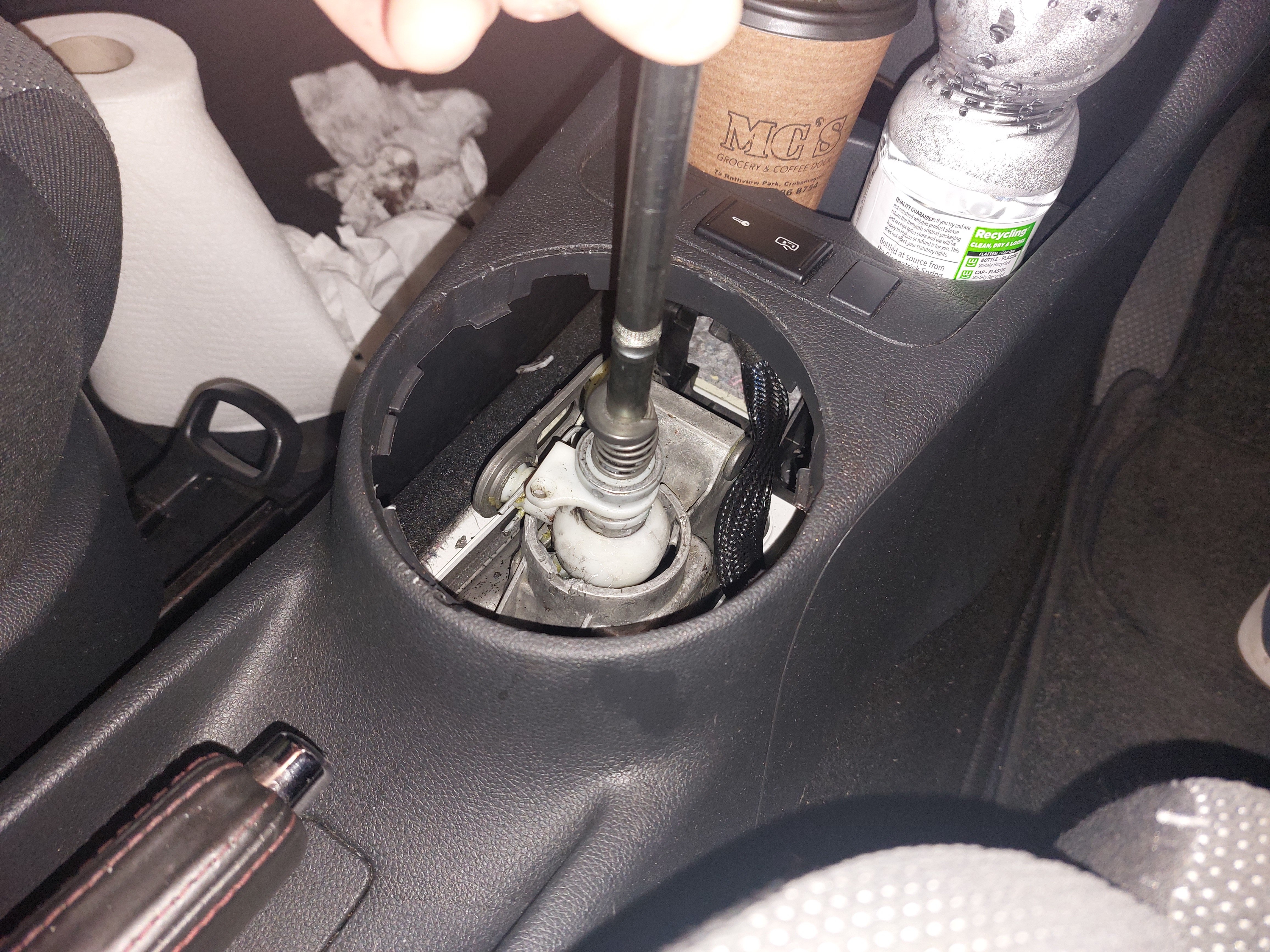

its alot more work to rebuild! to get to the shifter internals you have to drop it and remove it from the car. I had mine out to change the linkages when they went. Not something that can be done without dropping at all.
Just as an aside you shouldn't use copper anti seize compound as a lubricant at all let alone for plastic parts like that gearshift mechanism.
Use silicon grease for plastics, regular grease for metals and anti-seize for stopping fastenings seizing due to corrosion.
Didn't realise that, thanks for pointing it out.
I have silicon grease in the shed and all so I'll use it to regrease everything.

I ordered a bearing shell from the dealers so may as well change it out, for the sake of a tenner it's worth a gamble.

I think there may be enough access for me to remove just the bearing shell in situ. If I have to drop all out then I'd be as well to buy a brand new unit to replace all with.
