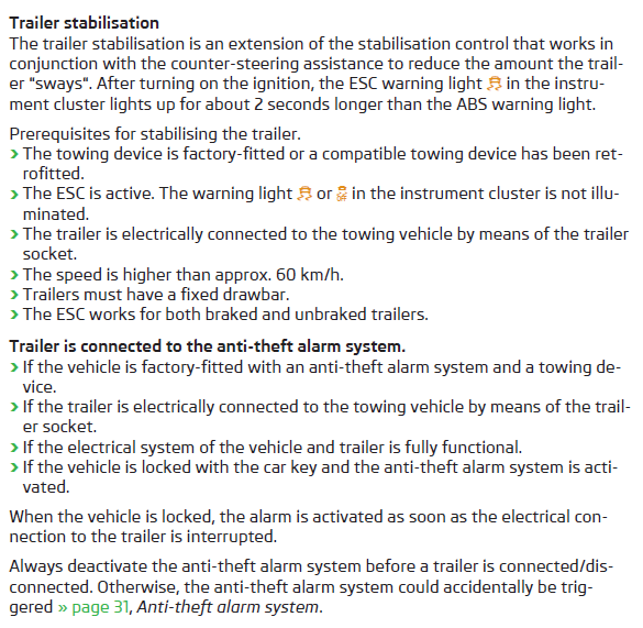

I am in the market to have a tow bar fitted and its more complex than i thought.haha
i have got my head around it all, i am just interested as i have read a lot about manufacture fiited safety features especially hitch yaw electronic stability, braking adjustments etc
my question is does the mk2 come with anything like this built into the ecu once a towbar is wired in, or is it the more modern mk3 onwards etc?
i have looked at my sticker in the boot as per a previous post i found on here, it is not prewired for towbar from factory "1D0"
kind regards
Fisher
From a 2012 Octavia owners manual in the towing section:
Given a 2013 vRS will have ESP so assuming it's a suitable towing kit along with appropriate coding, then yes, you'll get trailer stabilisation :)
