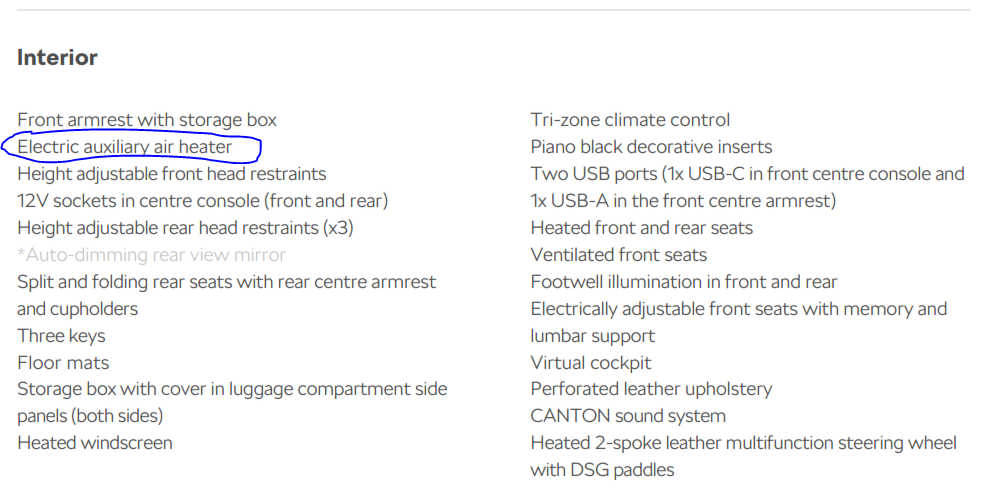

After building a Superb L&K on Skoda website, I downloaded Car Card. I was very surprised to see this option as standard: Electric auxiliary air heater. Do we know what is it exactly and how does it work? Is it simply a heating element that only works if engine is working, and provides warm air for heating the cabin before engine reaches 90 °C.
Exactly that...
It's a ~1KW PTC heater element that sits in the HVAC system to provide 'some' warmth until the coolant warms up enough.
I retrofitted one to a MK2 TDi Octavia and it did make a difference :)
