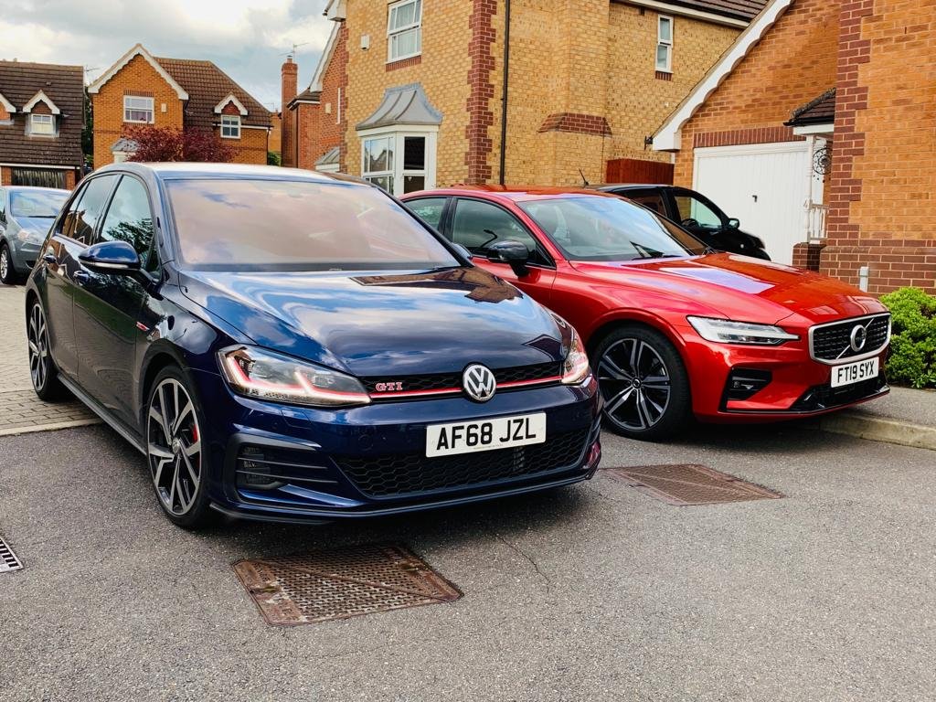

Easiest way to check is to view your car through the rear view mirror of another car, it's quite obvious then.
What is one looking for??
The VW/Skoda heated front windscreens  look different from unheated ones, with a pinkish reflective sheen, as seen in the attached photo. Compare the Golf which has a heated front screen with the Volvo unheated front screen.

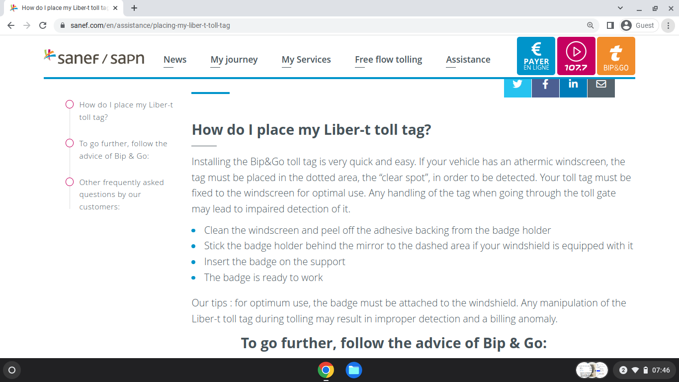

@NiamhDo they cause an issue with the Libere-t- tag being read through the glass?
EDIT.
I have my answer.     I did think there must be many that do have the screens like supercars...

It's not, my brother has a Vauxhall Zafira with an athermic windscreen (so he had to mount his Emovis Liber-t tag in the specially marked area) which definitely is not heated.
