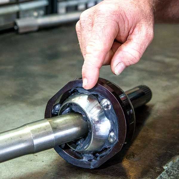

@J.R.your such a pedantic thing 99% of the time and respond with something which I agree is more correct engineering vocabulary wise, but in context doesn’t change the suggestions. Turning puts the cv components under stress.
on the subject of being pedantic you offer suggestions for both the mk1 and mk2 but this thread is in mk2. Although, I can see the OPs profile it suggests mk1. The description at beginning specifically identifies mk2.
maybe some clarity would help you or others target answers better. For the benefit of others here is an image of a cv joint. A mk1 explanation of traction control is probably not that relevant in a mk2 bkd.
