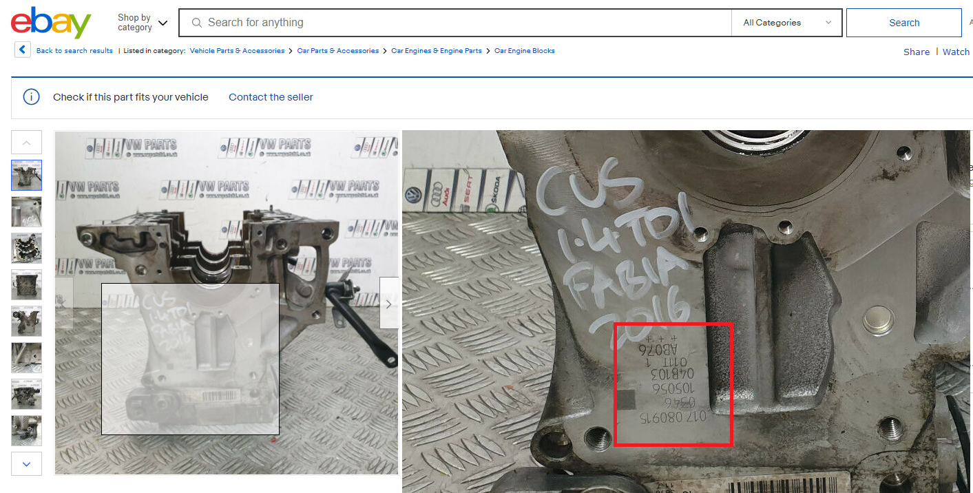

Not sure whether you have a CUS or a CUT code engine (what is the engine number on the V5c?), but this listing for a CUS engine block shows some stamped info on the first and second photos.  SKODA FABIA VW AUDI 1.4TDI CUS CUSB ENGINE BLOCK 04B103024T 04B103011T 2014-2017 | eBay
This one is upside down, and I think of the gearbox end of the engine.  Will be a shedload of stuff in the way of seeing this area, no doubt:
Thanks.. I'll go and check the log book.
