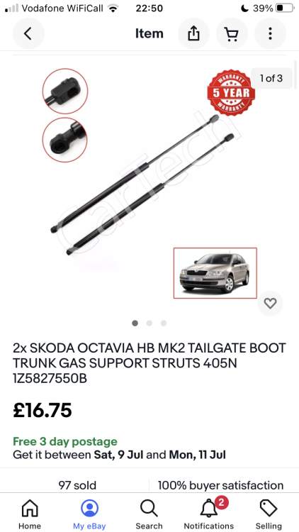

I had exactly the same issue on my 2005 hatch. Feels very resistant when pulling down on the hatch to close. But at under £20 a pair they were cheap including a 5 year warranty.  I fitted them about a month ago on a car with 257k on it. I am on bangernomics territory. Used ones were too risky and £10-20 a set not worth it in my mind.
https://www.ebay.co.uk/itm/274305477507?mkcid=16&mkevt=1&mkrid=711-127632-2357-0&ssspo=Ewc_ewyzRjS&sssrc=2349624&ssuid=45o-tdWCRea&var=&widget_ver=artemis&media=COPY
As @KenONeillsays we probability got used to the gradual decline in strength as they got weaker

Thanks for this link. I ordered these and they arrived the next day. FItted in seconds. I have to say they are OK. Not bad considering the price. Not the smoothest at the end of the travel and they give a bit of bounce if you let the tailgate up by itself. The pull-down force is a lot more acceptable now. It doesn't feel like I'm going to bend anything or break the mounting points.
Still confused why there is such a variation in some sites stating 405N and a lot of others stating 460N for the same car. That's 110N difference.
460N struts now returned for a refund.
Thanks for the help on this.
