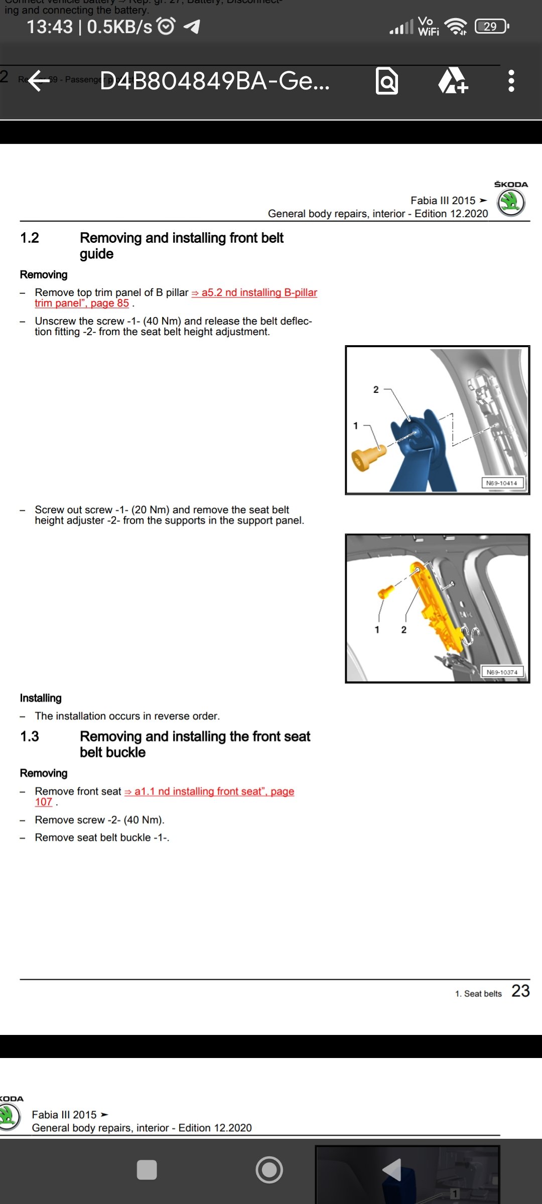

Here's the torque values if you need.
Screenshot_2022-08-08-13-43-55-462_com.google.android_apps_docs.thumb.jpg.acaf4cc068d276360007ac618de634d5.jpg
Another phone/mobile device fail I'm afraid. 😉  ETA: Turns out it's a cheap old monitor and eyes fail. 😄
Try this.
Edited by nta16
ETA:
The squished looking document looks fine if you zoom on phone, or here on PC.
But cheers for assist.
More proof that I have a very cheap old monitor then, I can see it at 400% zoom but it's as if looking at it the other side of a house window with net curtains (for those old enough to know what they are).
