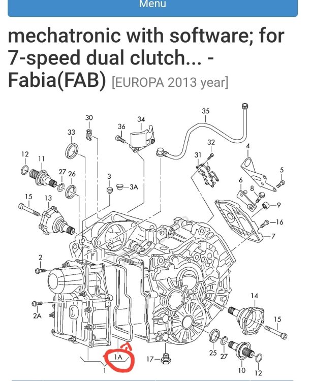

Hi everyone, my fabia developed a gearbox leak over the last few months. At first i was told that if i refill once or twice a year i should keep this car functional for a long time, but now, just 3 months later, it's throwing fault codes and putting me in neutral (after it was refilled once and looked over).
Only code i could catch live is:
P0801"transmission fluid pressure sensor/switch "A" circuit range/performance"
All with flashing "D" on dash and no drive for 10 seconds.
Now, i would like to fix this as a grenaded gearbox will write off this car, however i can't find the part number for the leaking seal anywhere? Closest thing i can find is loads of refurb kits on ebay for the mechatronic at £150 for seals or £300+ for the accumulator housing, that does seem to contain a similar seal.
Any help is much appreciated, thank you.

Is it this one?
729167636_Screenshot2022-07-1311_19_25.thumb.png.71a1aff97842ac2ef13d2d248f9d154a.png
From here: LLLParts
5 minutes ago, Breezy_Pete said:
Is it this one?
From here: LLLParts
Bingo! Thank you!
