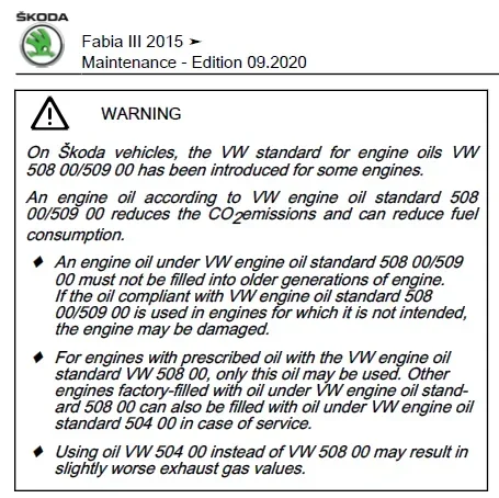

This is VW 508 00 / 509 00  so 0w20 FS IV after VW started using it in preparation for the WLTP / RDE.  Not backward compatible.
***2015 on causes confusion.***

Thanks chaps. How do I know if my sons car has a GPF as it was first registered in Nov 2017. If it does not have a GPF am i reading the replies correctly in saying it should ideally be either 0w 30s or 5w 30s VW spec 504 00. but could use 5w 40s VW 502.00 if on fixed service interval

The engine code is CHZC. As they supplying dealer has said its just been serviced with 5w 40 VW 502.00 I guess I'll have to stick with that for the next 12 months, however based on the advice above I'll then switch to 0w 30  VW 504.00. I don't think there would be much benefit switching to 0w 20 as my son's car doesn't have a GPF as its a 2017 car
