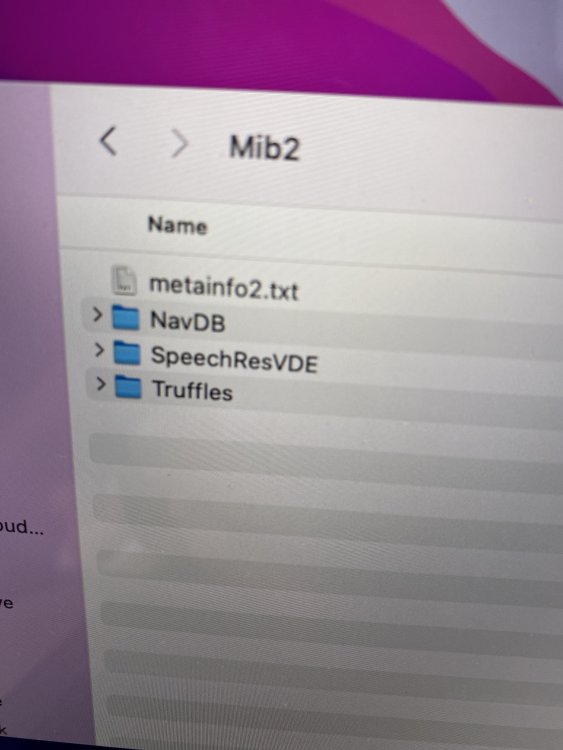

I’m having a nightmare trying to update my new Superb to the latest infotainment firmware.
I’ve extracted the zip file from the Skoda portal and put the files from the MIB2 into the root folder of the FAT32-formatted microsd which is in an SD card adaptor.

Are you sure it's actually a firmware?
Got a picture of the files on the SD Card?
What about the original filename of what you downloaded.
Odds are you downloaded a map update.
Sorry I mean map update.
Is that a MAC?
Because they are well known for 'adding' files to external drives, borking the maps!

2 things that can cause this;
Either the wrong firmware/update
Using a mac...
U don't need to enter into Service mode to do the map updates.
Simply insert the SD-Card and go to Navigation settings and trigger the update from there.
