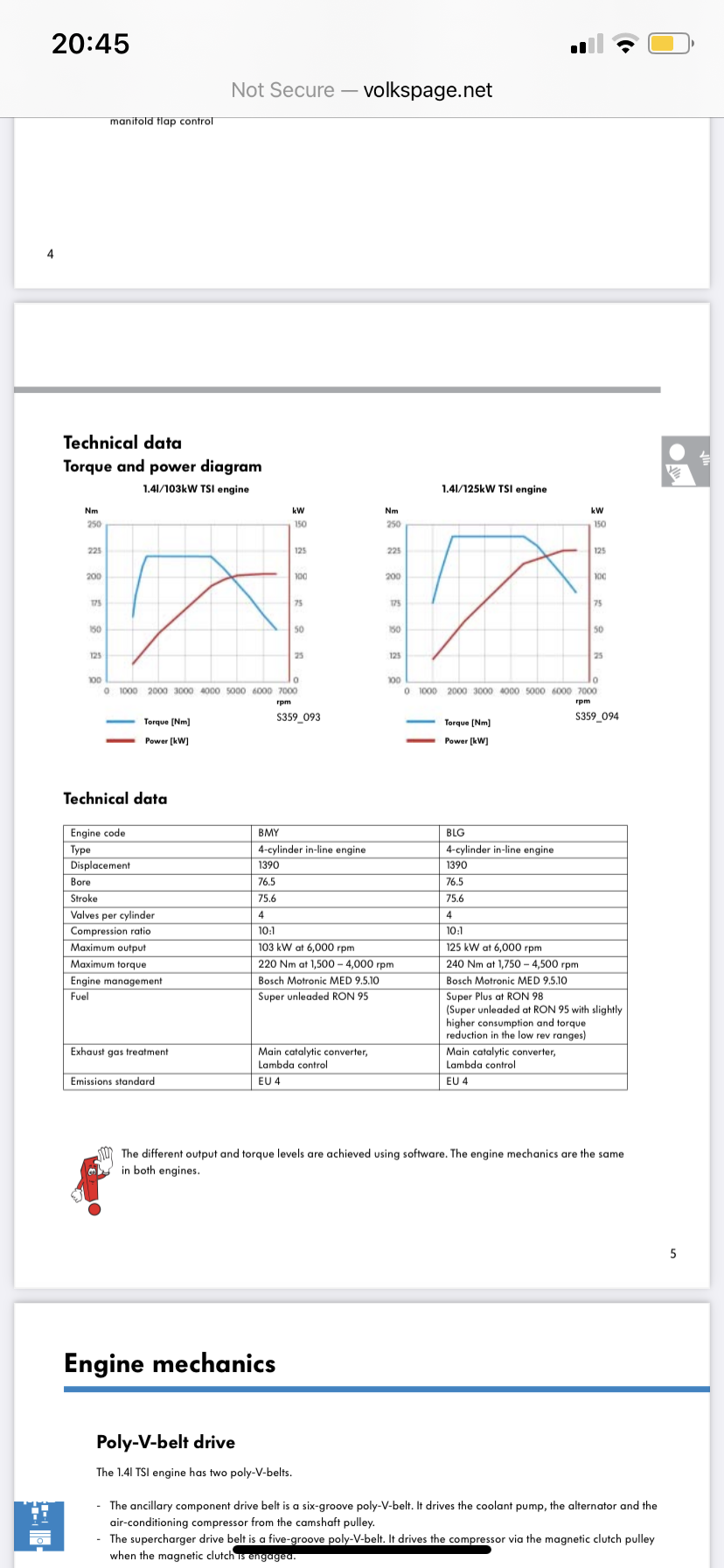

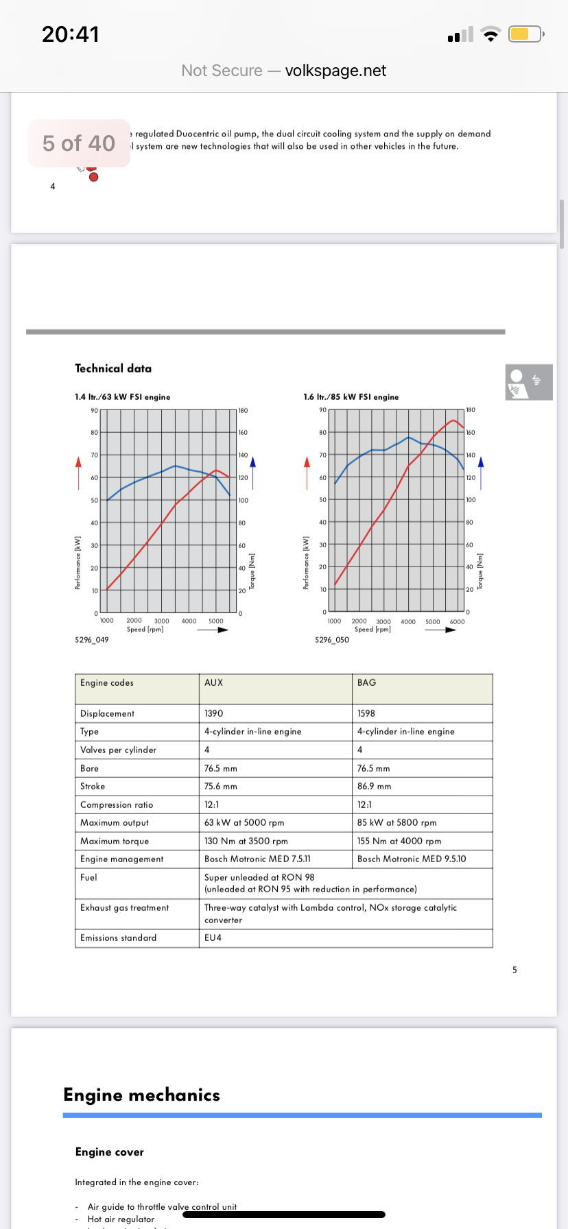

Bit of a technical question here but I’m perplexed how two engines with the exact same piston diameter/ stroke can have such different compression ratio’s (one for N/A one for turbo charging)  which in essence are the exact same engine also doesn’t make sense what does everyone think dished pistons ? 4EC838B0-18F1-4F70-A529-AD00BE78CD3E.thumb.png.7a8f2caf42d51d51d9055fee8c9d1098.png6D67BB92-9F90-446A-A618-6395FAAD6DCB.thumb.png.d7caf2e2ffb96628b47c59c1b447e903.png

Different volumes of combustion chambers in their respective heads?
Nah, it's piston crown, dished or flat for turbos, raised for N/A, 4V pent roof chambers on modern cylinder heads have no scope for varying the volume.
