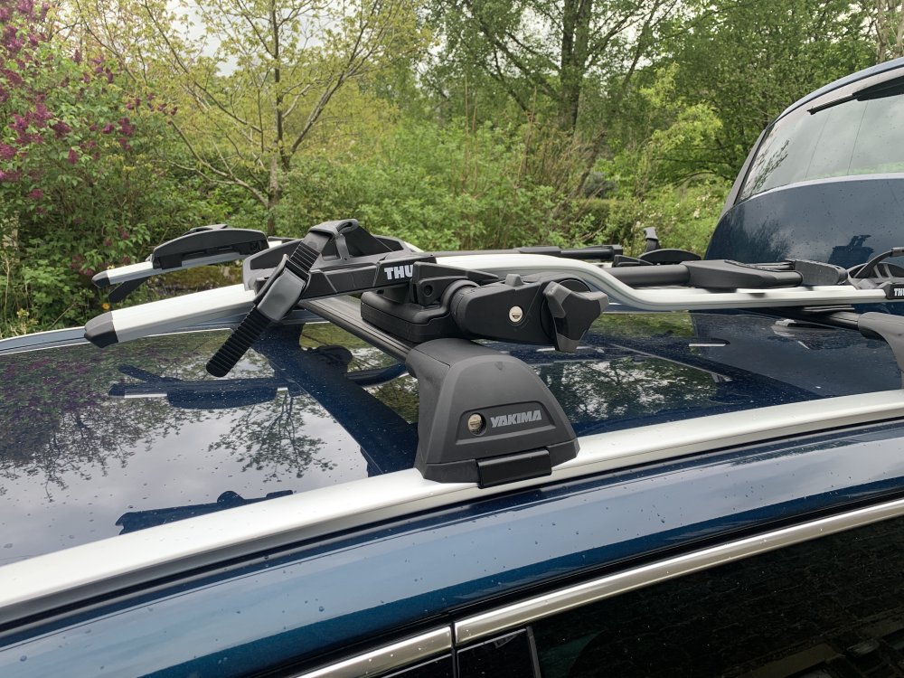

FYI I got some Yakima flush aero bars which are rock solid and look great and are silent if you need to buy some more. I was not impressed with the Skoda bars. They look cheap and clunky.
