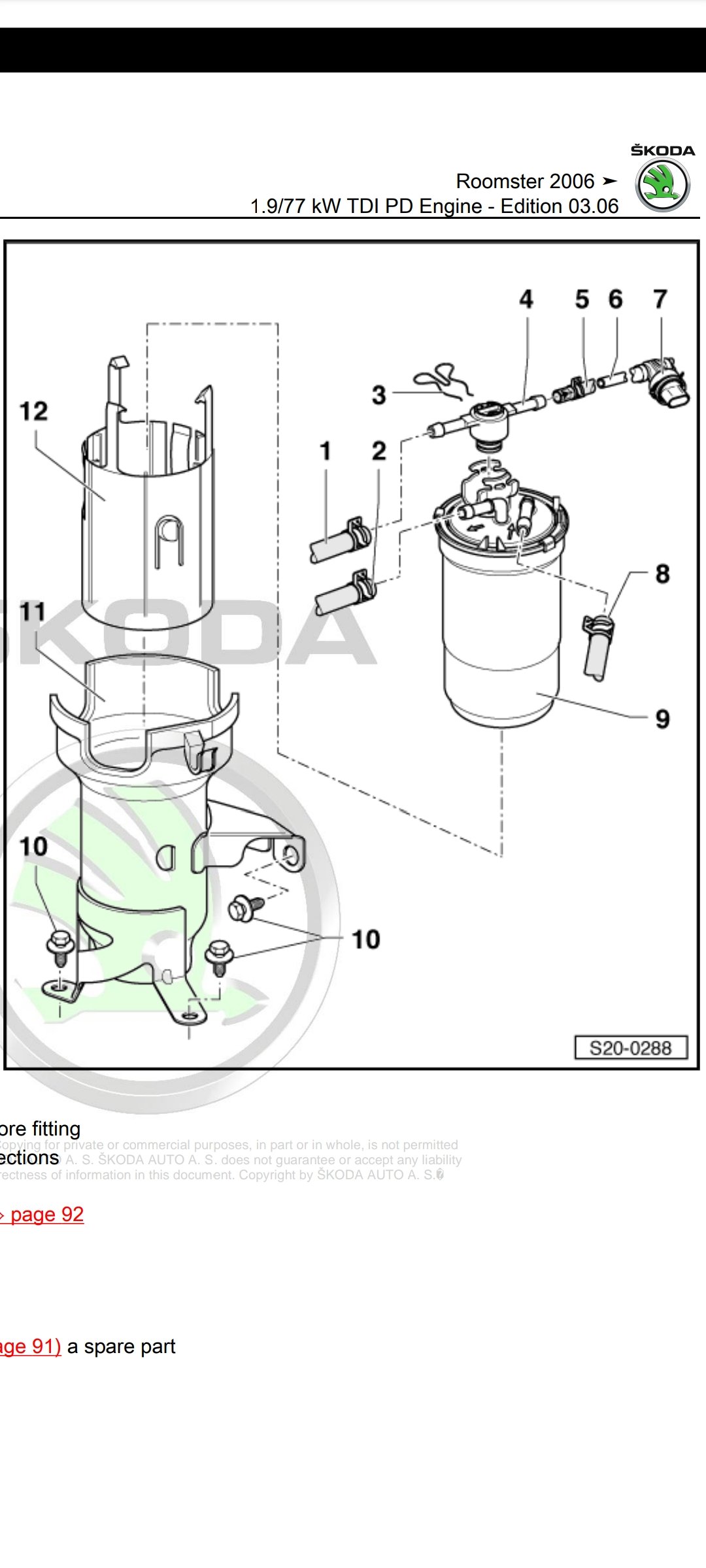

Anyone know how many torque screws hold the filter case in place? i can see 2. if its just the 2 then shouldnt be too bad with an extension on my ratchet. looks like a T45?

It might be 3 to remove.

Yes did it this morning. had to undo 2 nuts that held water bottle so i could release and get to the 3 bolts that held the fuel filter case and hold everything out the way with a bar rather than disconnect. Horrendous design and you will need T45 bits Thanks all for your input much appreciated
