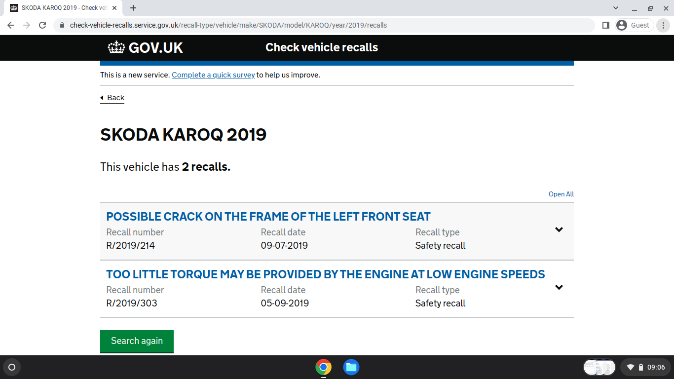

If it was one of the vehicles that was part of the Service Campaign to have the software update applied then that should have been done.
That can be checked.
The Service History, Warranty History & any Recall Action / Service Campaign history in the first 3 years should be on the Skoda System that a Main Dealer can access for you.

Vehicles that are part of the Voluntary Recall Action are part of what the DVLA have as a Safety Recall and Registered Keepers should have been contacted and any car Sold through the  VW Dealership network should have had the Software Update or updates, and any vehicle serviced at a Main Dealership should have meant the Owner Keeper was made aware of the available Update and to keep a Warranty Valid they may want to have it done.
