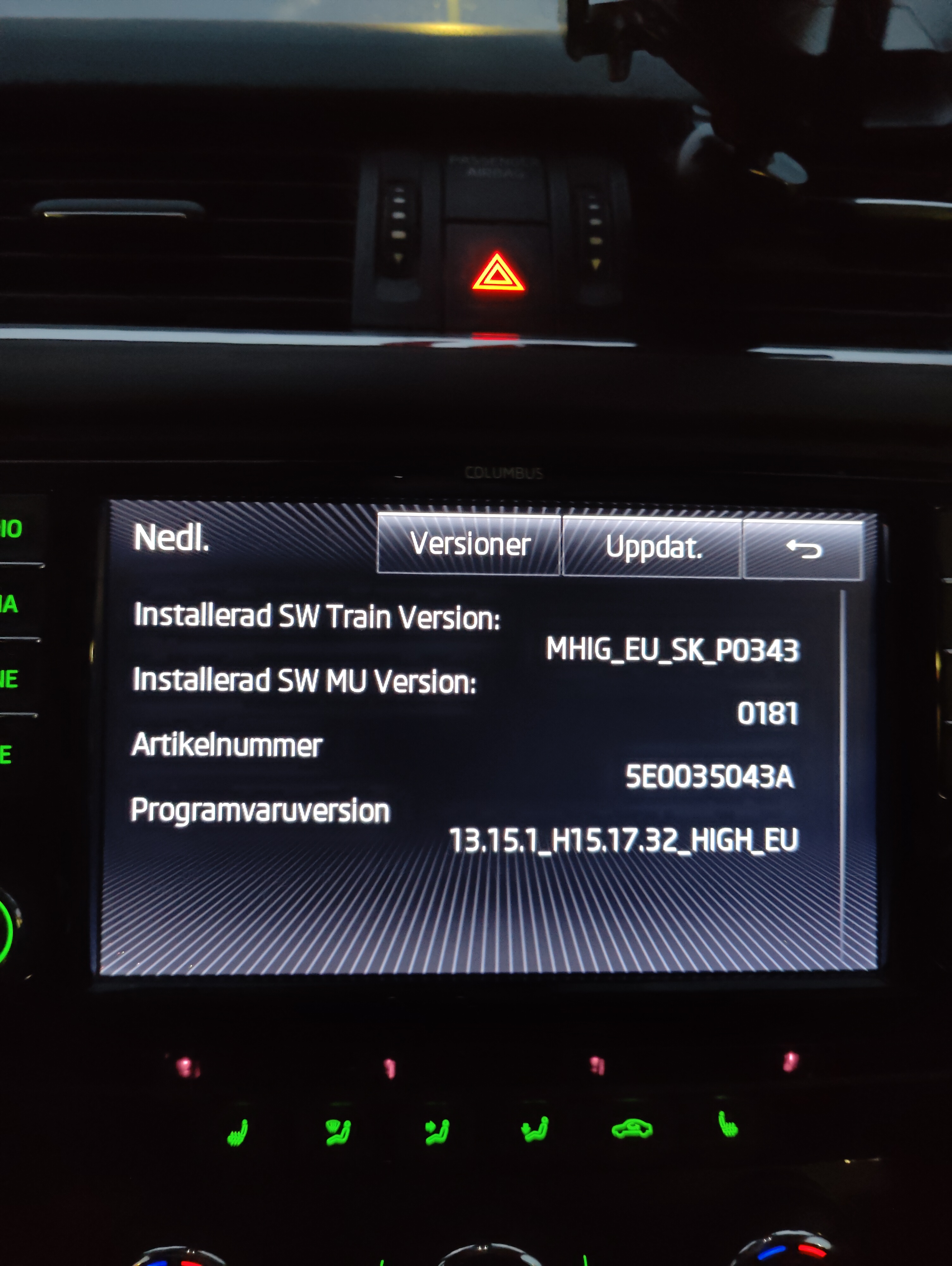

How would I go about updating my system? Attaching a picture of the current version.
This firmware is availble for if/when you need it.
SW Train: MHIG_EU_SK_K1552
MU Version: 0411
SupportedTrains = "MHIG_EU_SK_P0069*, MHIG_EU_SK_P0071*, MHIG_EU_SK_P0343*, MHIG_EU_SK_P0346*, MHIG_EU_SK_K0346*, MHIG_EU_SK_P1055*, MHIG_EU_SK_P1533*, MHIG_EU_SK_P1537*, MHIG_EU_SK_K1541*, MHIG_EU_SK_K1551*, MHIG_EU_SK_K1552*, MHIG_RW_SK_P0069*, MHIG_RW_SK_P0071*, MHIG_RW_SK_P0343*, MHIG_RW_SK_P0346*, MHIG_RW_SK_K0346*, MHIG_RW_SK_P1055*, MHIG_RW_SK_P1533*, MHIG_RW_SK_P1537*, MHIG_RW_SK_K1541*, MHIG_RW_SK_K1551*, MHIG_RW_SK_K1552*"
