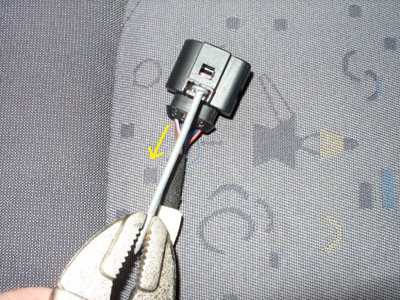

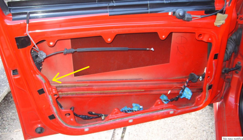

Here's a pic of my passenger front door. The yellow arrow shows where the connector plug is fitted to the lock unit.
To remove the connector plug, push the whole plug upwards to relieve strain on the catch while also pulling the tab downwards to release plug.
Edited by TMB

Thanks TMB, I can see the pictures now, so it must have been my work blocking the image hosting. Thank you so much.
