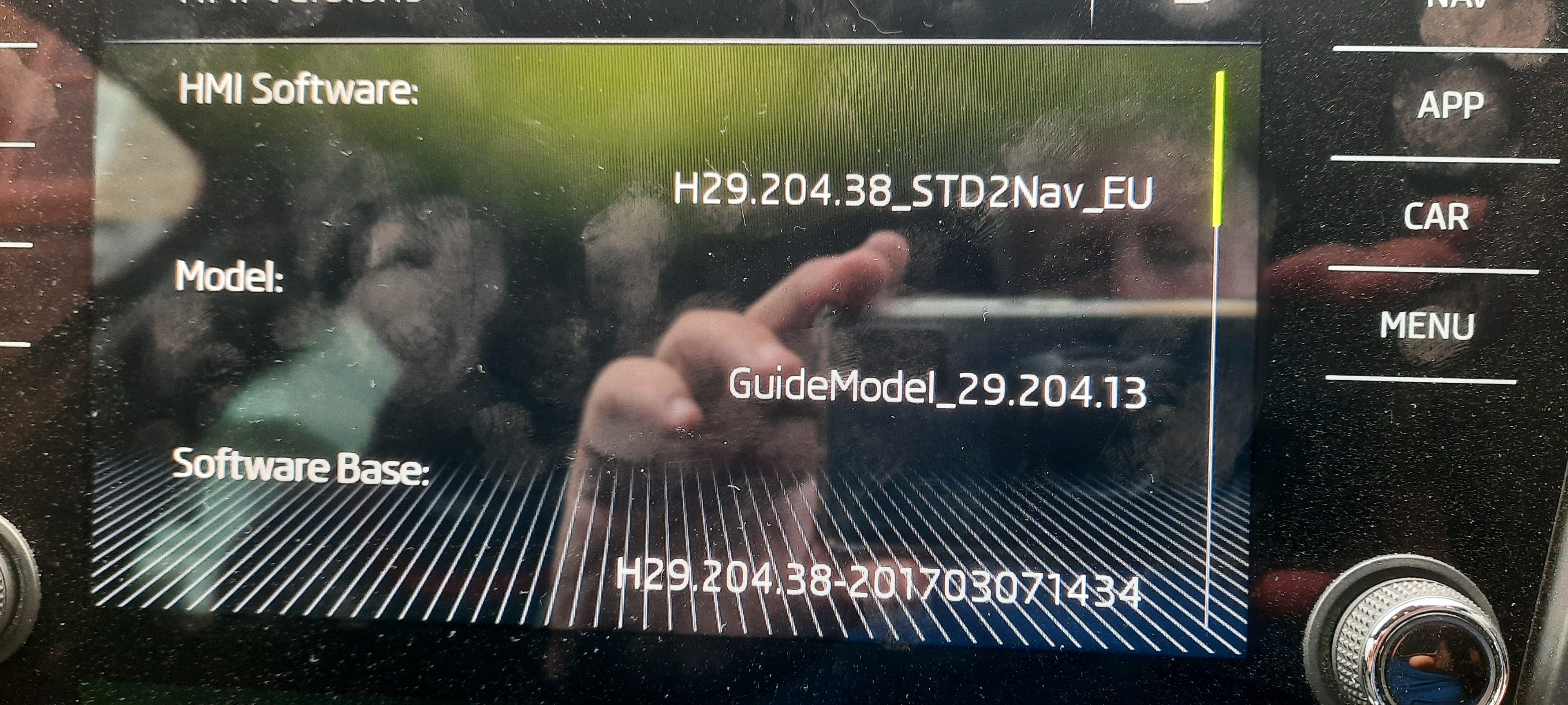

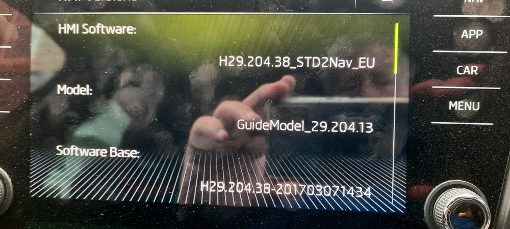

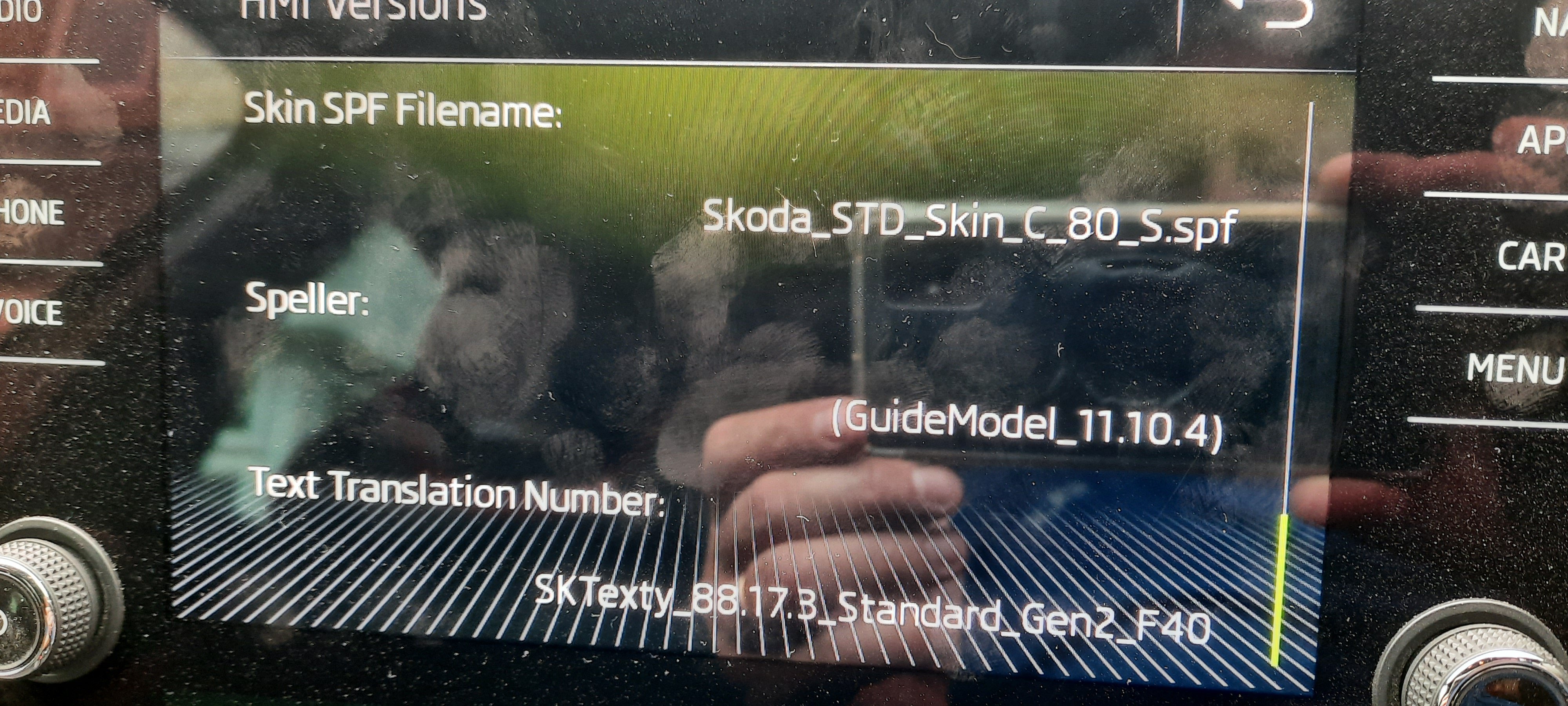

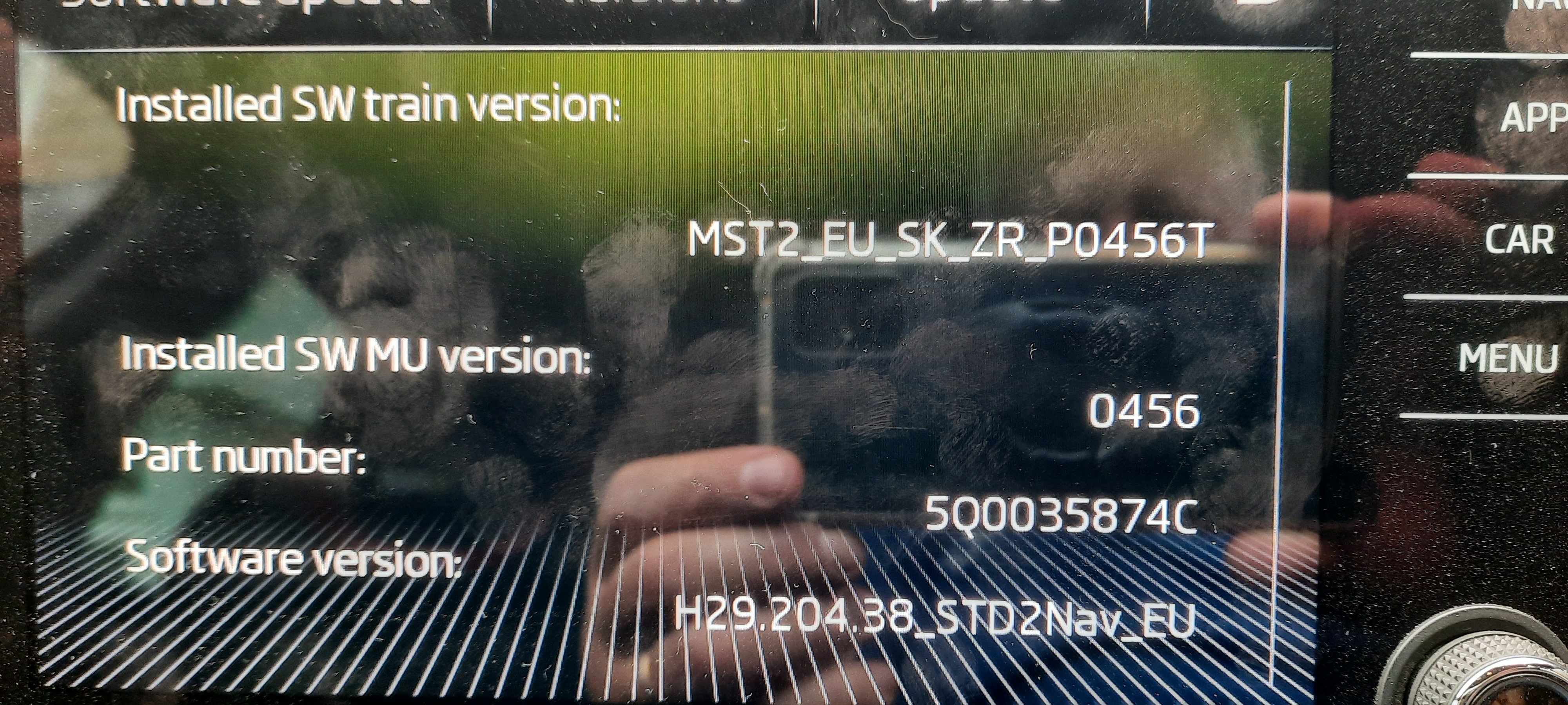

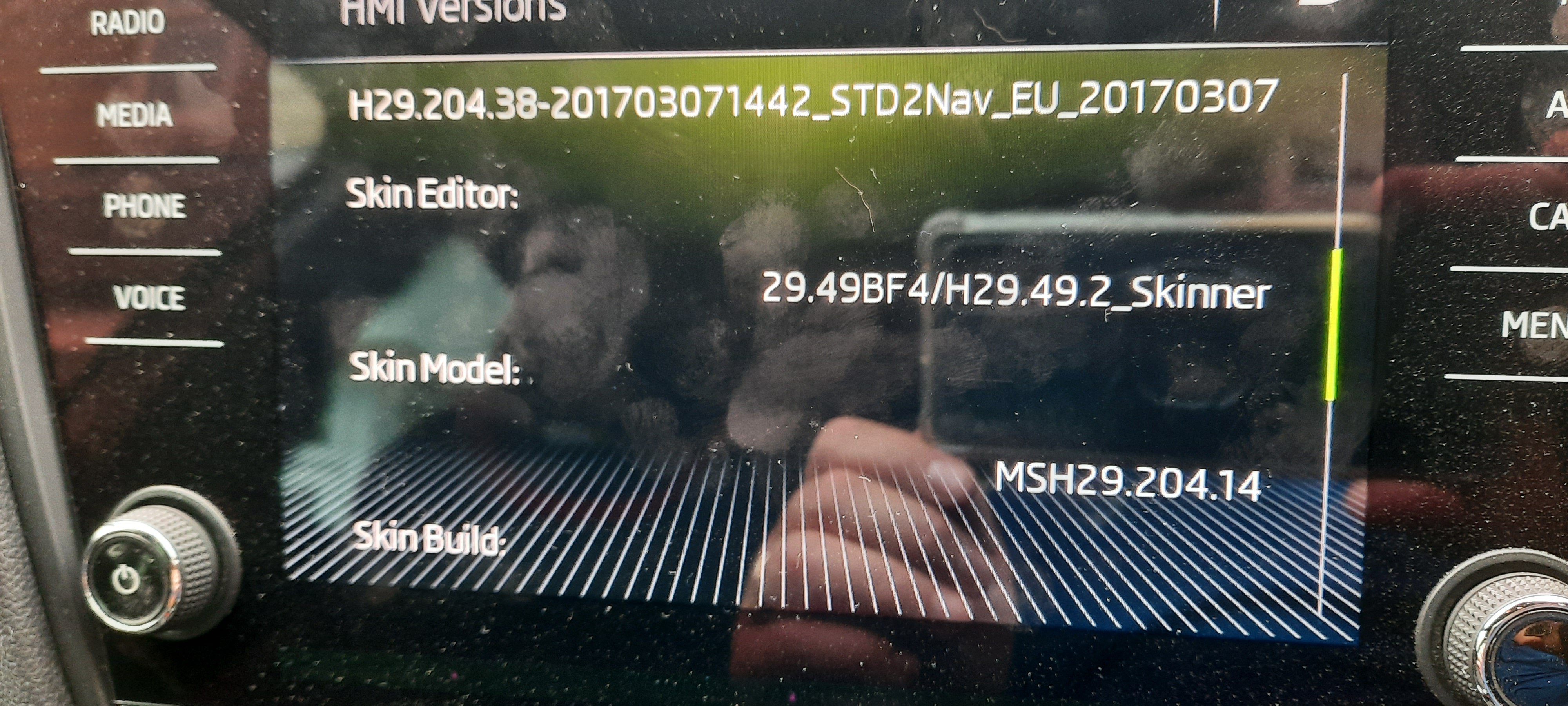

This is your installed firmware 0456, available 0480.
You could update the software, but might not make AA work, never tried myself as just using Bluetooth.
Something I should perhaps try to see if possible.

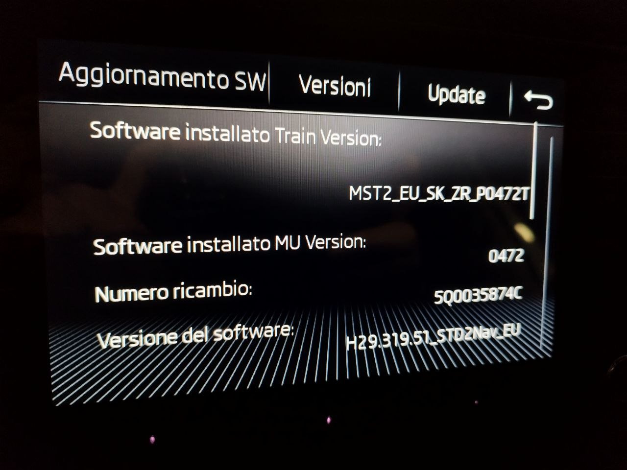

Ciao a tutti, continuate questa discussione, ho un Karoq che monta un Amundsen e vorrei aggiornarlo per vedere se può gestire la connessione wifi senza cavo. Puoi aiutarmi a capirlo?
Grazie

There is an update to 0480, but usually for big fixes.  So don't expect it to fix or add wireless AA.
