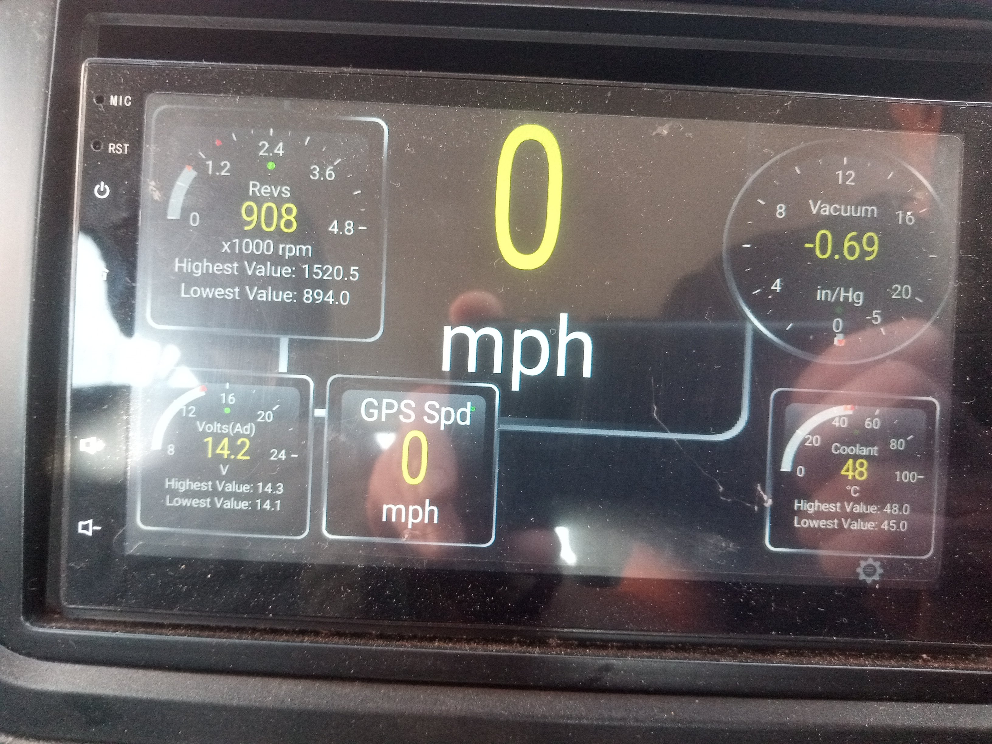

4 hours ago, KenONeill said:
Not sure I'd trust any of those figures.
 Below is screen shot from in my Fabia Greenline but no boost values shown as at tickover, and not prepared to drive and take photo - I was a passenger in the Polo viewing on my phone rather than the Android head unit in my Fabia. The main purpose of the post was to show that boost pressures can be viewed real-time. This may rule out boost issues given that this has occurred after multiple changes all being made at the same time so. Cannot explain over voltage, but the screengrab was taken shortly after starting hence not showing normal operating temp.

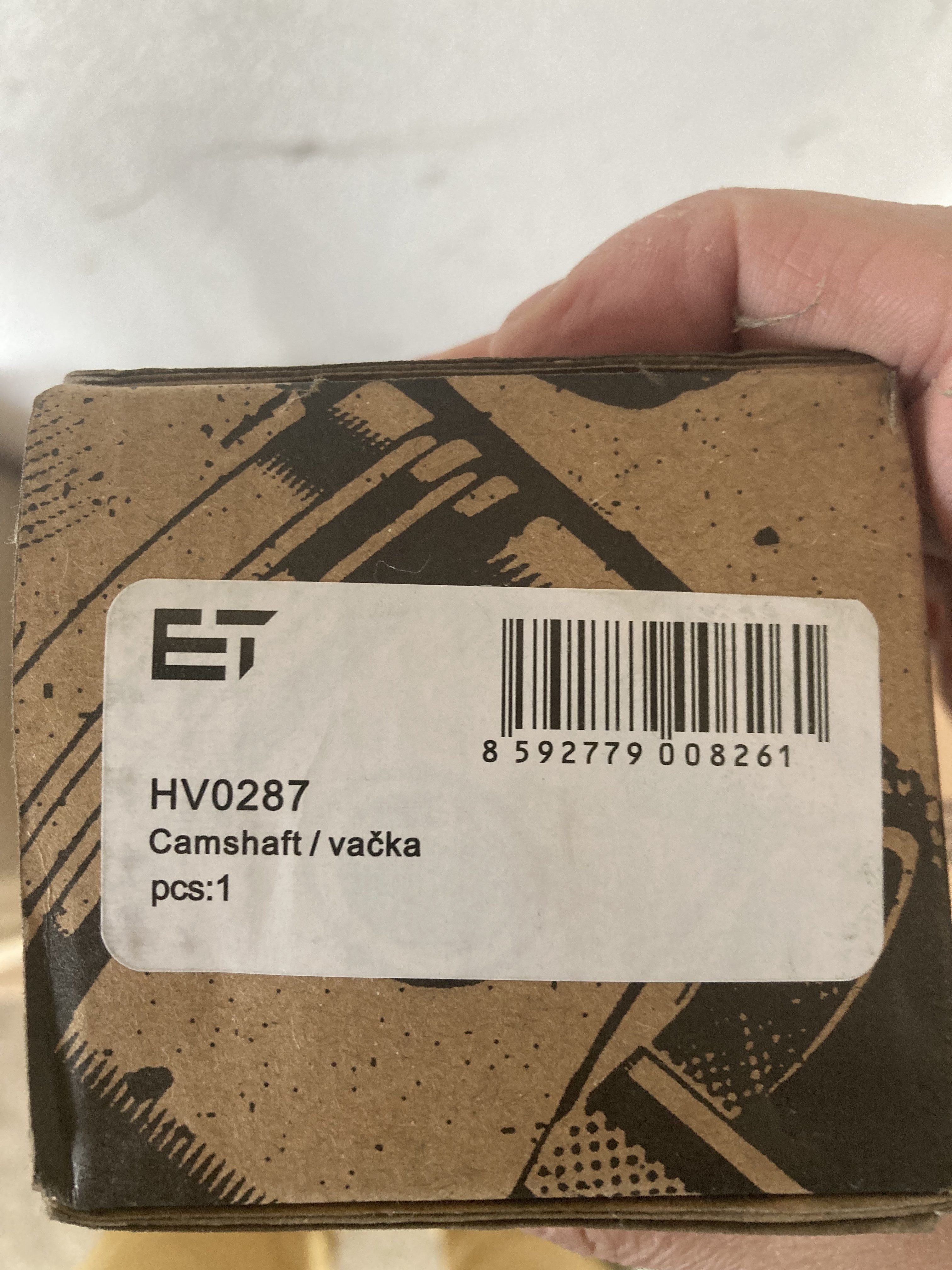

I’m gonna do it. Another tech at another garage suggested changing the camshaft again… 😱 It’s gonna cost me a lot, but lessons learned. Never buy parts yourself… I am still at a loss as to how a car can idle smoothly and start no problems with a bad or wrong camshaft… I bought a complete ET Engineteam camshaft set… I thought all the cams for a 1.9Tdi 8 valves are the same…
They are all the same.
Do you have any physical evidence that the cam is bad? I assume you changed the oil and filter and replaced all the stretch bolts as well.
Take off the rocker cover and carefully inspect the cam and followers for any signs of damage.
I note that they're cheaper cast iron parts and not steel, please check the physical condition of the cam and followers you have fitted, any tiny difference between the parts will not produce the symptoms you are experiencing.
Well, my set doesn’t list Fabia at all.. The followers are Kobelsmith, but I guess 1.9Tdi camshafts are not the same after all…  I’ve got this one in my car atm… It probably isn’t lifting the valves fully and hence the loss of power with full tutbo boost…
And I need HV0338. The ET cam that I bought is far better quality than the one in the link Breezy sent…
