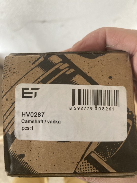

Sorry, skipped the post… So if I understood correctly, there are differences between various 1.9Tdi camshafts, but the differences are so negligible that I wouldn’t be able to see them… and impossible to experience loss of power because of them, right? But being aftermarket, this particular cam may be out of spec and giving me a headache?! Didn’t know you had so much experience… You are literally the only person who told me that the car may be slower because of the egr delete…
BLT sets the CEL when the EGR is missing or not working, ASZ does not. I don't know for certain if the ECU limits power with a lit CEL but given your symptoms I think it's likely, what you describe is exactly like limp home mode, especially since the car starts and idles well. You say it's boosting but you might be looking at requested rather than actual and it won't boost at all while stationary so you need to be driving it before you log a pull.

Before I removed the EGR, It was giving me a check engine light but I haven’t experienced any power loss with the light on. I am hesitant to map it out now, because that would introduce the third modification into the puzzle if it didn’t work. What I have changed so far is deleted Egr and changed the camshaft… The most logical assumption is that this cam is causing the issue… I don’t know… The mechanic recommends that we change the cam again, and do it by the oem part number on the original cam…

And just did a bit of research. All the TDI PD 8v camshafts appear to be the same. The only difference is the alloy, slightly different and stronger for engines with DPF. So my issue isn’t cam related, although it manifested itself after the cam change… The first thing I’m gonna try next week is map out the DPF, and I am positive it’s not gonna do any good… Jesus, it’s like I am fixing a Tesla. Crazy…

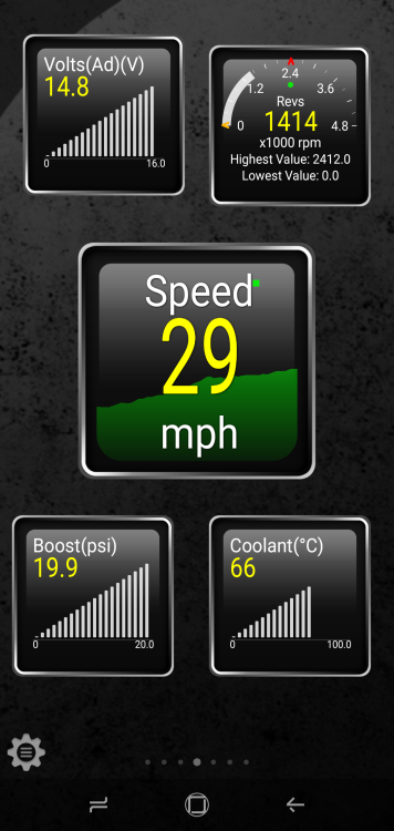

You need to log boost while doing a full pull, requested and actual, you're not getting enough AIR to go with all that fuel you're wasting which rules out the injectors somewhat.

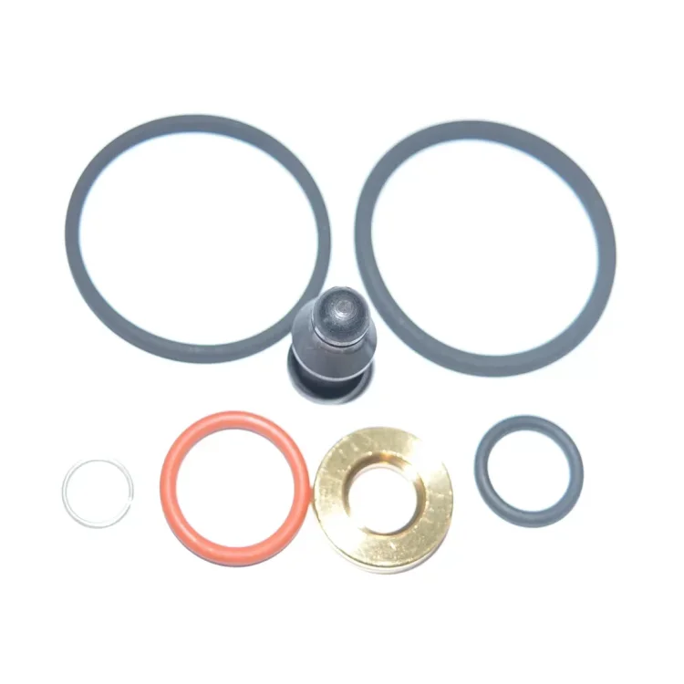

Ok. Got it… What about testing the injectors with the spare AL ARL injectors? Swap and see what happens…I have a slight misfire, tractor sound… The mechanic has used an injector kit like this so I suspect he has done something wrong…
You state boost showing good in VCDS, is this required or actual, a screen dump may assist knowledgeable people assist as we have never actually seen any data to back up your statements - are you reading it correctly. Also suggest reading the following posts, the 1st is factual info on an issue, with the 2nd being how to collect and share even more valid data :-

Thanks for the replies. I just saw that actual turbo boost value was almost 2.5bar, third gear full throttle…The car is like trying its best and then when the turbo should really pull I can hear a sound of air huhhuhuuuh and a faint squeal from the turbo…. It’s boosting well, the turbo is in great condition, but all that psi is going nowhere….I don’t think the mechanic did any logs… Sry guys, I am not a mechanic and I don’t have access to equipment… All I can do is listen to you and see what you think, give a mechanic a hint…
