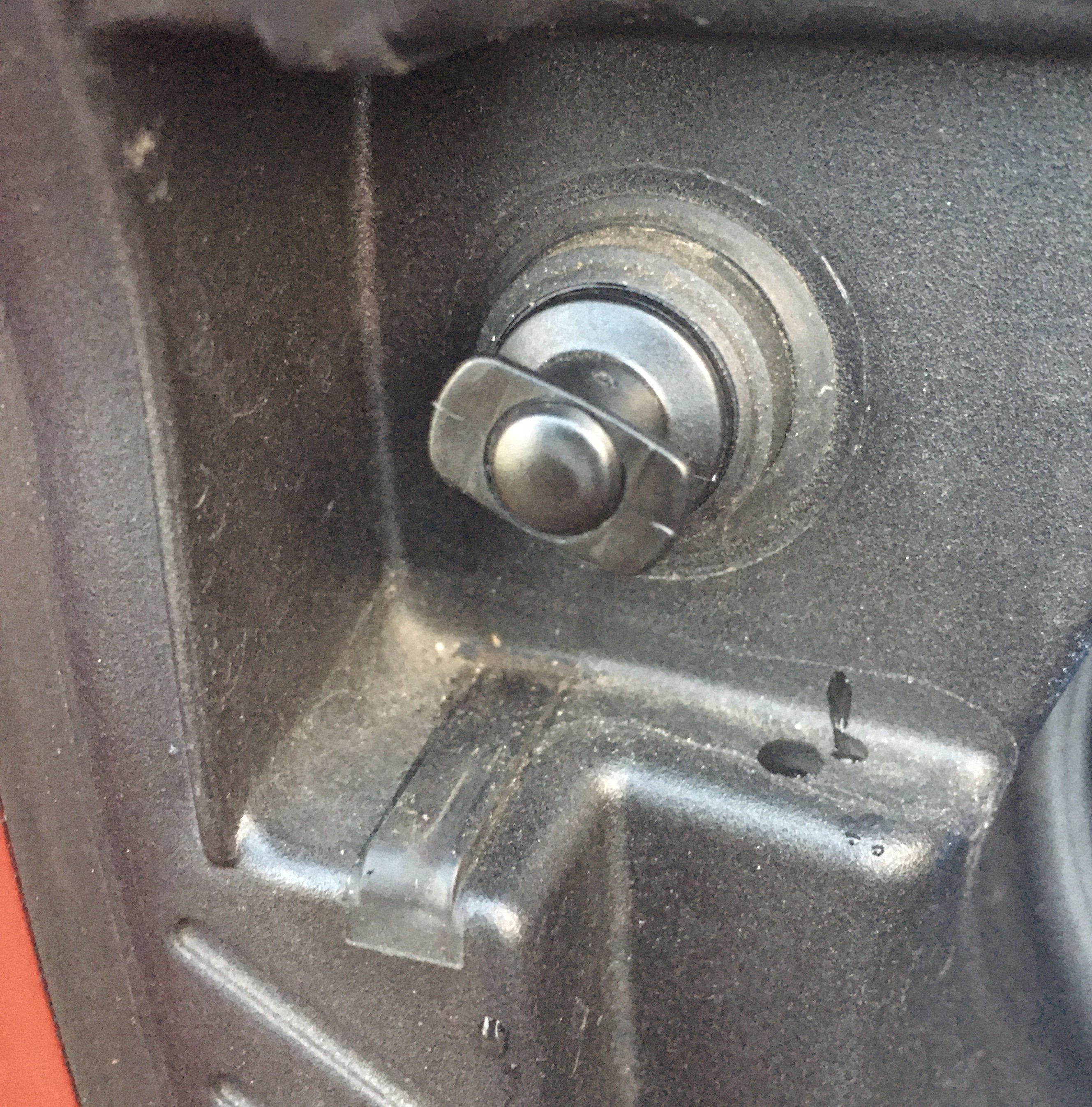

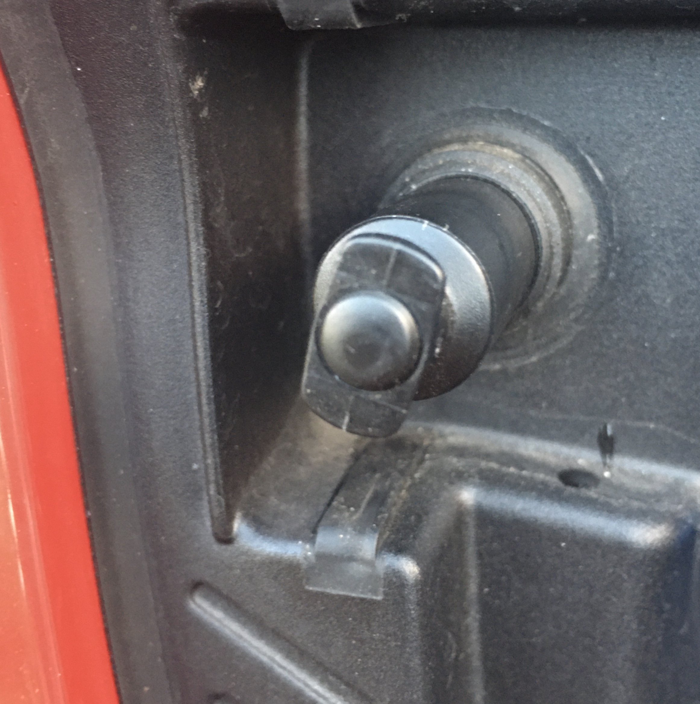

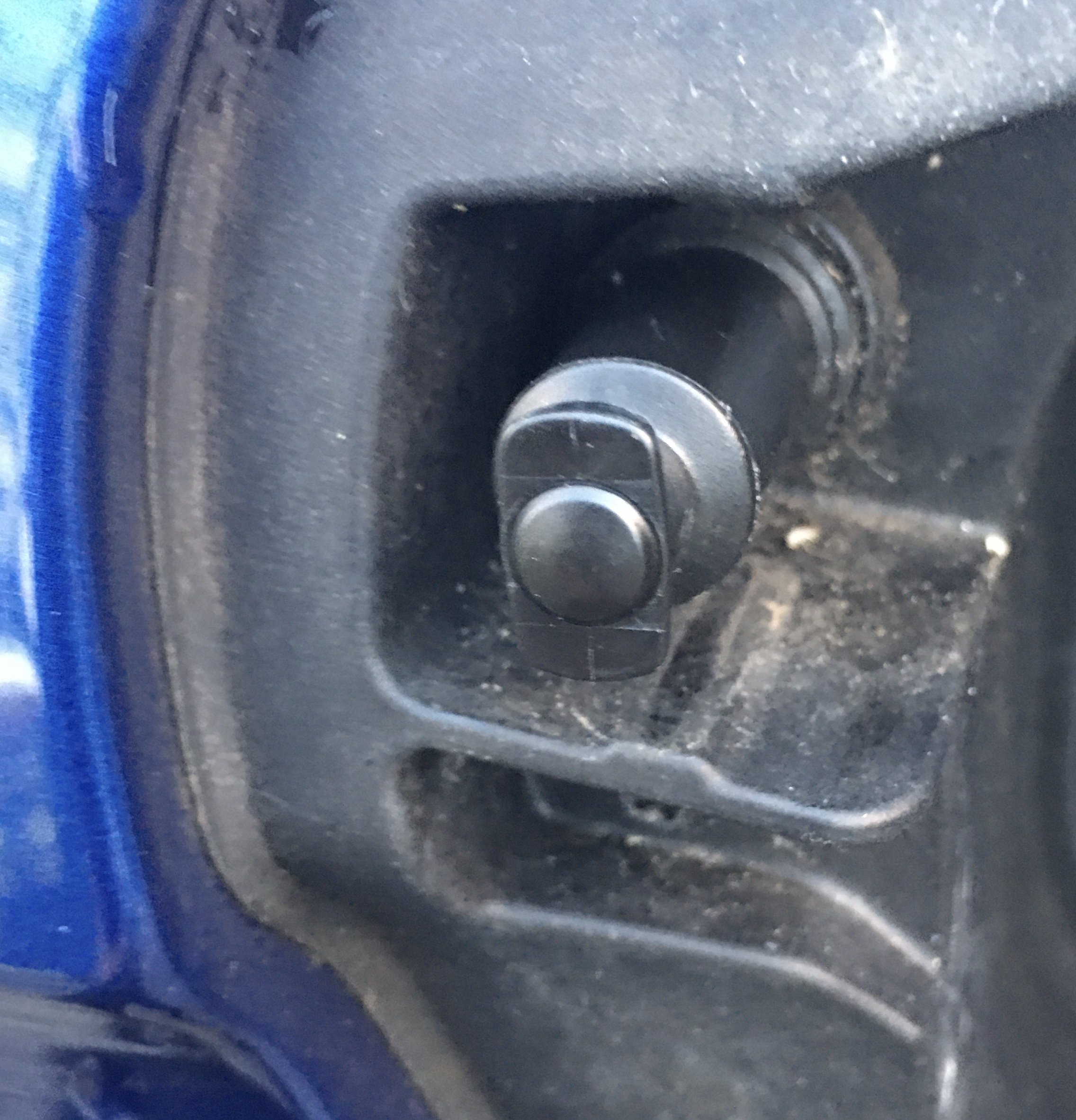

I think VAG cars all work the same way. We have 2.
There’s a solenoid hidden in the rear panel. Not very accessible. And quite ££££
It clicks in and out and turns the locking “key” 90 degrees.

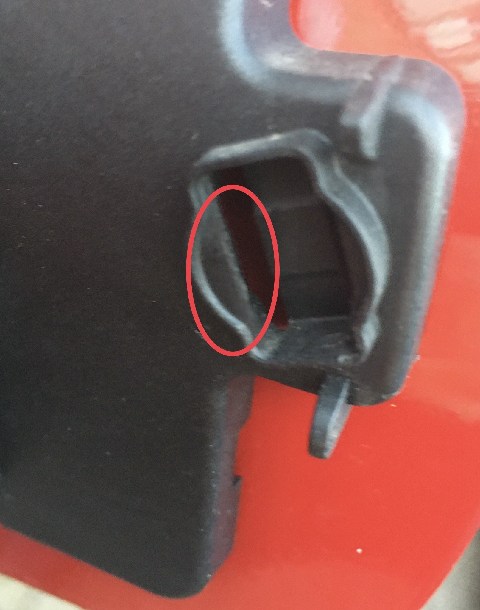

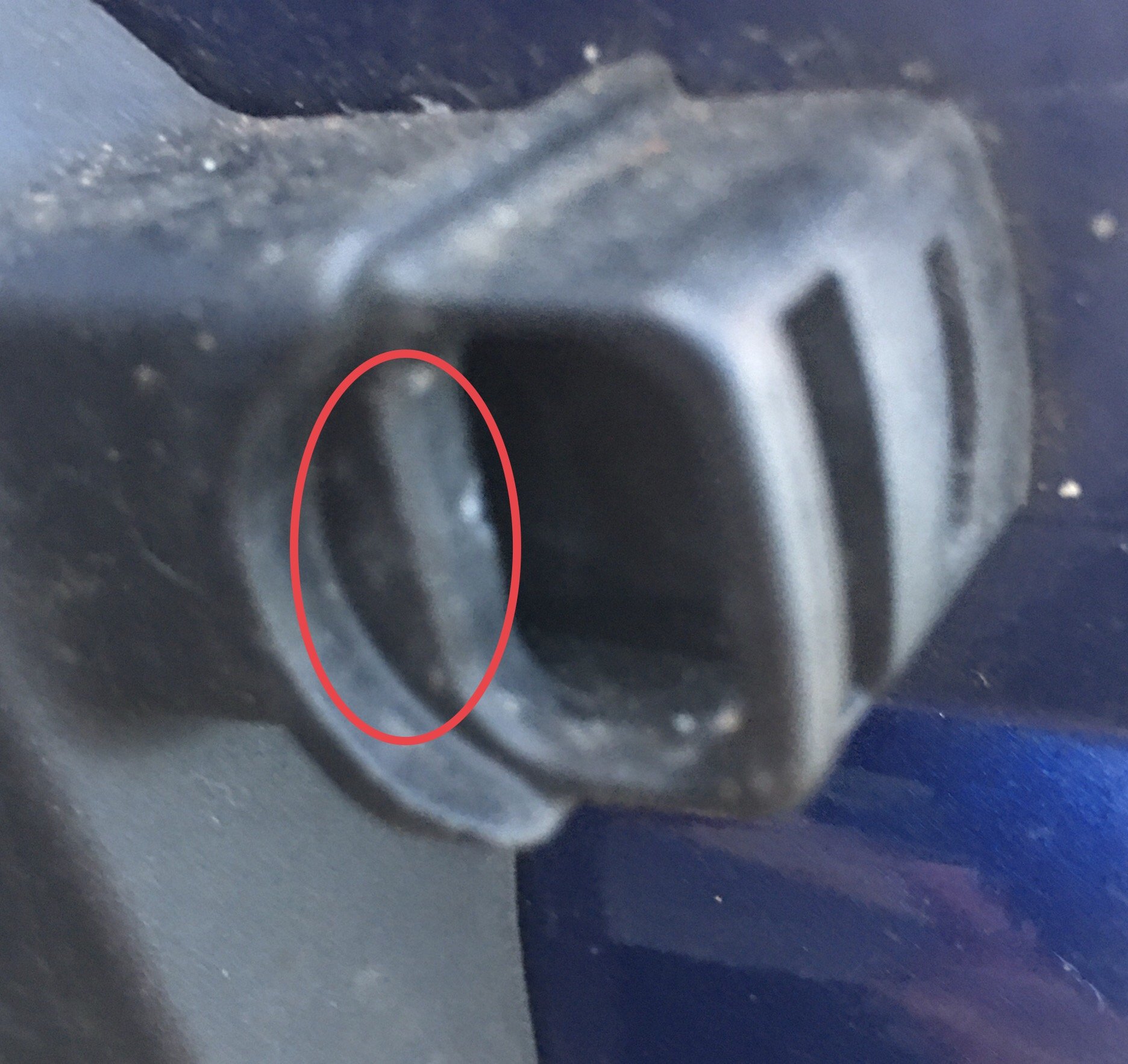

The oblong head of the key locks behind a very small piece of the lid.
Circled in the photos.
A few minutes with the appropriate tools can remove a small piece of plastic. And the flap will never lock again whether the solenoid is working or not.
Option B - that I haven’t tried - would be to cut the head off the moving solenoid pin. That seems more brutal.
