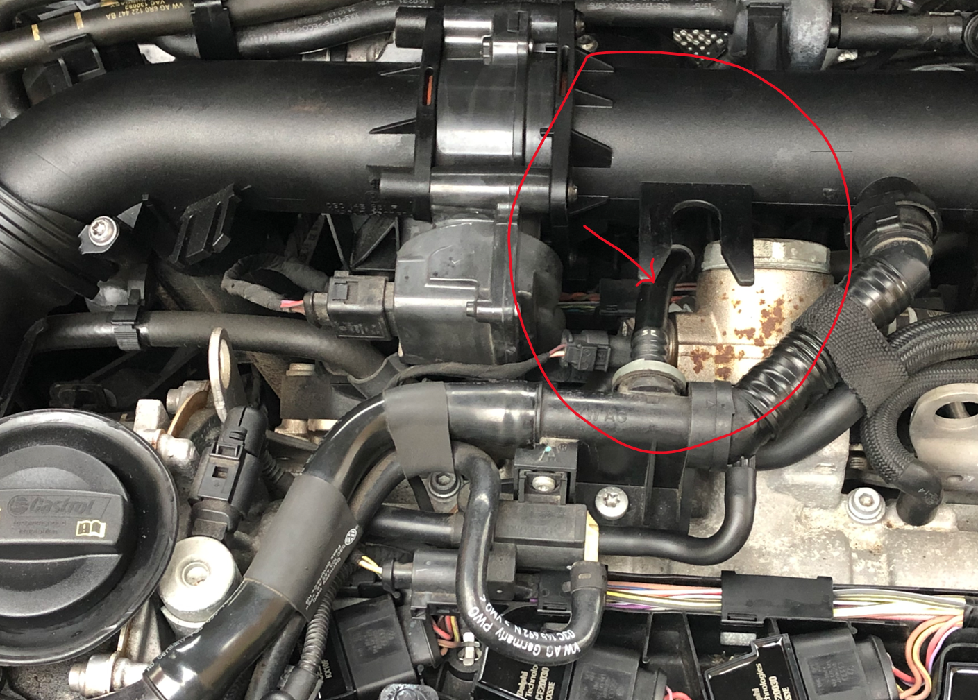

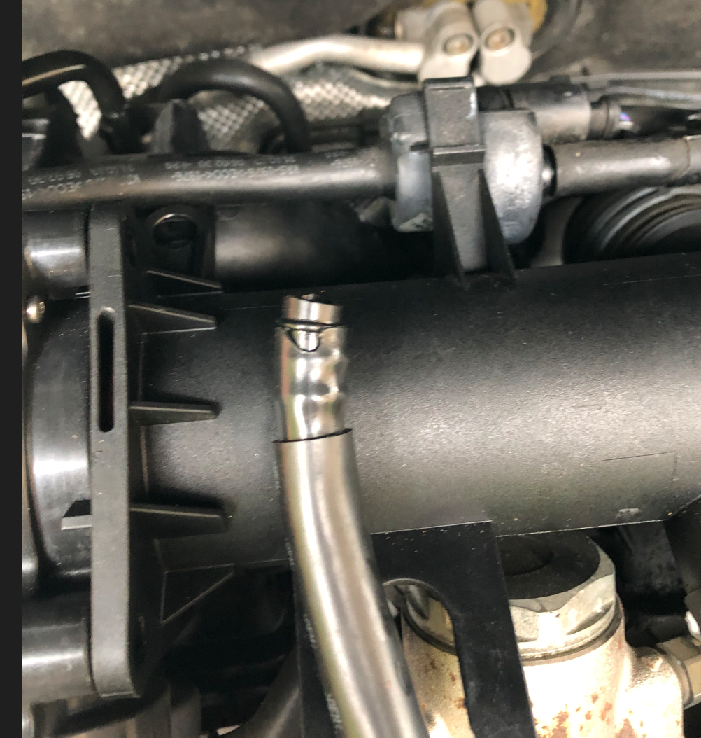

 Not much listed for the 1.4 vrs? I'm after the connecting pipe between PCV valve and rear assembly, for some reason its damaged (dealer replaced spark plugs 4 weeks ago !!! I was wondering why error 40501 was showing (Leak in Air intake system), The unseen end has damage (see second image) and is not sealing correctly

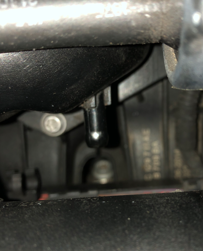

Actually, looking at your second image, it appears that the hose is OK, but the plastic nipple it attaches to has broken off inside it?
What is/was that nipple part of?
@Breezy_Pete
It goes onto a rear assembly, the attachment point seems fine of it has a tube with a spherical swelling
I believe the end of the smaller pipe has had its push fit fitting damaged and is missing and it was relying on grommet 8A to maintain the seal integrity

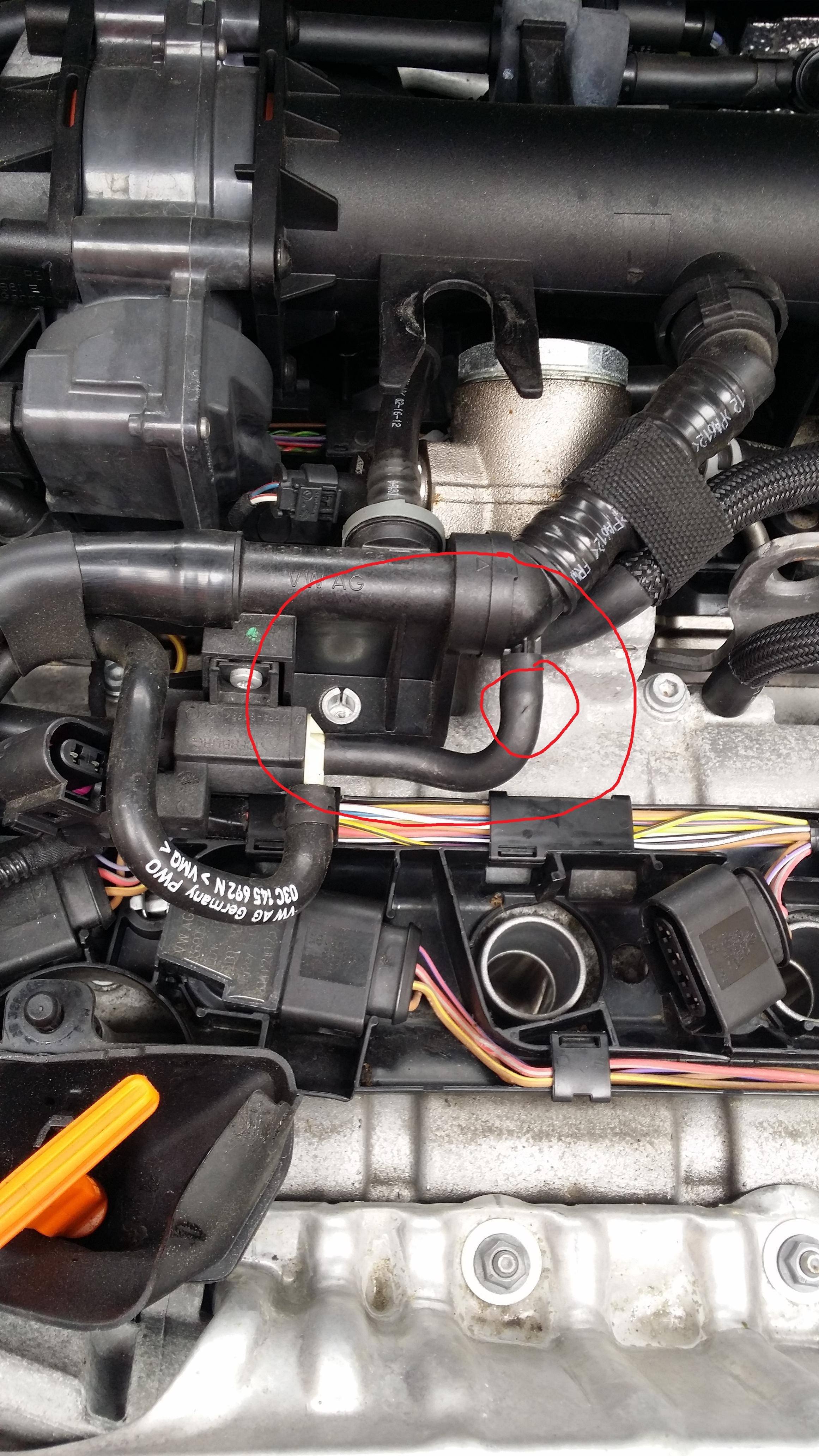

Hmm, I wonder if the broken off piece is part of an adaptor, the rest having hit the road or undertray. The parts diagram refers to an 8A item that isn't listed in the table, but might be the last '8' - 03c103638b
One of the google images for that number could possibly be some of what's stuck in yours.
I believe you are correct with the part number but can't find it anywhere and it will still be no good without the correct pipe and push fitting, so Ill look for a correct pipe assembly, LLL parts list it for the beetle and golf
  • Sponsor
A bit of warm air might be all you need to get the remnants of the old grommet out?  £6.41 plus a bit of postage from lll, or about the same from a Skoda dealer for the grommet, gotta be worth trying, no? Whole item 8 assembly appears to be £82 by comparison.
The left hand (D/S) termination of my hose is an O ring unit held in place by a torx screw not a push fit ??
  • Sponsor
Diagrams in ETKA are often mildly misleading/overgeneralised, if that's what you're looking at?
