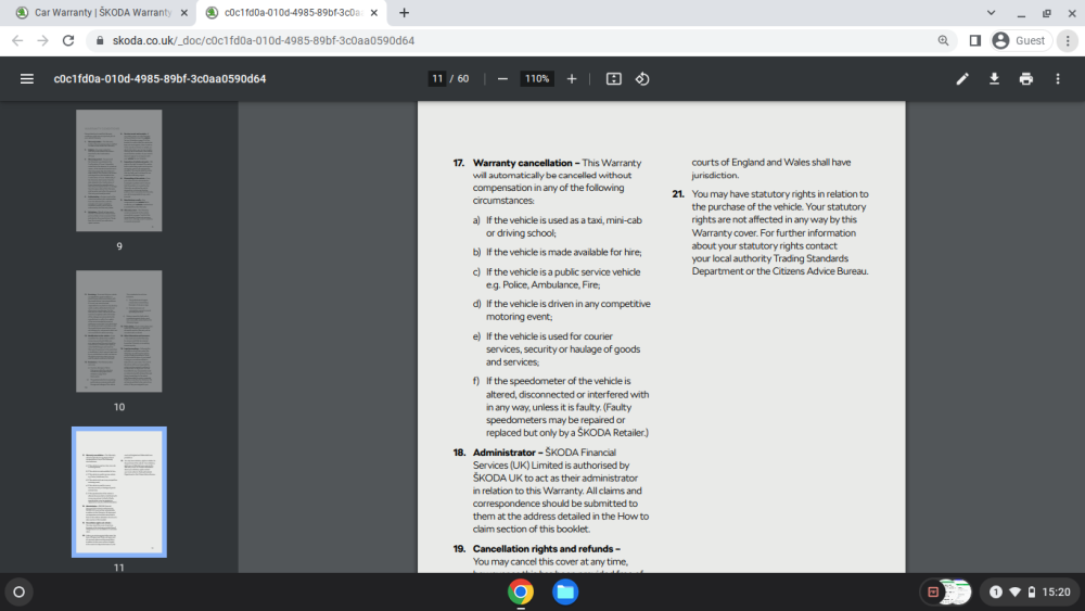

@Aakayamy Was this a Skoda Approved Used car with a Warranty you bought?
The T&C's there will need to exclude, Taxis, Private Hire, Couriers etc.
  • The Skoda Aprroved Extended Warranty with Car Care ltd used to and i used to warn buyers of that to read the T&C's.
EDIT.
Sadly you are stuffed there.   Unless you told the place you bought it from's salesperson that it was a Taxi you were buying it to use as.
But then a verbal is not worth the paper not written on.
Exclusions.

But, as roottoot mentioned, did you tell them it was going to be used as a taxi?
Yes I mentioned I was going to use the Skoda Octavia as a private hire taxi.
