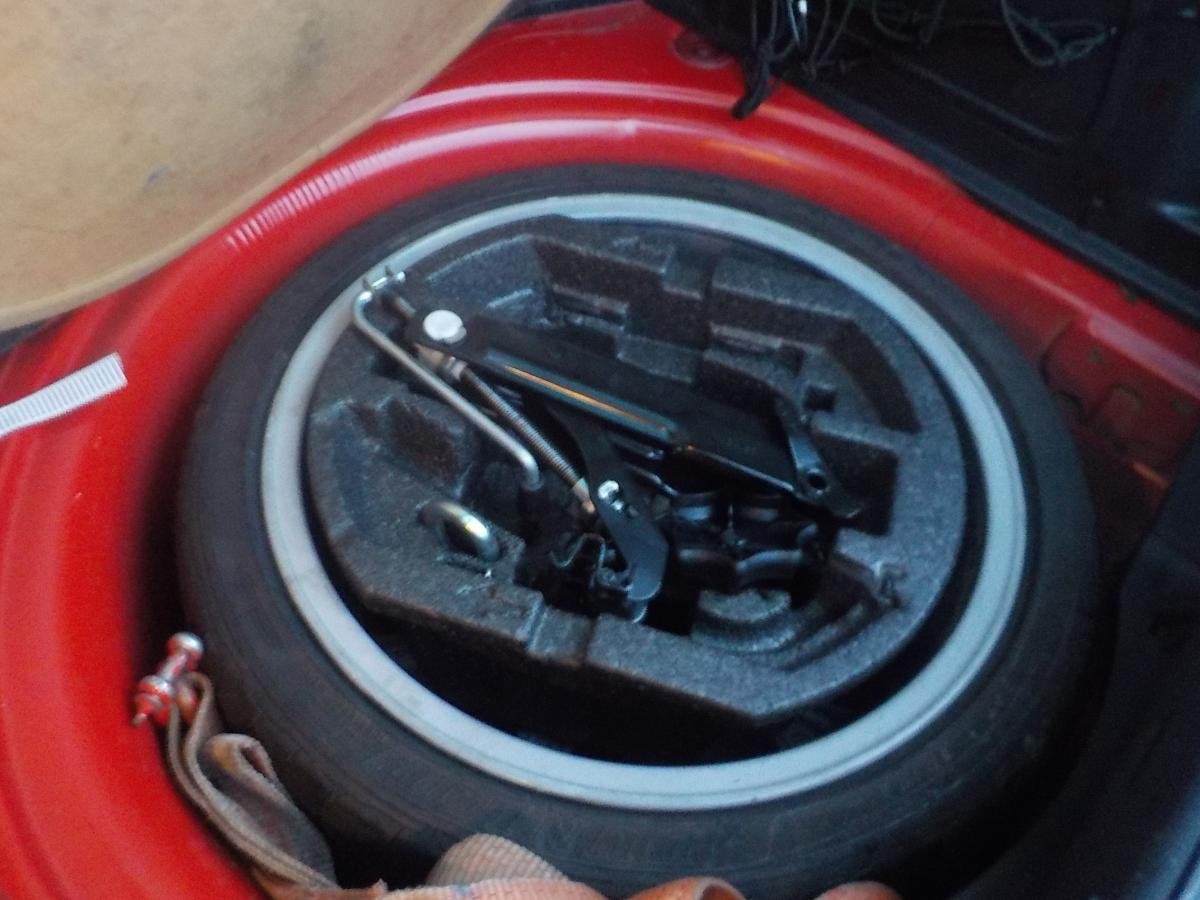

The OEM Spare wheels for a Mk2 Fabia fit in the spare tyre well. 185/60 R 15 or 195/55 R 15.
A 17" Gigaro with a 205/40 R 17 or even a 215/40 R 17 fits in.
Edited by roottoot

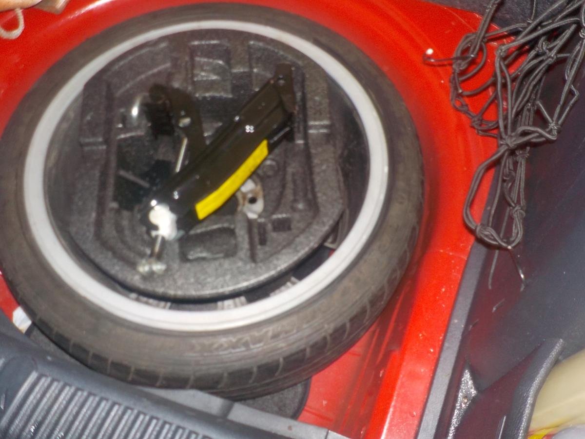

The 185/60 R 15 spare sitting in the spare tyre well of a Mk2 vRS which comes as standard with 205/40 R 17 tyres.
Edited by roottoot
