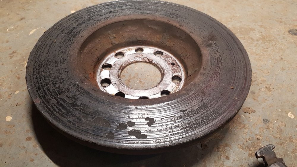

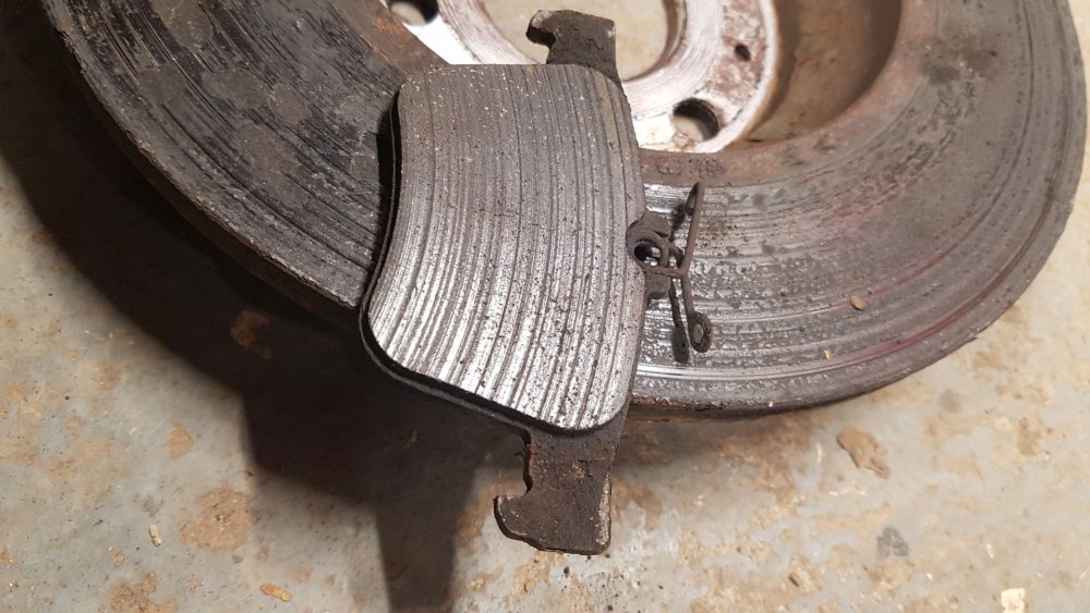

The other irritation (though I can't really blame a Chinese mobile phone company for that), was that three of the four rear pads had a good 10,000 miles left on them.  They were about 5mm thick.  However, the inner pad on the driver's side, was down to about 1.5mm.  Originally, I thought I might have had seized caliper slides, but they were fine.  The inside surface of the disc was truly appalling!  Not only ridges (which I can live with), but lumps missing out of the surface, which were just "milling" the pad material away!  5 years and just 36,000 miles, and it looks like this!
Was that not making any noise under braking? Thats pretty horrendous but not unual for 5 years, especially at low mileage
No, none whatsoever!  OK, the rear brakes don't do that much, but I was genuinely surprised.  There's a very small amount of judder, but that's from the front brakes - which I've also just replaced.
