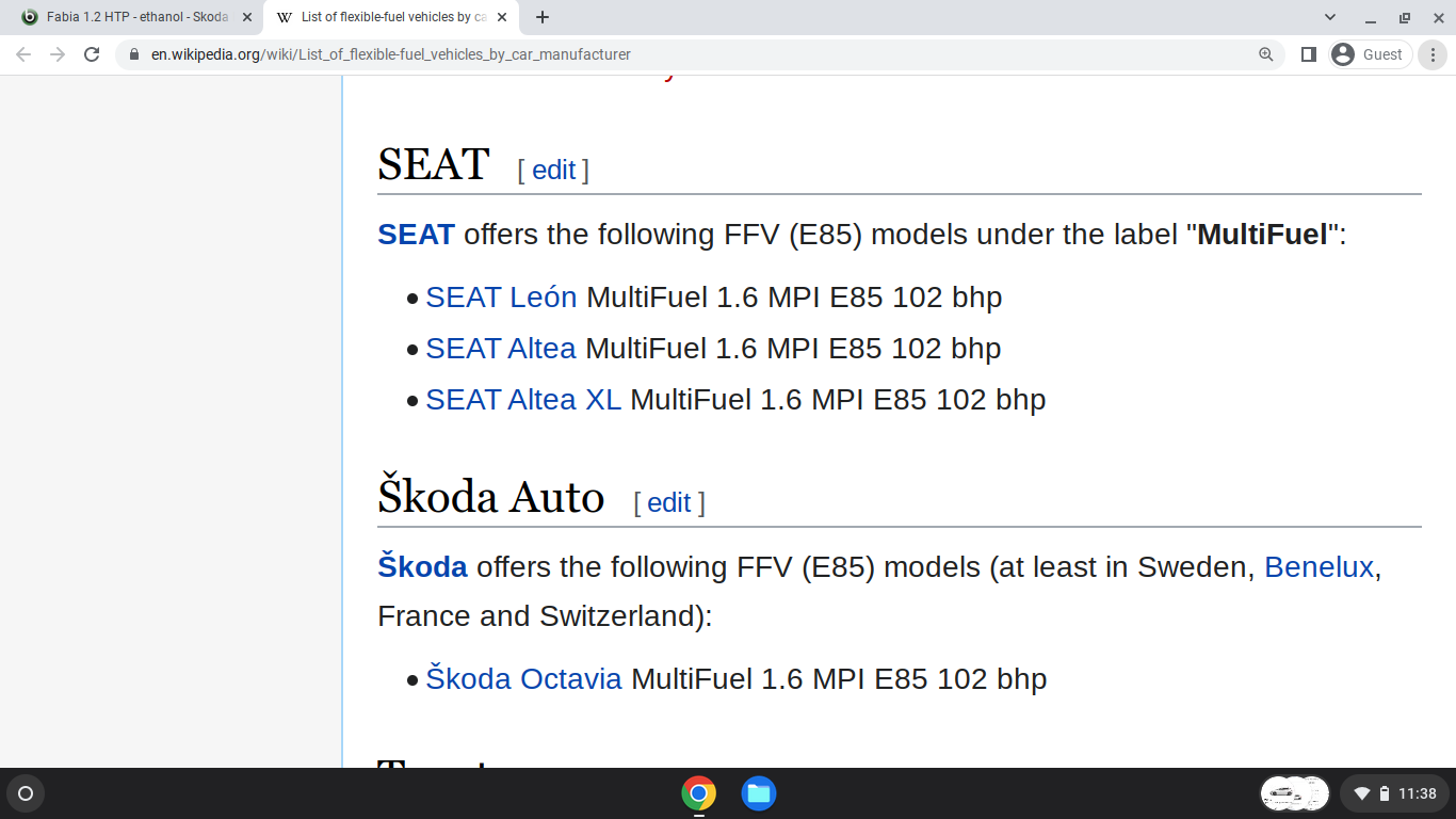

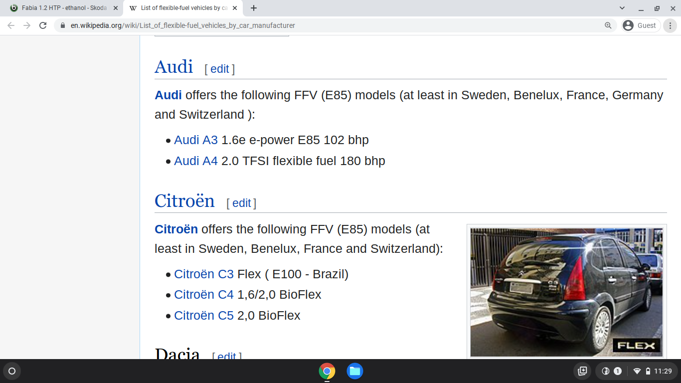

http://en.wikipedia.org/wiki/List_of_flexible-fuel_vehicles_by_car_manufacturer
The VW / Skoda UP! / Citigo 1.0 TSI in South America runs on E85.  Engine different as well from Europe where the Citigo never got a 1.0TSI engine just a MPI.
They have a bigger fuel tank in these cars than those in Europe or rest of the world so that they can run E85.
