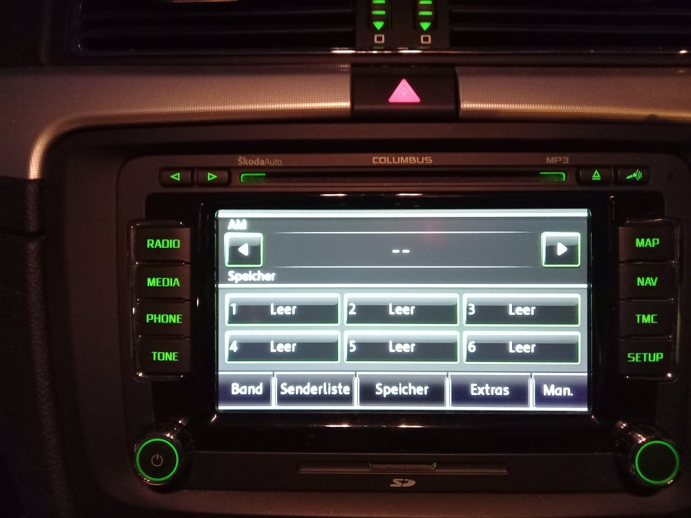

My Columbus has changed into German

Good afternoon all.
I have a very happy update with regard to my Germanic speaking non working head unit.
After being minutes away from handing over £299 on Saturday night I thought I would read this thread again as one last try.
I reached out to Varooom who asked me a couple of current software questions, I had SW 3984, he sent me a link to download and burn to disk.
My IT chap at work did it, my laptop has no drive, rare these days eh.
I installed it earlier, followed his instructions and 54 minutes later it was fully updated and me very very happy indeed, never thought hearing Coldplay would make me smile.
It was still in German,  i changed it back to English easily, everything was still on the HDD, nothing deleted.
So from a write off to a totally free fix, with Varoooms help,  in less than 24 hours.
Thank you Varooom and to all that have advised.
