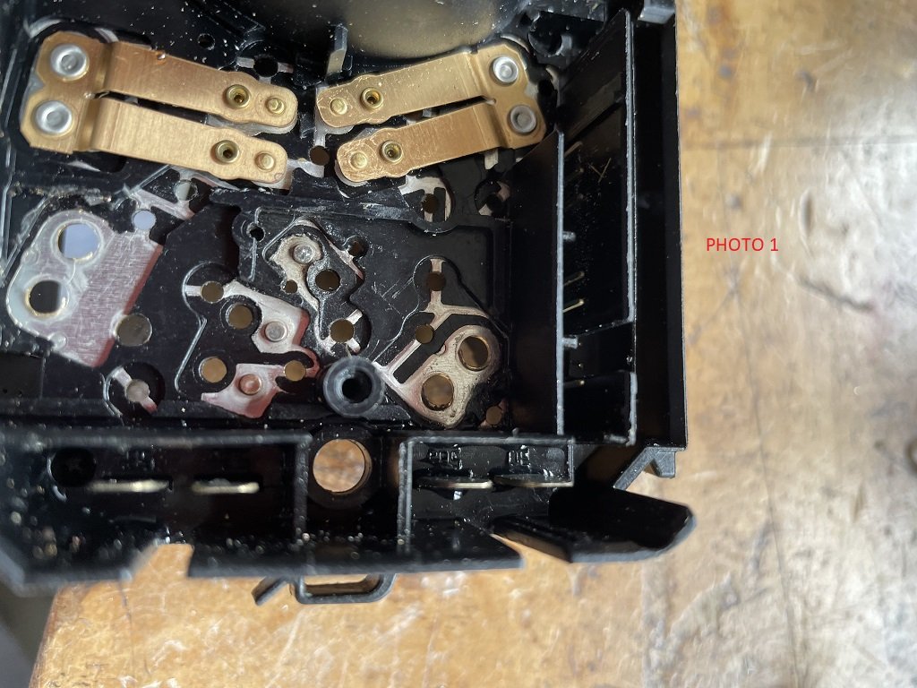

Photo 1: I used small forstner drill bit to remove the soft rivet to dismantle the leaf springs

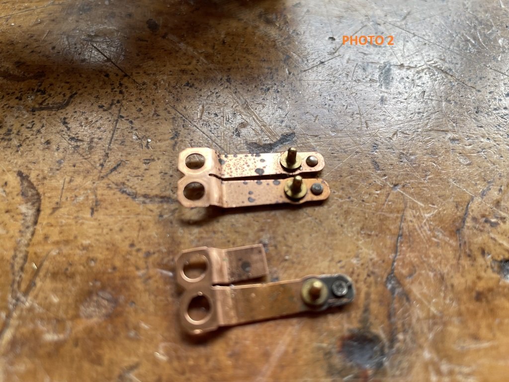

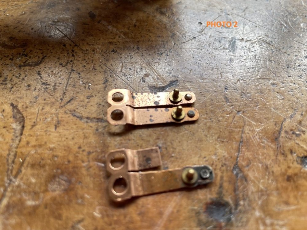

Photo 2: The spring leaf (30-56a) shows its charred tip. I have no way of knowing this as it is only visible facing down. I filed all contact points flat and shiny including the contacts on the body. I then polished all spring leaves as much as I can using fine sandpaper. I also restored the leaf strength by simply re-bending the elbows of these leaves.

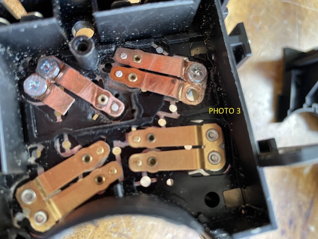

Photo 3: I fabricated 3mm nut and bolts. Only 3 are required. The fourth nut/bolt cannot be used in one of the holes as it will interfere with the indicator arm. You will notice an unfilled hole in this photo. I filed the nut heads thinner to same height as the elbow. Not too thin as you need a screwdriver to tighten these. You need to file these heads otherwise the backplate won't fit properly over. This took me a lot of time as the bolts/nuts are very fiddly to make.

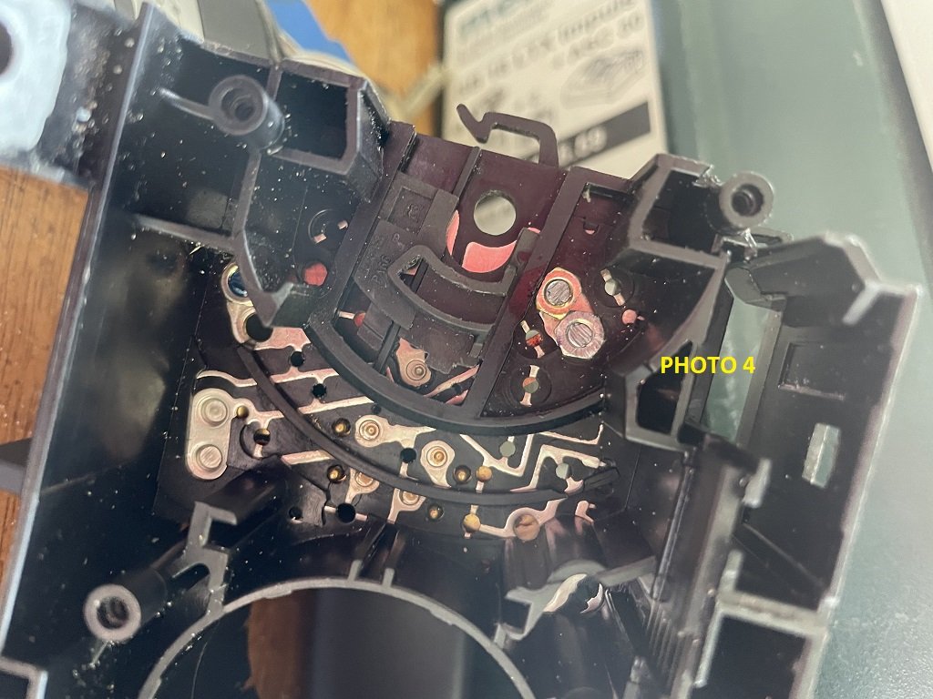

Photo 4: Shows the nuts.  I had to shape 2 nuts so that they won't interfere each other. I used blue lock thread.
