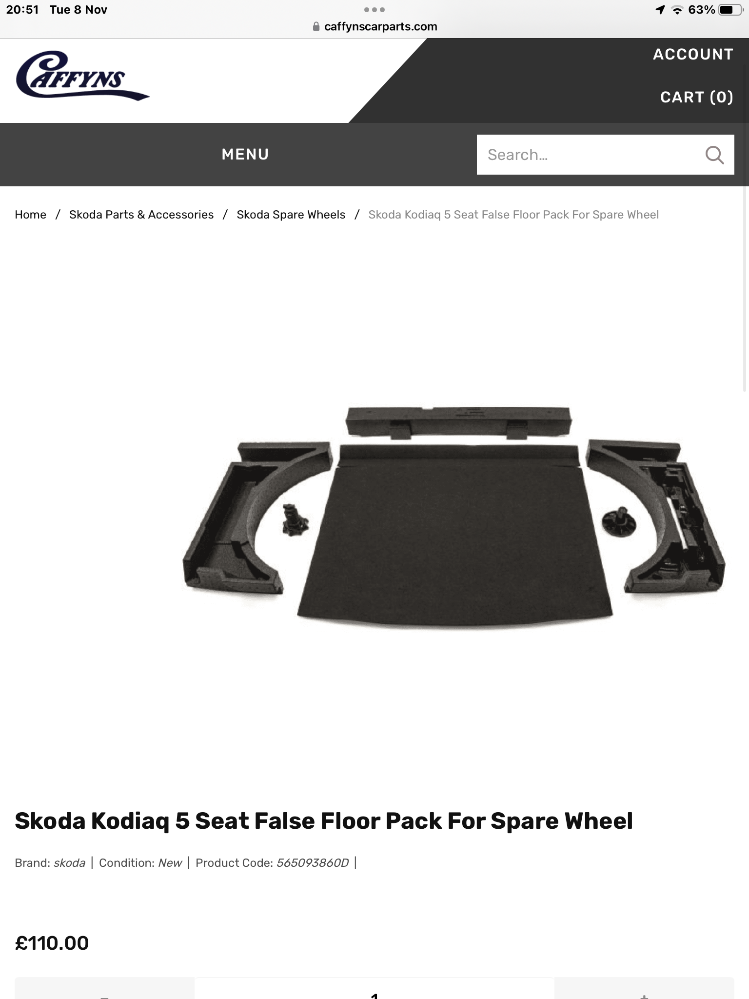

Kit for 5 seater is readily available..
Cheers, that's interesting, that never came up on any of my searches and the dealership up here didn't know of any such facility, Not sure looking at the picture but looks like it just raises it to the spare wheel level, I've brought mine up to be a level floor with the rear opening.
