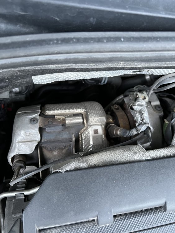

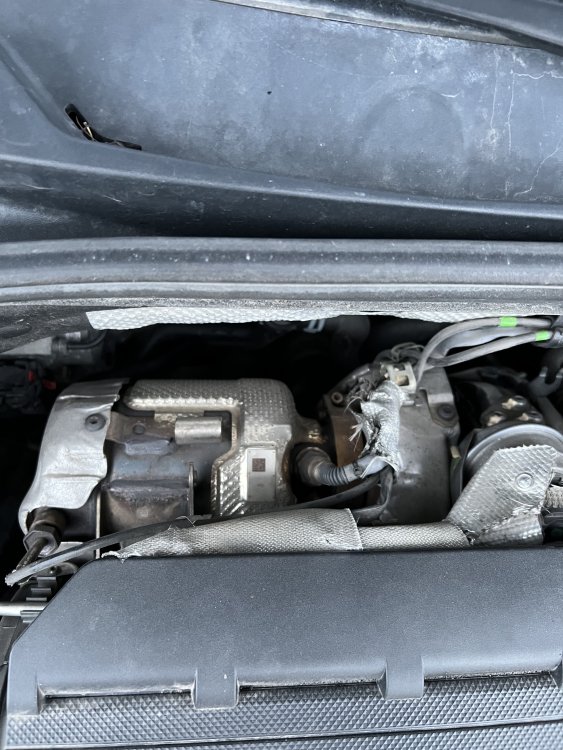

I decided to just remove the DPF and send it off to get it professionally cleaned. Will begin with that in the coming days. I haven’t had the car up on a lift yet since I bought it, and seen how things are located underneath. Do you know if it’s enough to lower the subframe to be able to get the DPF out, or do I have to completely drop the subframe altogether?
Not gonna lie, mine was cleaned in situ.  Chemical sprayed down the DPF pressure pipe.
Hopefully someone can let you know, odds are it can be squeezed out with a little moving of other parts.

I was tempted to try this as well, but it seems more like a band aid solution if anything, if my DPF is really that heavily clogged. I’m looking for a long term solution so I hopefully won’t have this issue again, since I very rarely drive short journeys unlike the previous owner.
Hopefully someone knows, otherwise I will update with the process.
