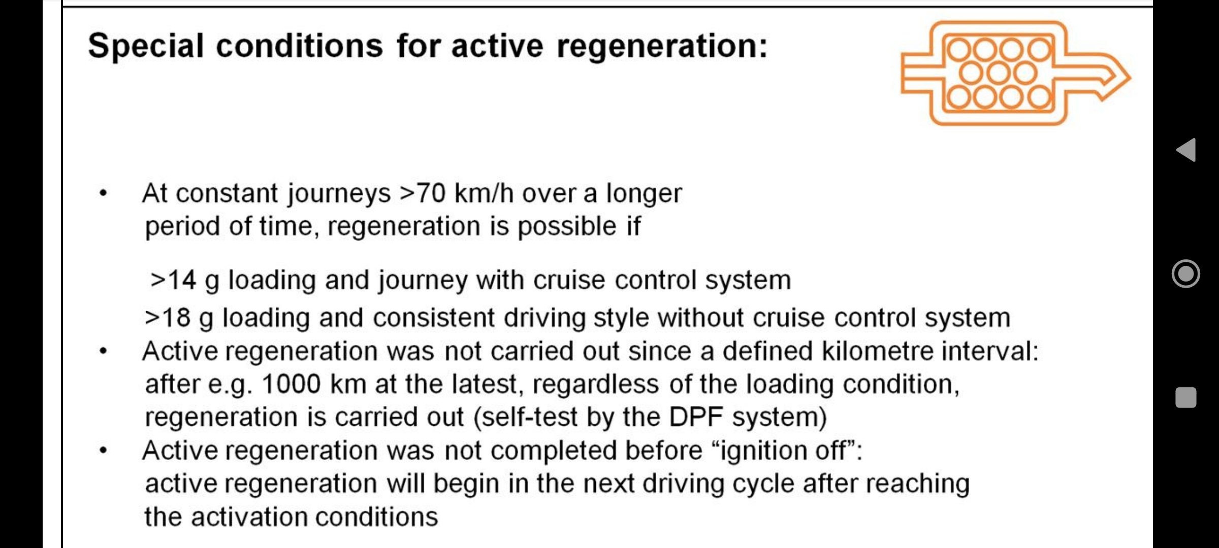

Here is the image for the 1,000km self-test that doesn't bother about measured values

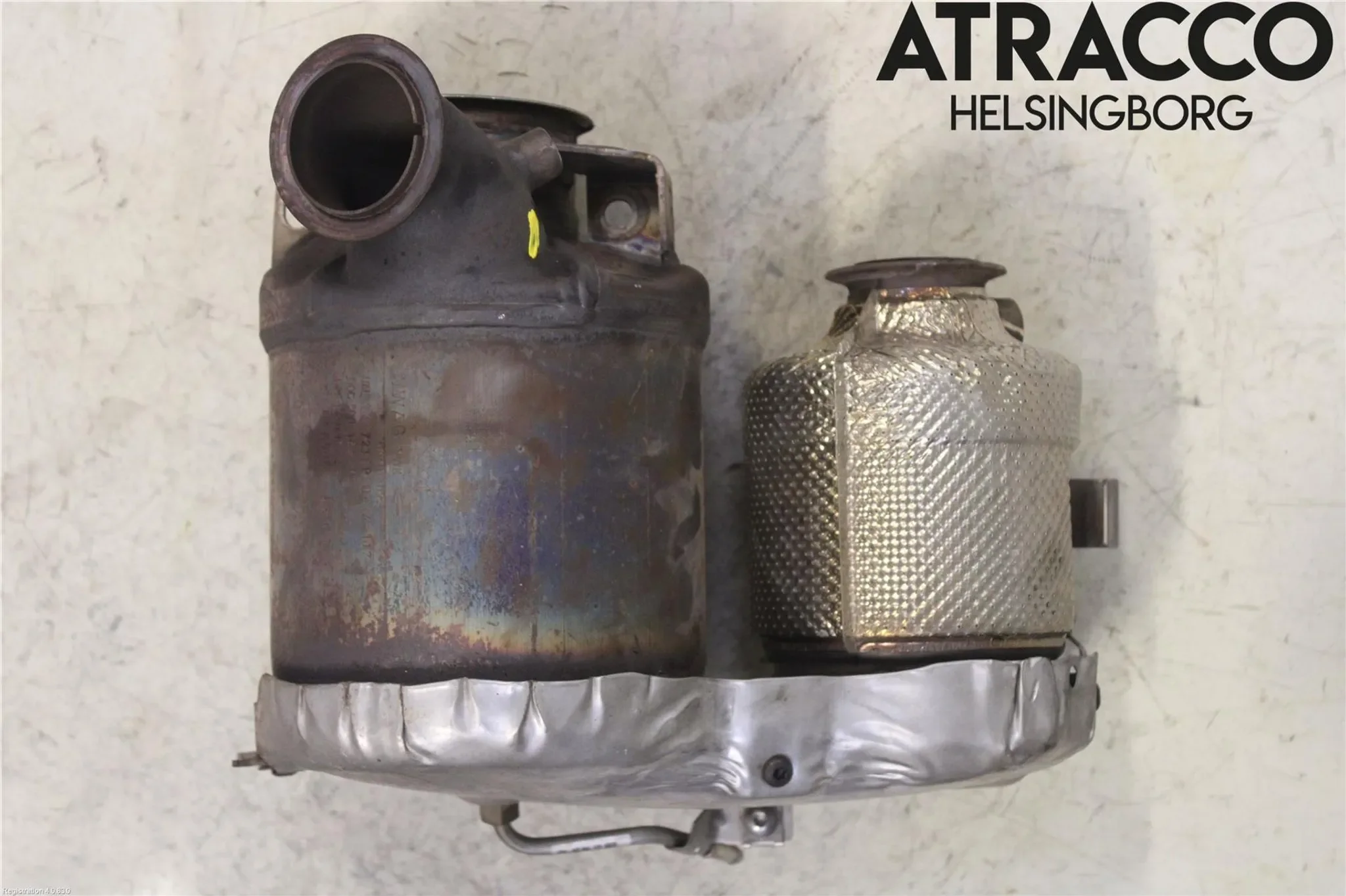

Do you know how the DPF is located on these cars? Is it difficult to get to, and is it welded in the exhaust or held on by clamps? I might just replace it and save myself some headache.
I don't know exactly where yours is located, odds are behind engine and not under the car.  I am 99% sure they are clamped on, but you may wish to check on prices as they will make your eyes water.

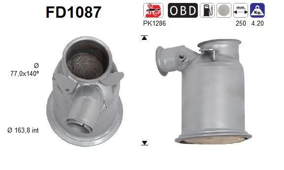

I found a brand new aftermarket one for $400. If not, I’ll just remove and clean it out myself or have it sent off to be professionally cleaned.

I’ll post two pictures. One is how the DPF looks like, and the other is the cheap aftermarket replacement. It seems there are two units, I don’t know what the other smaller one is, a dosing unit? No idea. The cheap replacement looks to be only the filter itself.

You could replace the DPF if that part is correct (price is very good if correct) and have trouble free motoring.
