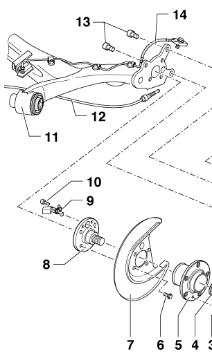

Fitting rear brake shields and I got out the rear rusted to hell rear bolts. I'm not putting these back in!
(Part #6 x 4 each side)
Are they M10 x 30 x 1.5 pitch High Tensile?

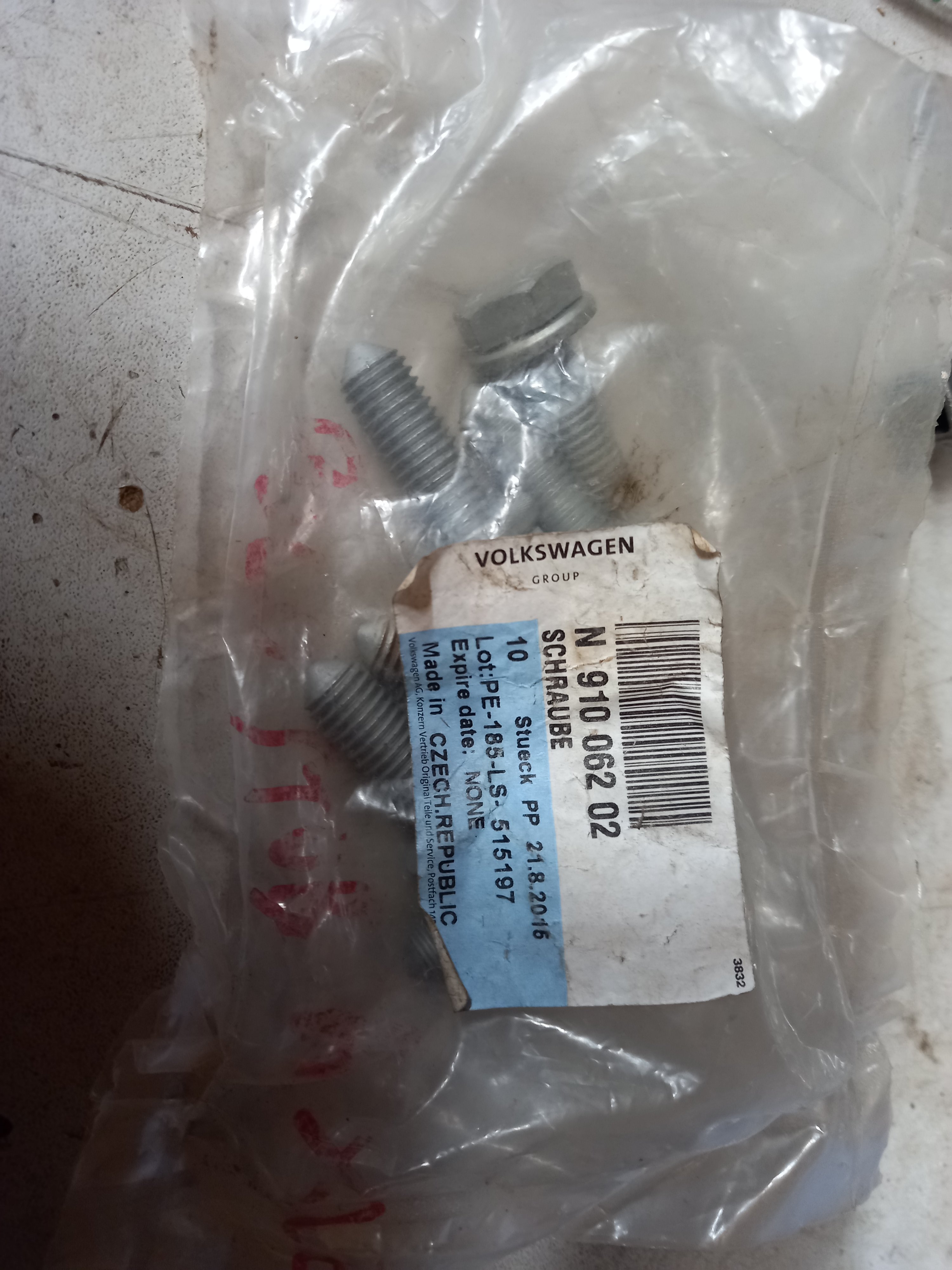

I have a bag with 6 in which confused me until I realised it was originally 10 and I've only used 4.
PM me if you'd like to make me an offer for em. Can't see me using them anytime soon.
Pitch confirmed at 1.5mm
