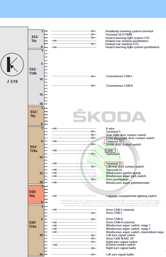

Yes, my problem is, something draining my battery from the comfort unit,
But i dont know what, because i dont know which plug is what.
So i need a shematic like sx1 is window motor, sx2 is wipers, etc

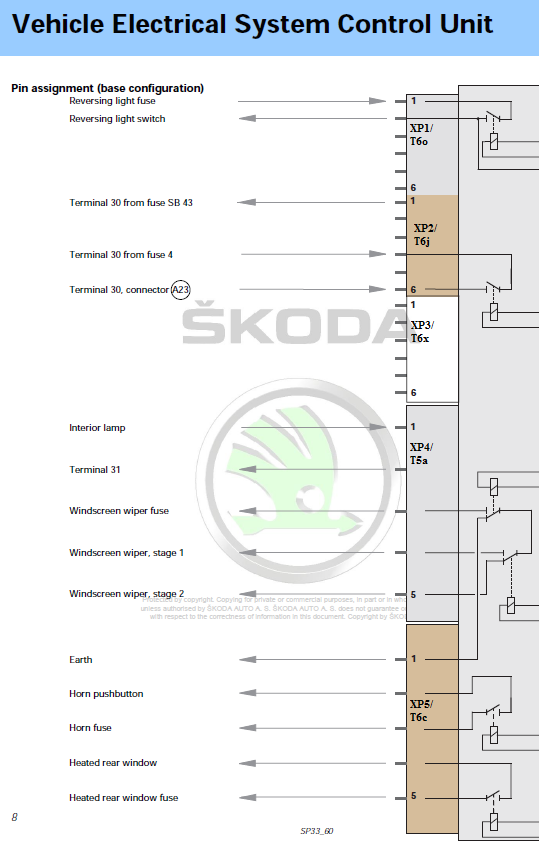

Ah OK, this is for Fabia mk1but will be very similar, I think:
Edited by Breezy_Pete
  • Sponsor
XP4 pin 2 is the main earth for the whole unit, so you will probably find that removing that connector removes all current use.
There is a fault that I've seen a few times where a surface mount capacitor on the circuitboard inside 'nukes itself' and causes current drain. Have you had a look inside?
  • Sponsor
Towards the top of image, near the narrower connector pin:

I checked one by one, and when the xs2 is pluged in, then the battery draining with 140ma.
But its a can bus wires, so i dont know what is draining my battery.

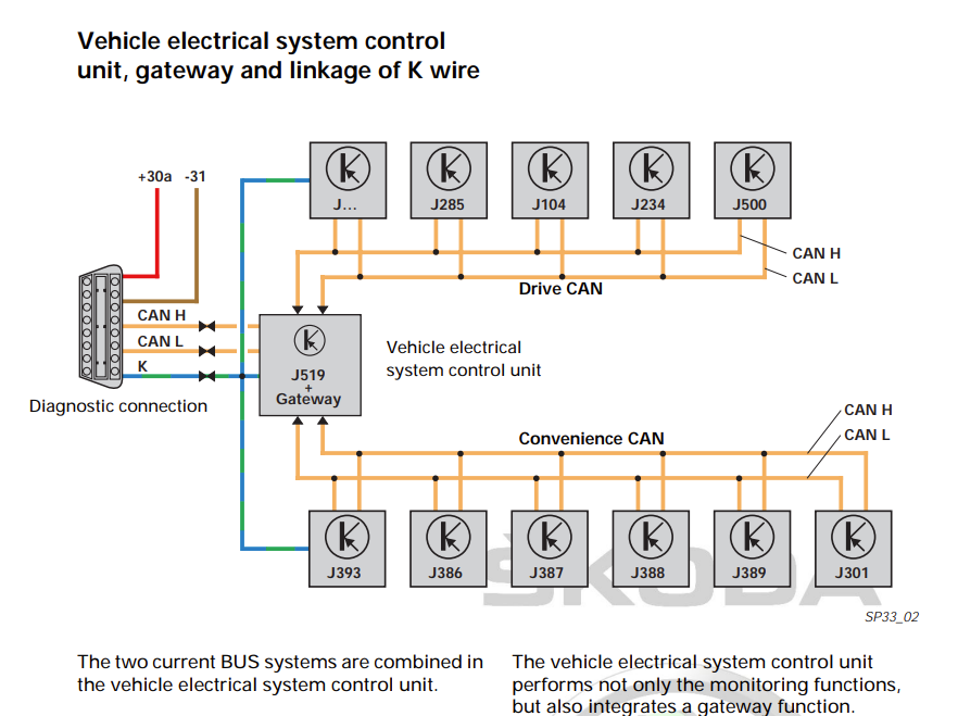

Again this diagram is related to mk1 fabia, but shows the items on the convenience (and drive) CAN bus.
J386-389 are window motor modules, and none of those will be on your convenience CAN bus, I believe, as you will have the newer LINbus only window motors on a 2006 car.
So that leaves J301 which is the HVAC module and J393 the Central Convenience Module (door locking etc.) I wonder if a broken wire in a door loom is making that last one stay awake when it should not be?  Not sure why the radio doesn't appear on either bus, I guess it should be on Convenience CAN. Airbag ECU (J104) not though, that's on drive bus. I think the Instrument cluster J285 also has wires from the convenience CNA bus, not shown on this diagram.
