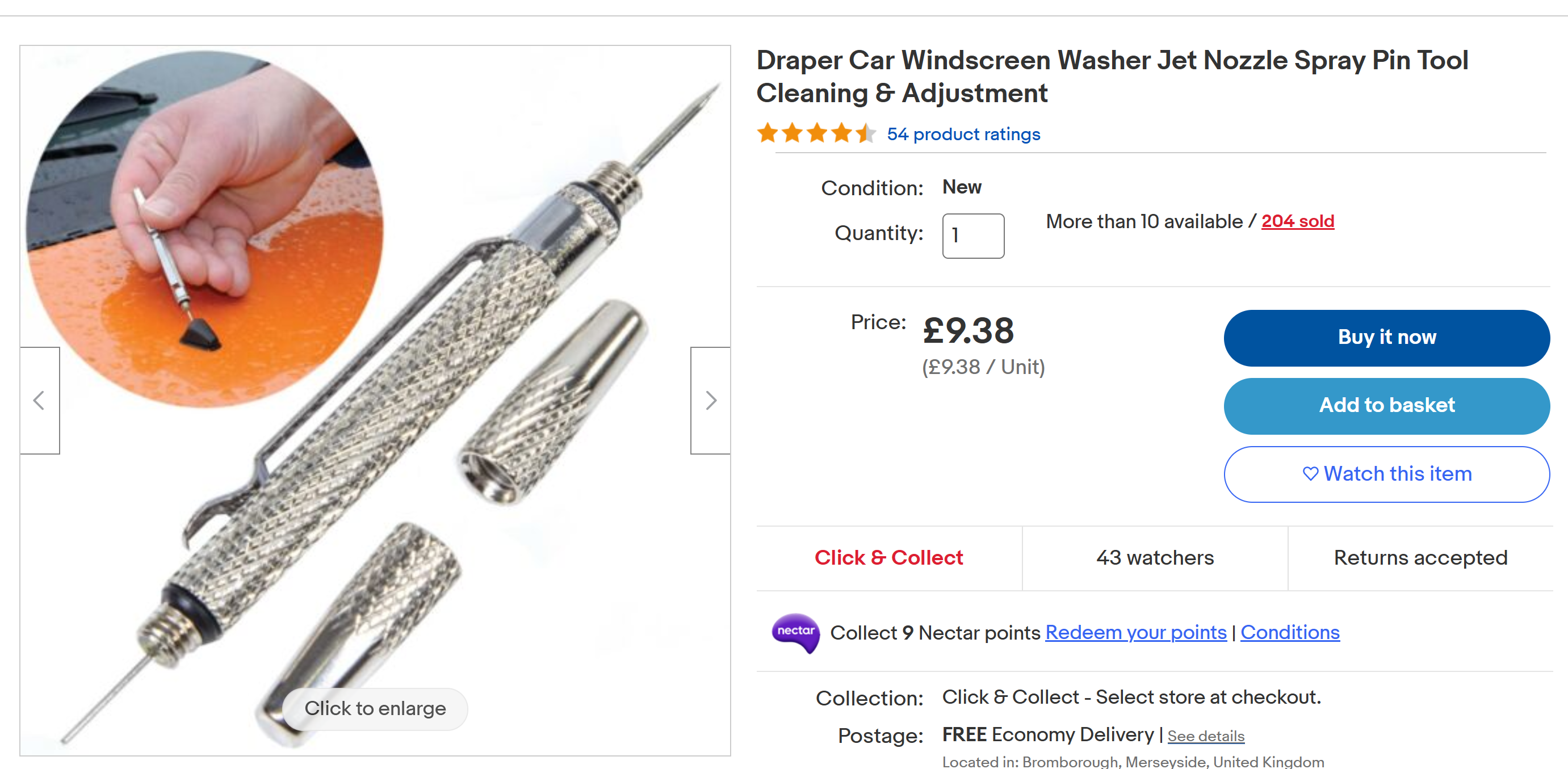

Years ago, washer jets we little metal balls in a mounting, with a hole drilled through them through which water squirted.
A bit like the ball on a ball-point pen.
To adjust them, you stuck a pin in the jet hole and this showed you where the jet was presently aligned, and allowed you to lever the ball in its mounting to a different position.
I don't know if they're fancier than that these days, but that was how we used to do it, back in the day.
Of course, you can go all fancy and get a tool to do it, but a pin works fine.
