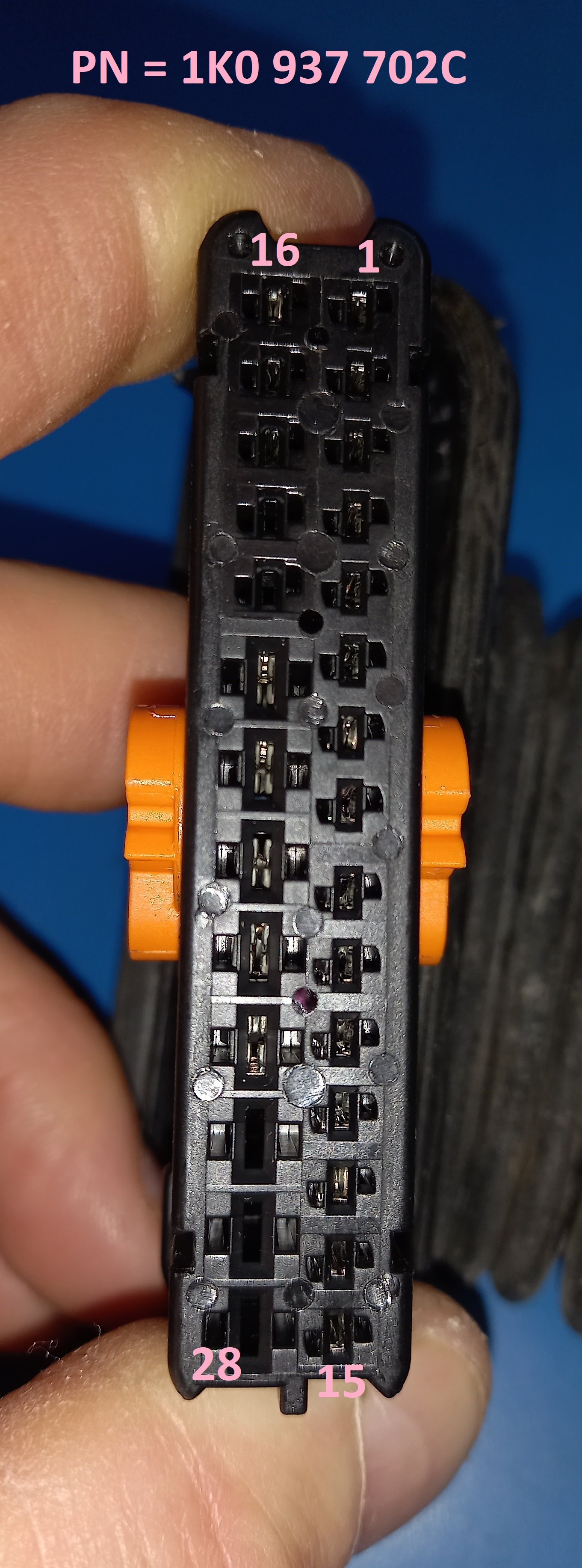

Goes to pin 3 of the a-pillar connector. This is how the numbering goes, looking at the mating face of the door loom plug:

Managed to get the boot a bit further back and found a broken wire, but it is purple with a yellow stripe and appears to go to pin 3 of the connector
  • Sponsor
That'll be the one.  The wiring diagrams are sometimes confusing with wire colours on LHD vs RHD mirrored things like door looms.
Pin number says it's the right wire.
  • Sponsor
Are you sure it isn't pin 2?
Re-reading your symptoms, the wire that's not working is one of the motor power wires which is purple/yellow, and comes from/goes to pin 2 of the connector.

Photos would help, if you can get that connector latch open for better view/access (be brave).

Yes, I did force the orange clip back. Seemed to be lots of locking and locking as I did so, presumably the connector making a breaking contact as I wobbled it.
No other obvious breaks. The purple/yellow wire has broken right next to the cloth tape binding the loom so soldering in a repair in situ would be nearly impossible. Is the best plan to take off the door card and take the whole loom out to repair it?
